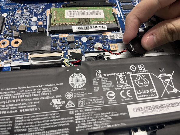

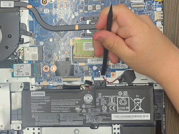

Use a plastic spudger or your fingernail to gently push the JST battery connector out of its socket.

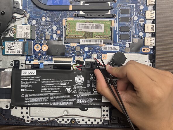

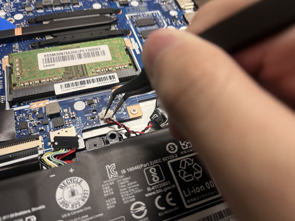

Using a spudger or tweezers, push the CMOS battery JST connector out of its socket.

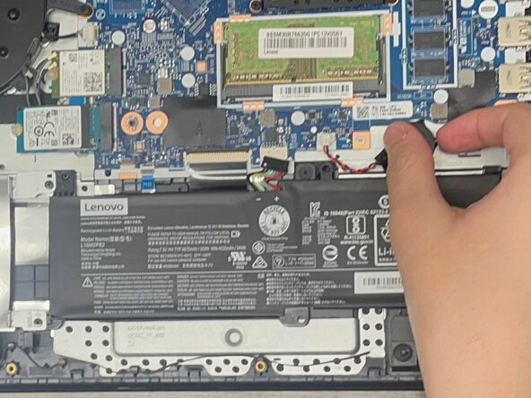

Grasp and remove the CMOS battery, which is secured with adhesive.
