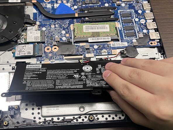

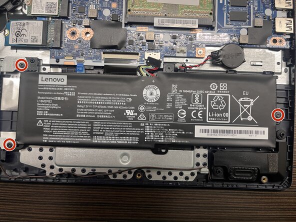

  4. Lenovo IdeaPad 3-15IML05 Battery Replacement, Battery: crwdns2935265:04crwdnd2935265:01crwdnd2935265:02crwdne2935265:0 Lenovo IdeaPad 3-15IML05 Battery Replacement, Battery: crwdns2935265:04crwdnd2935265:02crwdnd2935265:02crwdne2935265:0
    • Use a Phillips #00 screwdriver to remove the three 5 mm screws securing the battery.
    • To remove the battery, slide it to the right and lift it away from the hard drive cover.
    • If needed, you can lift the hard drive cover by removing the two 5 mm screws on the left.
