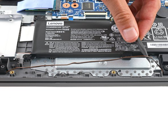

  10. Lenovo IdeaPad 3-15IIL05 Speakers Replacement, Disconnect the battery: crwdns2935265:010crwdnd2935265:01crwdnd2935265:03crwdne2935265:0 Lenovo IdeaPad 3-15IIL05 Speakers Replacement, Disconnect the battery: crwdns2935265:010crwdnd2935265:02crwdnd2935265:03crwdne2935265:0 Lenovo IdeaPad 3-15IIL05 Speakers Replacement, Disconnect the battery: crwdns2935265:010crwdnd2935265:03crwdnd2935265:03crwdne2935265:0
    • Use the flat end of a spudger to gently push the battery connector out of its socket on the motherboard.

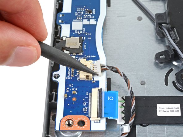

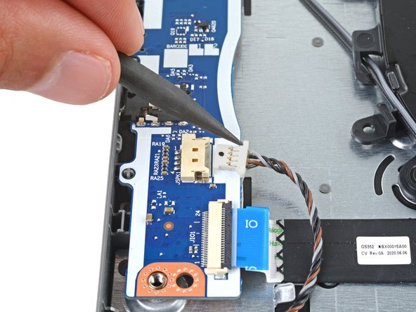

  11. Lenovo IdeaPad 3-15IIL05 Speakers Replacement, Disconnect the speakers: crwdns2935265:011crwdnd2935265:01crwdnd2935265:03crwdne2935265:0 Lenovo IdeaPad 3-15IIL05 Speakers Replacement, Disconnect the speakers: crwdns2935265:011crwdnd2935265:02crwdnd2935265:03crwdne2935265:0 Lenovo IdeaPad 3-15IIL05 Speakers Replacement, Disconnect the speakers: crwdns2935265:011crwdnd2935265:03crwdnd2935265:03crwdne2935265:0

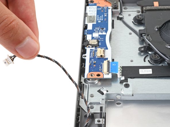

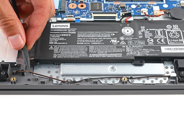

  12. Lenovo IdeaPad 3-15IIL05 Speakers Replacement, Reposition the speaker cables: crwdns2935265:012crwdnd2935265:01crwdnd2935265:03crwdne2935265:0 Lenovo IdeaPad 3-15IIL05 Speakers Replacement, Reposition the speaker cables: crwdns2935265:012crwdnd2935265:02crwdnd2935265:03crwdne2935265:0 Lenovo IdeaPad 3-15IIL05 Speakers Replacement, Reposition the speaker cables: crwdns2935265:012crwdnd2935265:03crwdnd2935265:03crwdne2935265:0
    • Guide the speaker wire out of the two metal clips securing it to the frame.

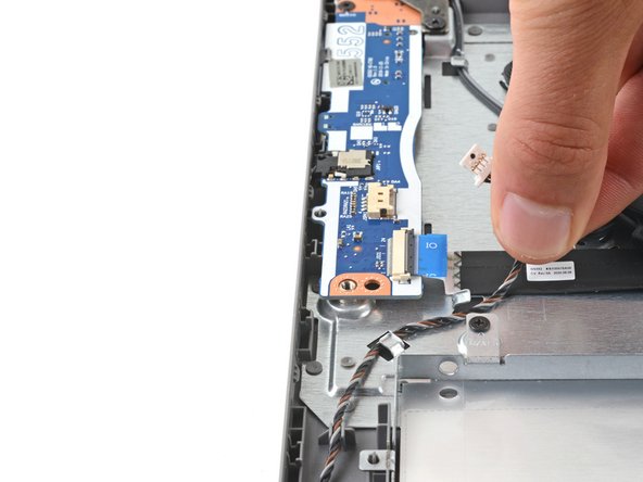

  13. Lenovo IdeaPad 3-15IIL05 Speakers Replacement: crwdns2935265:013crwdnd2935265:01crwdnd2935265:03crwdne2935265:0 Lenovo IdeaPad 3-15IIL05 Speakers Replacement: crwdns2935265:013crwdnd2935265:02crwdnd2935265:03crwdne2935265:0 Lenovo IdeaPad 3-15IIL05 Speakers Replacement: crwdns2935265:013crwdnd2935265:03crwdnd2935265:03crwdne2935265:0
    • Plastic clips along the bottom edge of the laptop secure the cable connecting the left and right speaker.
    • Use the point of a spudger to gently guide the cable out of the plastic clips.

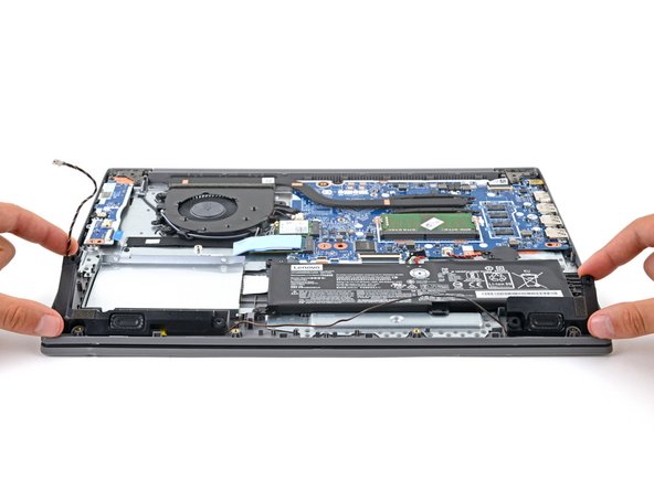

  14. Lenovo IdeaPad 3-15IIL05 Speakers Replacement, Remove the speakers: crwdns2935265:014crwdnd2935265:01crwdnd2935265:03crwdne2935265:0 Lenovo IdeaPad 3-15IIL05 Speakers Replacement, Remove the speakers: crwdns2935265:014crwdnd2935265:02crwdnd2935265:03crwdne2935265:0 Lenovo IdeaPad 3-15IIL05 Speakers Replacement, Remove the speakers: crwdns2935265:014crwdnd2935265:03crwdnd2935265:03crwdne2935265:0
    • Small rubber grommets secure the speakers to the frame.
    • Lift and remove the speakers.
    • During reassembly, align the speakers over their recesses and press them into place to secure them.
