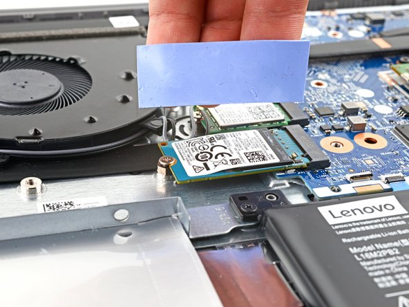

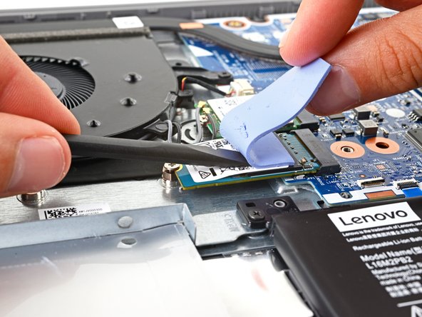

  11. Lenovo IdeaPad 3-15IIL05 SSD Replacement, Remove the thermal pad: crwdns2935265:011crwdnd2935265:01crwdnd2935265:03crwdne2935265:0 Lenovo IdeaPad 3-15IIL05 SSD Replacement, Remove the thermal pad: crwdns2935265:011crwdnd2935265:02crwdnd2935265:03crwdne2935265:0 Lenovo IdeaPad 3-15IIL05 SSD Replacement, Remove the thermal pad: crwdns2935265:011crwdnd2935265:03crwdnd2935265:03crwdne2935265:0
    • A delicate thermal pad covers the SSD. If you're planning on reusing it, be extra careful during this step.
    • Gently lift the left edge of the thermal pad.
    • Carefully slide the flat end of a spudger back and forth under the pad while slowly peeling the pad back.
    • Remove the thermal pad.
    • Set the thermal pad aside and apply it to the new SSD during reassembly.
    • If you tore the thermal pad when taking it off, don’t worry—you can still reuse it.
