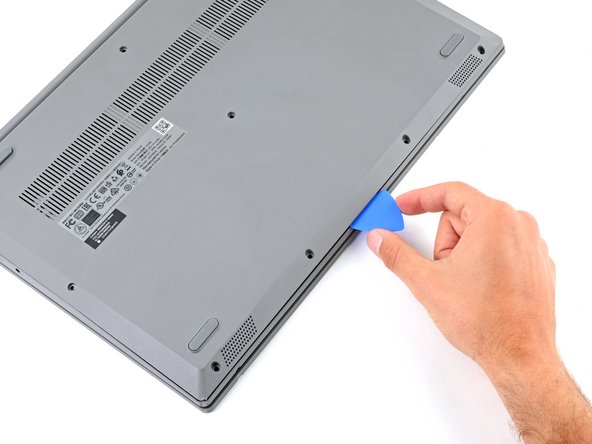

  3. Lenovo IdeaPad 3-15IIL05 RAM Replacement, Insert an opening pick: crwdns2935265:03crwdnd2935265:01crwdnd2935265:03crwdne2935265:0 Lenovo IdeaPad 3-15IIL05 RAM Replacement, Insert an opening pick: crwdns2935265:03crwdnd2935265:02crwdnd2935265:03crwdne2935265:0 Lenovo IdeaPad 3-15IIL05 RAM Replacement, Insert an opening pick: crwdns2935265:03crwdnd2935265:03crwdnd2935265:03crwdne2935265:0
    • Plastic clips secure the back cover to the frame. You'll hear and feel the clips release.
    • Insert the flat side of an opening pick between the top left corner of the back cover and frame.
    • Angle the pick down to about 45 degrees.

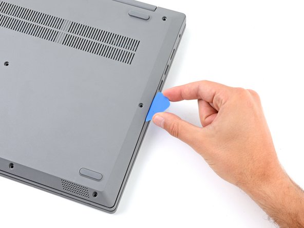

  4. Lenovo IdeaPad 3-15IIL05 RAM Replacement, Release the left clips: crwdns2935265:04crwdnd2935265:01crwdnd2935265:03crwdne2935265:0 Lenovo IdeaPad 3-15IIL05 RAM Replacement, Release the left clips: crwdns2935265:04crwdnd2935265:02crwdnd2935265:03crwdne2935265:0 Lenovo IdeaPad 3-15IIL05 RAM Replacement, Release the left clips: crwdns2935265:04crwdnd2935265:03crwdnd2935265:03crwdne2935265:0
    • Keep the opening pick angled down at about 45 degrees while sliding it along the front and side edges to help release the clips.
    • Slide the pick to the bottom left corner of the laptop to release the left clips.

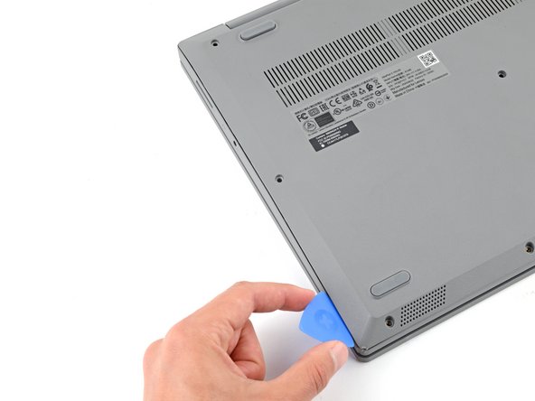

  5. Lenovo IdeaPad 3-15IIL05 RAM Replacement, Release the bottom clips: crwdns2935265:05crwdnd2935265:01crwdnd2935265:03crwdne2935265:0 Lenovo IdeaPad 3-15IIL05 RAM Replacement, Release the bottom clips: crwdns2935265:05crwdnd2935265:02crwdnd2935265:03crwdne2935265:0 Lenovo IdeaPad 3-15IIL05 RAM Replacement, Release the bottom clips: crwdns2935265:05crwdnd2935265:03crwdnd2935265:03crwdne2935265:0
    • Slide the opening pick to the bottom right corner to release the bottom clips.

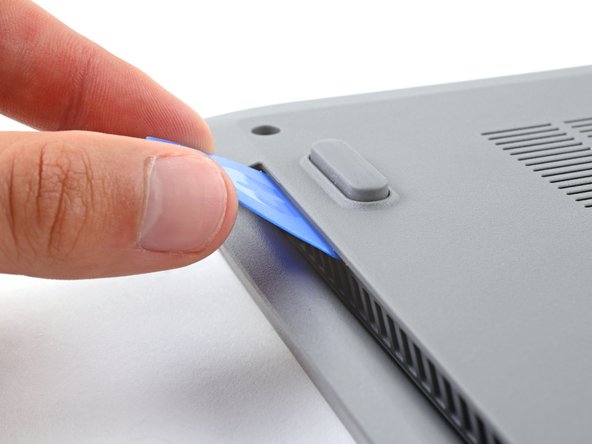

  6. Lenovo IdeaPad 3-15IIL05 RAM Replacement, Release the right clips: crwdns2935265:06crwdnd2935265:01crwdnd2935265:03crwdne2935265:0 Lenovo IdeaPad 3-15IIL05 RAM Replacement, Release the right clips: crwdns2935265:06crwdnd2935265:02crwdnd2935265:03crwdne2935265:0 Lenovo IdeaPad 3-15IIL05 RAM Replacement, Release the right clips: crwdns2935265:06crwdnd2935265:03crwdnd2935265:03crwdne2935265:0
    • Slide the opening pick to the top right corner to release the right clips.

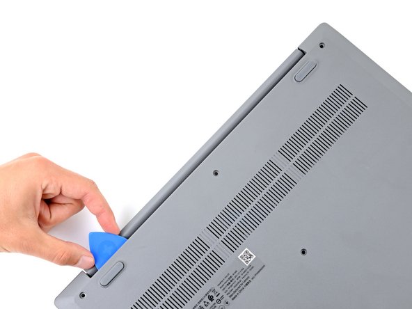

  7. Lenovo IdeaPad 3-15IIL05 RAM Replacement, Insert an opening pick: crwdns2935265:07crwdnd2935265:01crwdnd2935265:02crwdne2935265:0 Lenovo IdeaPad 3-15IIL05 RAM Replacement, Insert an opening pick: crwdns2935265:07crwdnd2935265:02crwdnd2935265:02crwdne2935265:0
    • Insert the flat end of an opening pick between the back cover and frame, to the left of the right hinge.
    • Pry the back cover up with the pick to release the top right clips.
    • Leave the pick inserted next to the right hinge.

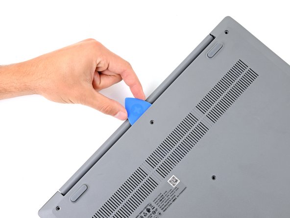

  8. Lenovo IdeaPad 3-15IIL05 RAM Replacement, Release the top clips: crwdns2935265:08crwdnd2935265:01crwdnd2935265:03crwdne2935265:0 Lenovo IdeaPad 3-15IIL05 RAM Replacement, Release the top clips: crwdns2935265:08crwdnd2935265:02crwdnd2935265:03crwdne2935265:0 Lenovo IdeaPad 3-15IIL05 RAM Replacement, Release the top clips: crwdns2935265:08crwdnd2935265:03crwdnd2935265:03crwdne2935265:0
    • Angle the pick up to about 45 degrees.
    • Slide the opening pick to the top left corner to release the remaining clips.

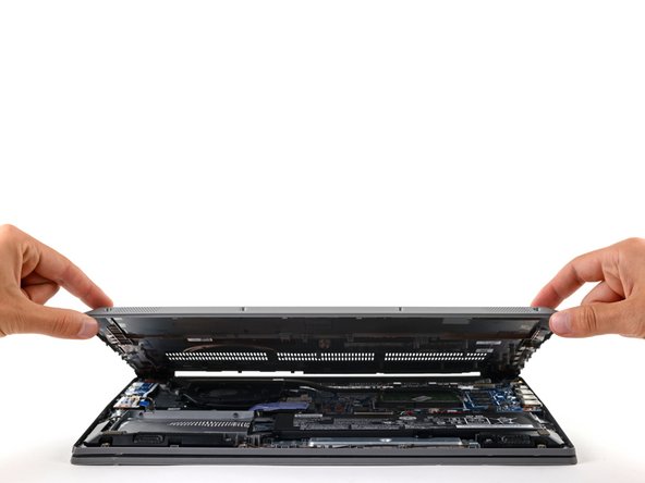

  9. Lenovo IdeaPad 3-15IIL05 RAM Replacement, Remove the back cover: crwdns2935265:09crwdnd2935265:01crwdnd2935265:03crwdne2935265:0 Lenovo IdeaPad 3-15IIL05 RAM Replacement, Remove the back cover: crwdns2935265:09crwdnd2935265:02crwdnd2935265:03crwdne2935265:0 Lenovo IdeaPad 3-15IIL05 RAM Replacement, Remove the back cover: crwdns2935265:09crwdnd2935265:03crwdnd2935265:03crwdne2935265:0
    • Remove the back cover.
    • During reassembly, lay the back cover on the frame and press firmly around the perimeter to engage all the clips.

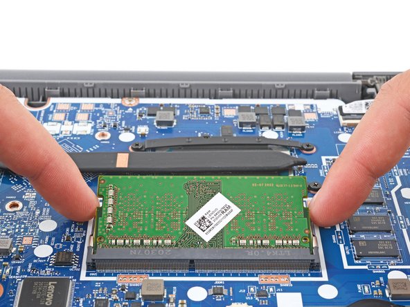

  11. Lenovo IdeaPad 3-15IIL05 RAM Replacement, Remove the RAM: crwdns2935265:011crwdnd2935265:01crwdnd2935265:03crwdne2935265:0 Lenovo IdeaPad 3-15IIL05 RAM Replacement, Remove the RAM: crwdns2935265:011crwdnd2935265:02crwdnd2935265:03crwdne2935265:0 Lenovo IdeaPad 3-15IIL05 RAM Replacement, Remove the RAM: crwdns2935265:011crwdnd2935265:03crwdnd2935265:03crwdne2935265:0
    • Two metal arms secure the stick of RAM.
    • Simultaneously push out the arms until they disengage and the stick pops up at a slight angle.
    • Remove the stick of RAM.
    • To install a stick of RAM, insert it into its socket at a slight downward angle and push down firmly until both metal arms lock the stick in place.
