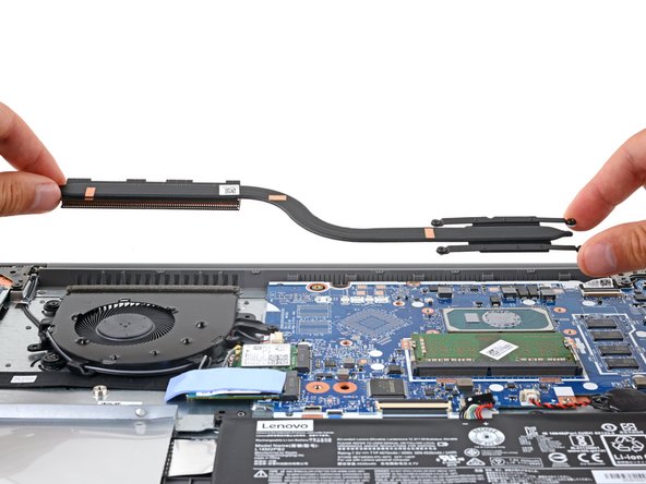

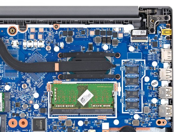

  11. Lenovo IdeaPad 3-15IIL05 Heatsink Replacement, Unfasten the heatsink: crwdns2935265:011crwdnd2935265:01crwdnd2935265:02crwdne2935265:0 Lenovo IdeaPad 3-15IIL05 Heatsink Replacement, Unfasten the heatsink: crwdns2935265:011crwdnd2935265:02crwdnd2935265:02crwdne2935265:0
    • Use a Phillips screwdriver to loosen the four captive screws securing the heatsink.
    • During reassembly, tighten the heatsink screws in an "X" pattern. For example: top left, bottom right, top right, bottom left.
  12. Lenovo IdeaPad 3-15IIL05 Heatsink Replacement, Remove the heatsink: crwdns2935265:012crwdnd2935265:01crwdnd2935265:02crwdne2935265:0 Lenovo IdeaPad 3-15IIL05 Heatsink Replacement, Remove the heatsink: crwdns2935265:012crwdnd2935265:02crwdnd2935265:02crwdne2935265:0
    • Remove the heatsink.
    • You may feel slight resistance when removing the heatsink, as thermal paste bonds it to the CPU.

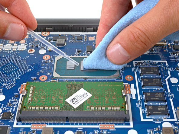

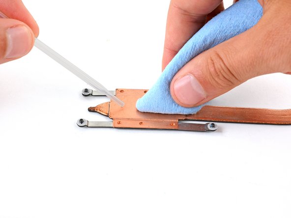

  13. Lenovo IdeaPad 3-15IIL05 Heatsink Replacement, Reassembly information: crwdns2935265:013crwdnd2935265:01crwdnd2935265:03crwdne2935265:0 Lenovo IdeaPad 3-15IIL05 Heatsink Replacement, Reassembly information: crwdns2935265:013crwdnd2935265:02crwdnd2935265:03crwdne2935265:0 Lenovo IdeaPad 3-15IIL05 Heatsink Replacement, Reassembly information: crwdns2935265:013crwdnd2935265:03crwdnd2935265:03crwdne2935265:0
    • Before installing a new heatsink, follow this guide to clean the CPU and reapply thermal paste.
    • If you're just reapplying thermal paste and not replacing the heatsink, clean the bottom of the heatsink as well.
