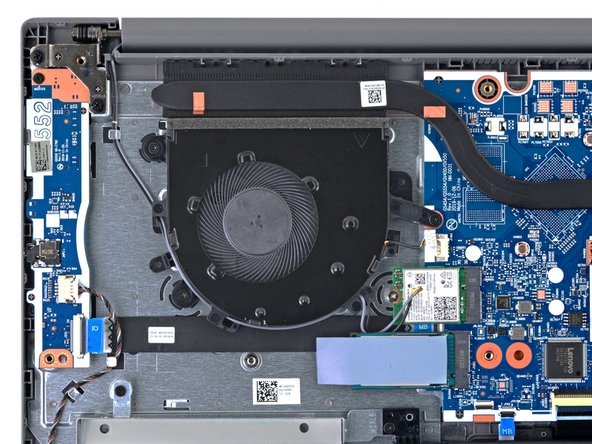

  10. Lenovo IdeaPad 3-15IIL05 Fan Replacement, Disconnect the battery: crwdns2935265:010crwdnd2935265:01crwdnd2935265:03crwdne2935265:0 Lenovo IdeaPad 3-15IIL05 Fan Replacement, Disconnect the battery: crwdns2935265:010crwdnd2935265:02crwdnd2935265:03crwdne2935265:0 Lenovo IdeaPad 3-15IIL05 Fan Replacement, Disconnect the battery: crwdns2935265:010crwdnd2935265:03crwdnd2935265:03crwdne2935265:0
    • Use the flat end of a spudger to gently push the battery connector out of its socket on the motherboard.

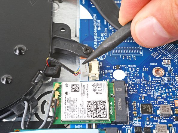

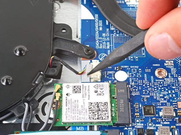

  11. Lenovo IdeaPad 3-15IIL05 Fan Replacement, Disconnect the fan: crwdns2935265:011crwdnd2935265:01crwdnd2935265:03crwdne2935265:0 Lenovo IdeaPad 3-15IIL05 Fan Replacement, Disconnect the fan: crwdns2935265:011crwdnd2935265:02crwdnd2935265:03crwdne2935265:0 Lenovo IdeaPad 3-15IIL05 Fan Replacement, Disconnect the fan: crwdns2935265:011crwdnd2935265:03crwdnd2935265:03crwdne2935265:0
    • Push on alternating sides of the fan cable connector with a spudger to "walk" it out of its socket.

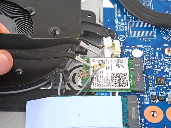

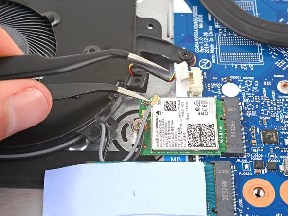

  12. Lenovo IdeaPad 3-15IIL05 Fan Replacement, Disconnect the antenna cables: crwdns2935265:012crwdnd2935265:01crwdnd2935265:03crwdne2935265:0 Lenovo IdeaPad 3-15IIL05 Fan Replacement, Disconnect the antenna cables: crwdns2935265:012crwdnd2935265:02crwdnd2935265:03crwdne2935265:0 Lenovo IdeaPad 3-15IIL05 Fan Replacement, Disconnect the antenna cables: crwdns2935265:012crwdnd2935265:03crwdnd2935265:03crwdne2935265:0
    $3.99
    • Slide one arm of your angled tweezers under the head of the gray antenna cable connected to the WLAN card.
    • Gently lift straight up to disconnect the cable.
    • Repeat the same process to disconnect the black antenna cable.
    • To reattach antenna connectors like these, align the connector over its socket and press down with the flat end of a spudger. The connector should snap into place. This can be tricky and may take a few tries.

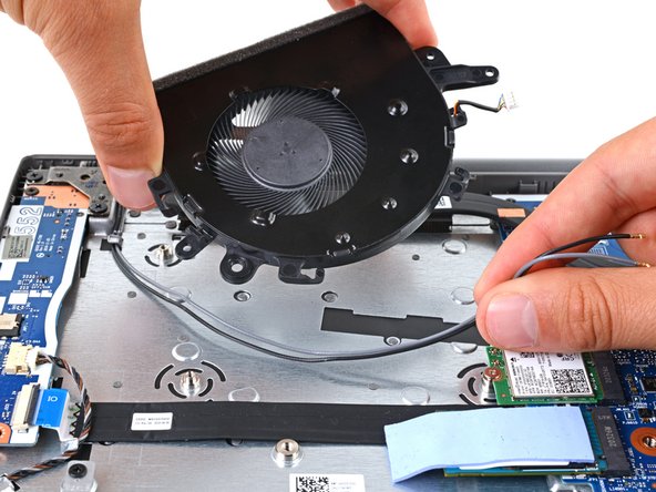

  13. Lenovo IdeaPad 3-15IIL05 Fan Replacement, Unfasten the fan: crwdns2935265:013crwdnd2935265:01crwdnd2935265:02crwdne2935265:0 Lenovo IdeaPad 3-15IIL05 Fan Replacement, Unfasten the fan: crwdns2935265:013crwdnd2935265:02crwdnd2935265:02crwdne2935265:0
    • Use a Phillips screwdriver to remove the three screws securing the fan:
    • Two 4.4 mm-long screws
    • One 5.6 mm-long screw
    • Before installing the screws during reassembly, make sure the black and gray antenna cables aren't under the fan.

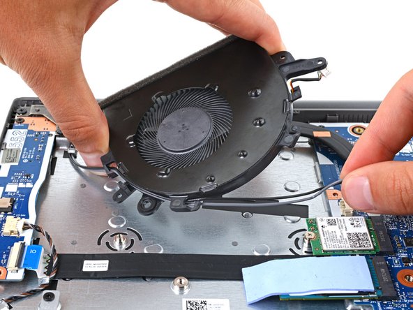

  14. Lenovo IdeaPad 3-15IIL05 Fan Replacement, Remove the fan: crwdns2935265:014crwdnd2935265:01crwdnd2935265:03crwdne2935265:0 Lenovo IdeaPad 3-15IIL05 Fan Replacement, Remove the fan: crwdns2935265:014crwdnd2935265:02crwdnd2935265:03crwdne2935265:0 Lenovo IdeaPad 3-15IIL05 Fan Replacement, Remove the fan: crwdns2935265:014crwdnd2935265:03crwdnd2935265:03crwdne2935265:0
Check your repair by running hardware tests with Lenovo Diagnostics.
