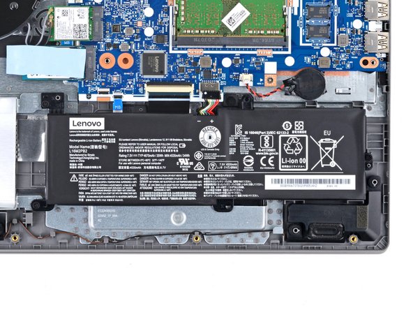

  10. Lenovo IdeaPad 3-15IIL05 Battery Replacement, Disconnect the battery: crwdns2935265:010crwdnd2935265:01crwdnd2935265:03crwdne2935265:0 Lenovo IdeaPad 3-15IIL05 Battery Replacement, Disconnect the battery: crwdns2935265:010crwdnd2935265:02crwdnd2935265:03crwdne2935265:0 Lenovo IdeaPad 3-15IIL05 Battery Replacement, Disconnect the battery: crwdns2935265:010crwdnd2935265:03crwdnd2935265:03crwdne2935265:0
    • Use the flat end of a spudger to gently push the battery connector out of its socket on the motherboard.
  11. Lenovo IdeaPad 3-15IIL05 Battery Replacement, Unfasten the battery: crwdns2935265:011crwdnd2935265:01crwdnd2935265:02crwdne2935265:0 Lenovo IdeaPad 3-15IIL05 Battery Replacement, Unfasten the battery: crwdns2935265:011crwdnd2935265:02crwdnd2935265:02crwdne2935265:0
    • Use a Phillips screwdriver to remove the three 5.7 mm-long screws securing the battery.

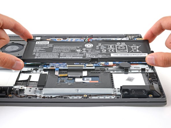

  12. Lenovo IdeaPad 3-15IIL05 Battery Replacement, Remove the battery: crwdns2935265:012crwdnd2935265:01crwdnd2935265:02crwdne2935265:0 Lenovo IdeaPad 3-15IIL05 Battery Replacement, Remove the battery: crwdns2935265:012crwdnd2935265:02crwdnd2935265:02crwdne2935265:0
    • Remove the battery.
For optimal performance, calibrate your newly installed battery after completing this guide.
