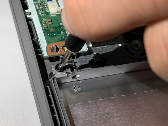

  4. Lenovo IdeaPad 3-1481W000NGUS Speakers Replacement: crwdns2935265:04crwdnd2935265:01crwdnd2935265:02crwdne2935265:0 Lenovo IdeaPad 3-1481W000NGUS Speakers Replacement: crwdns2935265:04crwdnd2935265:02crwdnd2935265:02crwdne2935265:0
    • Remove the four 2 mm screws on the HDD bracket using a Phillips #00 screwdriver.
