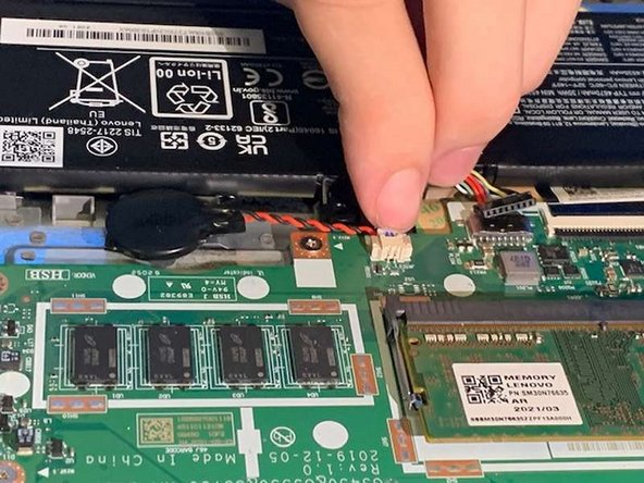

  3. Lenovo IdeaPad 3-1481W000NGUS Motherboard Replacement, Battery: crwdns2935265:03crwdnd2935265:01crwdnd2935265:03crwdne2935265:0 Lenovo IdeaPad 3-1481W000NGUS Motherboard Replacement, Battery: crwdns2935265:03crwdnd2935265:02crwdnd2935265:03crwdne2935265:0 Lenovo IdeaPad 3-1481W000NGUS Motherboard Replacement, Battery: crwdns2935265:03crwdnd2935265:03crwdnd2935265:03crwdne2935265:0
    • Remove the three 4 mm screws connected to the battery pack using a Phillips #000 screwdriver.
    • Disconnect the battery cable from the motherboard.
    • Gently lift up the battery pack by hand to remove it.
    • Be sure to avoid pulling the plug cable.

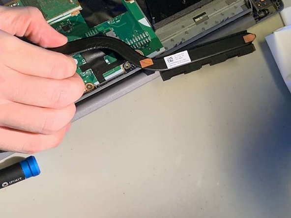

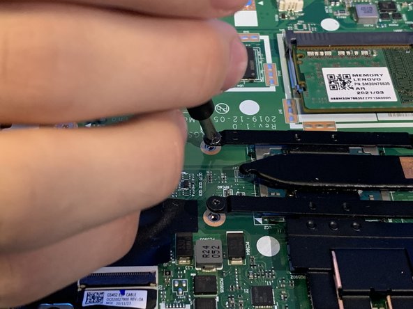

  17. Lenovo IdeaPad 3-1481W000NGUS Motherboard Replacement, Heat Sink: crwdns2935265:017crwdnd2935265:01crwdnd2935265:03crwdne2935265:0 Lenovo IdeaPad 3-1481W000NGUS Motherboard Replacement, Heat Sink: crwdns2935265:017crwdnd2935265:02crwdnd2935265:03crwdne2935265:0 Lenovo IdeaPad 3-1481W000NGUS Motherboard Replacement, Heat Sink: crwdns2935265:017crwdnd2935265:03crwdnd2935265:03crwdne2935265:0
    • Remove the four 3 mm Phillips screws that secure the heat sink.
    • Gently lift the heat sink up and out.
    • Reapply thermal paste before installing a new heatsink.

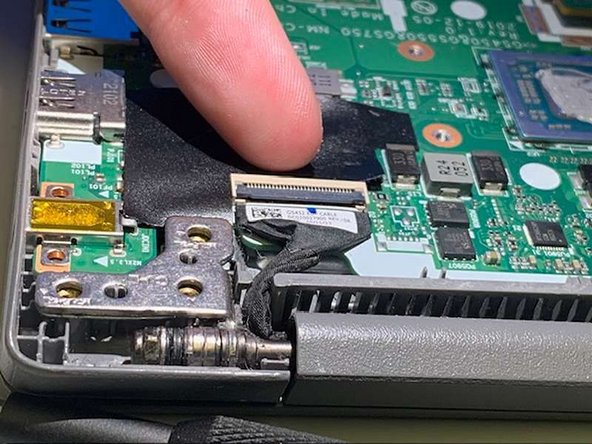

  18. Lenovo IdeaPad 3-1481W000NGUS Motherboard Replacement, Motherboard: crwdns2935265:018crwdnd2935265:01crwdnd2935265:03crwdne2935265:0 Lenovo IdeaPad 3-1481W000NGUS Motherboard Replacement, Motherboard: crwdns2935265:018crwdnd2935265:02crwdnd2935265:03crwdne2935265:0 Lenovo IdeaPad 3-1481W000NGUS Motherboard Replacement, Motherboard: crwdns2935265:018crwdnd2935265:03crwdnd2935265:03crwdne2935265:0
    • Lift the black ZIF locking flap and disconnect the display connector.
    • Use your fingernails to gently "walk" the white CMOS battery connector out of its motherboard socket.

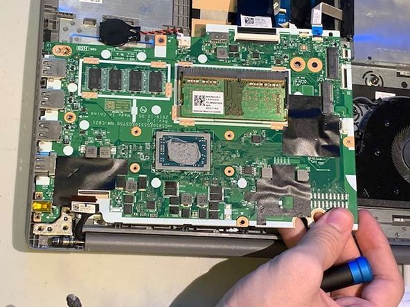

  19. Lenovo IdeaPad 3-1481W000NGUS Motherboard Replacement: crwdns2935265:019crwdnd2935265:01crwdnd2935265:03crwdne2935265:0 Lenovo IdeaPad 3-1481W000NGUS Motherboard Replacement: crwdns2935265:019crwdnd2935265:02crwdnd2935265:03crwdne2935265:0 Lenovo IdeaPad 3-1481W000NGUS Motherboard Replacement: crwdns2935265:019crwdnd2935265:03crwdnd2935265:03crwdne2935265:0
    • Remove the seven 4 mm Phillips #00 screws securing the motherboard to the chassis.
    • Lift one corner gently. Check for any remaining connected cables, and carefully remove the motherboard out of the case.
