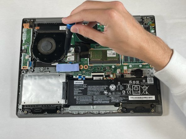

    • Orient the laptop so that the bottom is facing up.
    • Remove the six 7 mm screws using a Phillips #00 screwdriver.
    • Remove the four 4 mm screws using a Phillips #00 screwdriver.

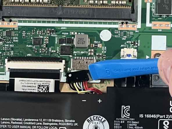

  3. Lenovo IdeaPad 3-1481W000NGUS Fan Replacement, Wi-Fi Card: crwdns2935265:03crwdnd2935265:01crwdnd2935265:02crwdne2935265:0 Lenovo IdeaPad 3-1481W000NGUS Fan Replacement, Wi-Fi Card: crwdns2935265:03crwdnd2935265:02crwdnd2935265:02crwdne2935265:0

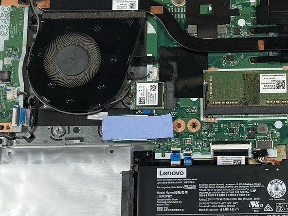

    • Use your fingernail or an opening tool to gently pull out and disconnect the battery pack cable.
    • Do not pull on the cables.

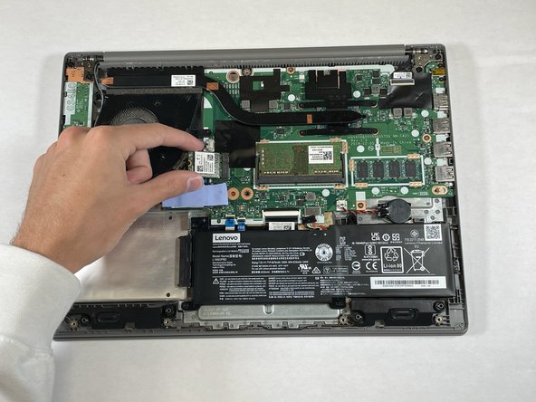

  4. Lenovo IdeaPad 3-1481W000NGUS Fan Replacement: crwdns2935265:04crwdnd2935265:01crwdnd2935265:02crwdne2935265:0 Lenovo IdeaPad 3-1481W000NGUS Fan Replacement: crwdns2935265:04crwdnd2935265:02crwdnd2935265:02crwdne2935265:0

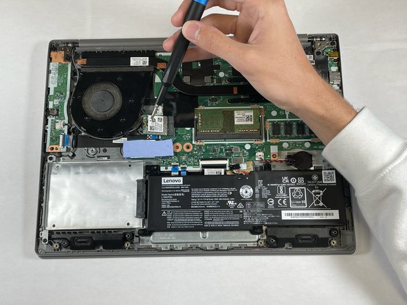

    • Use the spudger to remove each cable from the Wi-Fi card, one cable at a time.
    • The cables do not need much force to be removed.

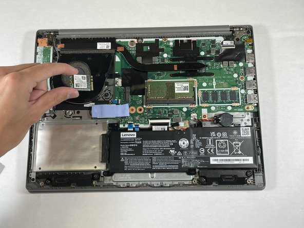

    • Pull the card away from the housing capsule on the right side of the Wi-Fi card to remove it from the laptop.
    • Make sure no cables are still connected or wrapped around the Wi-Fi card when removing.

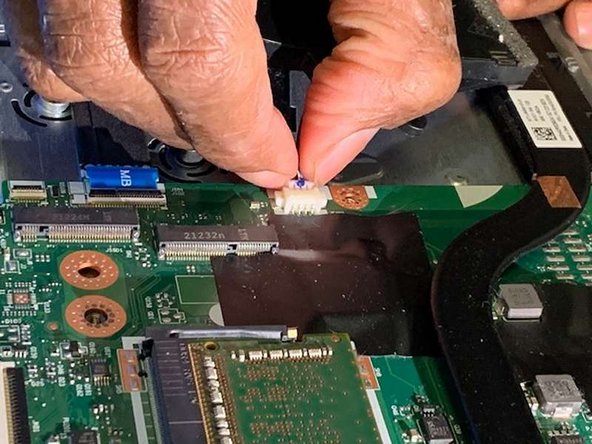

    • Use your fingernails to gently "walk" the fan connector out of its motherboard socket.
    • Be gentle while unplugging the connector. Using too much force may damage the computer.

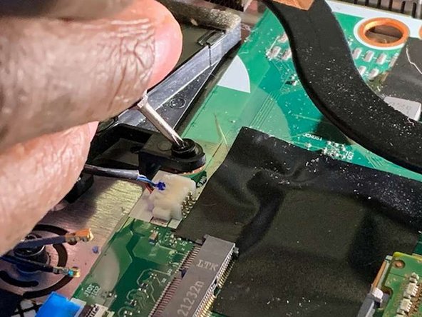

    • Remove the three 5.5 mm screws that secure the fan with the Phillips #0 screwdriver.
