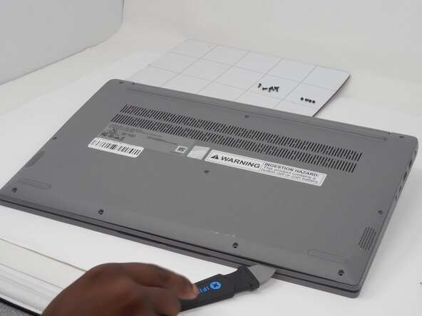

    • Unscrew and remove the T5 Torx screws that secure the lower case:
    • Six 6.5 mm screws
    • Four 5 mm screws
    • Insert a Jimmy into the seam between the lower case and chassis.
    • Pry around the entire perimeter until the lower case fully releases.
    • Remove the lower case.

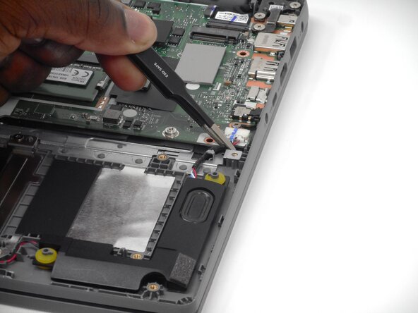

    • Use tweezers or your fingernails to gently "walk" the battery connector directly out of its motherboard socket.

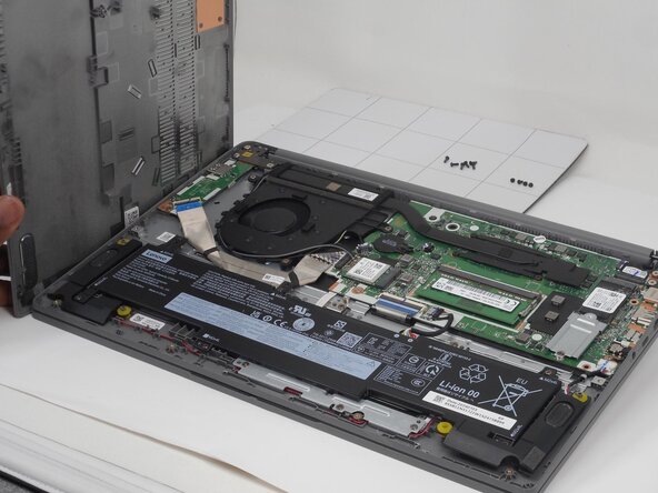

    • Unscrew the six 5 mm Phillips #000 screws that secure the battery.
    • Lift the battery up and out to remove it.

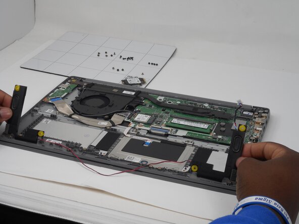

    • Remove the three 3 mm Phillips screws that secure the trackpad bracket to the chassis.
    • Remove the bracket.
    • Disconnect the speaker connection from its motherboard socket.
    • Carefully lift the speakers up and out to remove them.
