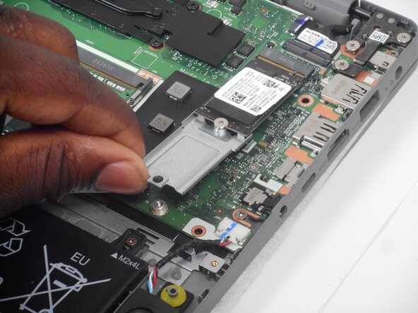

  3. Lenovo IdeaPad 1-15ALC7 Solid State Drive (SSD) Replacement, Solid State Drive (SSD): crwdns2935265:03crwdnd2935265:01crwdnd2935265:03crwdne2935265:0 Lenovo IdeaPad 1-15ALC7 Solid State Drive (SSD) Replacement, Solid State Drive (SSD): crwdns2935265:03crwdnd2935265:02crwdnd2935265:03crwdne2935265:0 Lenovo IdeaPad 1-15ALC7 Solid State Drive (SSD) Replacement, Solid State Drive (SSD): crwdns2935265:03crwdnd2935265:03crwdnd2935265:03crwdne2935265:0
    • Remove the single 3 mm screw securing the SSD to the motherboard.
    • Gently grasp the edge of the SSD and lift it slightly at an angle (about 20-30 degrees).
    • Carefully pull the SSD straight out of the M.2 slot, sliding it away from the connector to fully disconnect it.

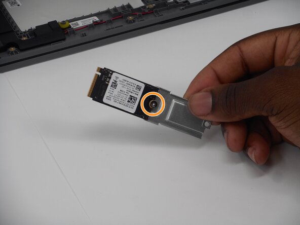

    • Unscrew the second 3 mm screw that attaches the SSD to the bracket and remove the SSD from the bracket.
