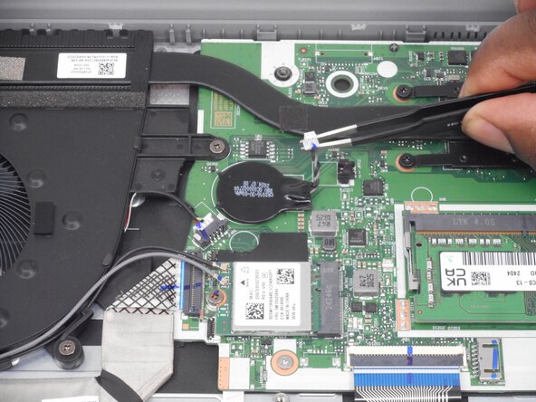

    • Use tweezers or your fingernails to gently "walk" the battery connector directly out of its motherboard socket.
  3. Lenovo IdeaPad 1-15ALC7 CMOS Battery Replacement, CMOS Battery: crwdns2935265:03crwdnd2935265:01crwdnd2935265:03crwdne2935265:0 Lenovo IdeaPad 1-15ALC7 CMOS Battery Replacement, CMOS Battery: crwdns2935265:03crwdnd2935265:02crwdnd2935265:03crwdne2935265:0 Lenovo IdeaPad 1-15ALC7 CMOS Battery Replacement, CMOS Battery: crwdns2935265:03crwdnd2935265:03crwdnd2935265:03crwdne2935265:0

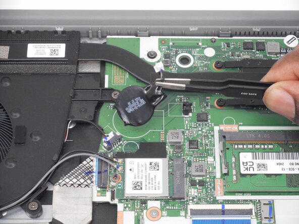

    • Use tweezers to disconnect the CMOS battery connector from its motherboard port.
    • Remove the CMOS battery (adhesive will come off when the CMOS is removed).
