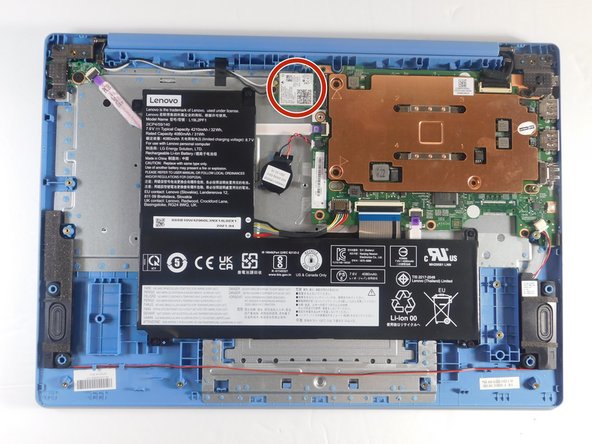

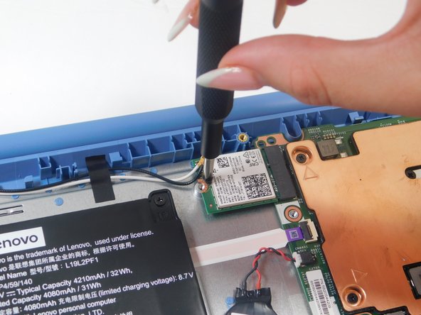

  3. Lenovo IdeaPad 1-14IGL05 Wi-Fi Card Replacement, Wi-Fi Card: crwdns2935265:03crwdnd2935265:01crwdnd2935265:03crwdne2935265:0 Lenovo IdeaPad 1-14IGL05 Wi-Fi Card Replacement, Wi-Fi Card: crwdns2935265:03crwdnd2935265:02crwdnd2935265:03crwdne2935265:0 Lenovo IdeaPad 1-14IGL05 Wi-Fi Card Replacement, Wi-Fi Card: crwdns2935265:03crwdnd2935265:03crwdnd2935265:03crwdne2935265:0
    • Unscrew the 3 mm Phillips screw that secures the Wi-Fi card.

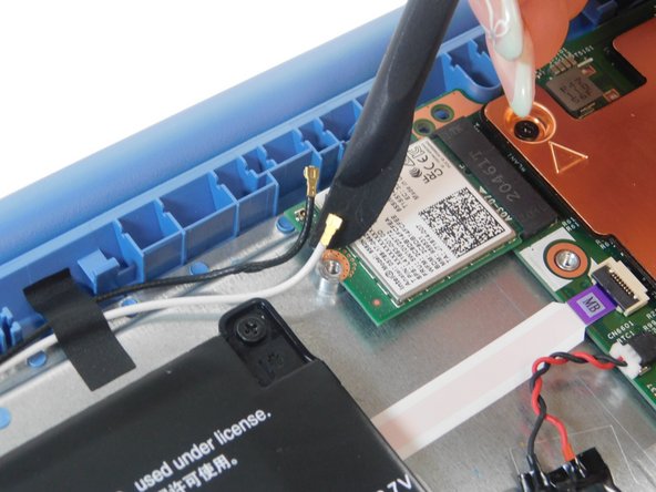

  4. Lenovo IdeaPad 1-14IGL05 Wi-Fi Card Replacement: crwdns2935265:04crwdnd2935265:01crwdnd2935265:02crwdne2935265:0 Lenovo IdeaPad 1-14IGL05 Wi-Fi Card Replacement: crwdns2935265:04crwdnd2935265:02crwdnd2935265:02crwdne2935265:0
    • Use a plastic spudger to gently lift and disconnect the two antenna cables.
    • Note the position of the cables to put them back in the same order.
    • Grip the left edge of the card and pull it directly out of its socket.
