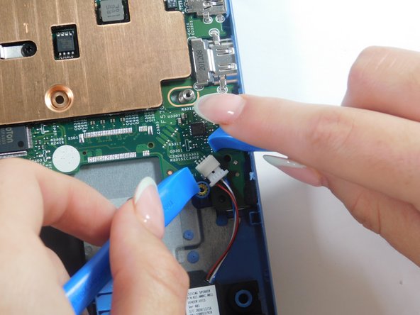

    • Insert an opening tool in the gap between the lower case and chassis.
    • Pry around the entire perimeter of the lower case until it fully releases.
    • Remove the lower case.
    • Do not force the lower case off. Continue to pry around the perimeter until it lifts off with minimal force.

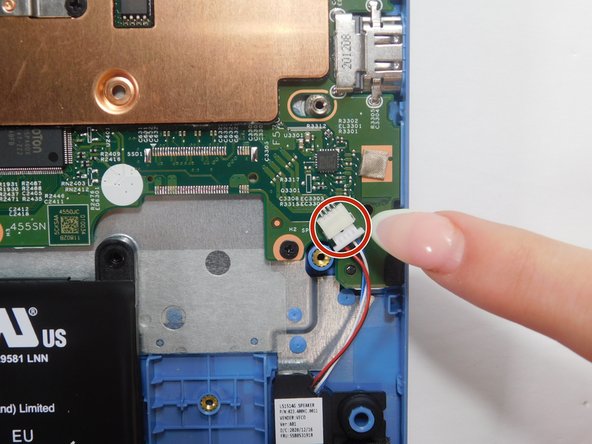

    • Use two opening tools or your fingernails to gently "walk" the speaker connector directly out of its motherboard socket.

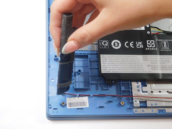

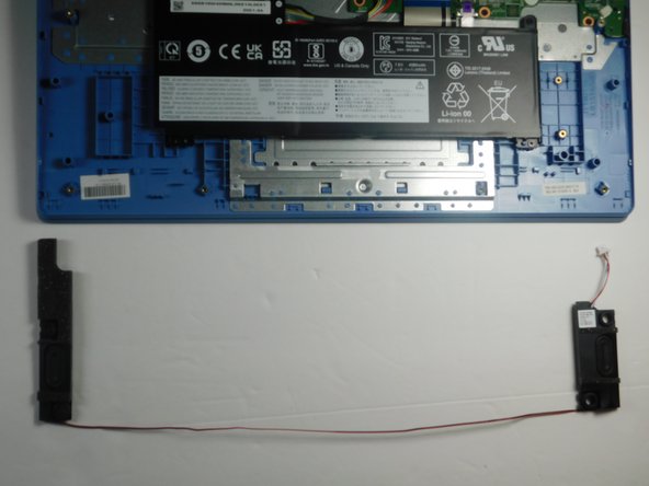

    • Lift the right speaker up and out of the chassis.
    • Lift the left speaker up and out of the chassis.
