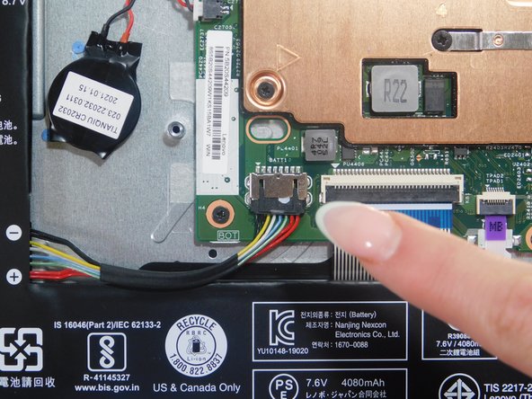

  3. Lenovo IdeaPad 1-14IGL05 Battery Replacement, Battery: crwdns2935265:03crwdnd2935265:01crwdnd2935265:02crwdne2935265:0 Lenovo IdeaPad 1-14IGL05 Battery Replacement, Battery: crwdns2935265:03crwdnd2935265:02crwdnd2935265:02crwdne2935265:0
    • Remove the five 3 mm Phillips screws that secure the battery.
    • Remove the bundled cable connector by holding it on each side and carefully pulling the connector to release it from the motherboard.
  4. Lenovo IdeaPad 1-14IGL05 Battery Replacement: crwdns2935265:04crwdnd2935265:01crwdnd2935265:01crwdne2935265:0
    • Grip the battery edge and lift the battery up and out of the device.
For optimal performance, after completing this guide, calibrate your newly installed battery.
