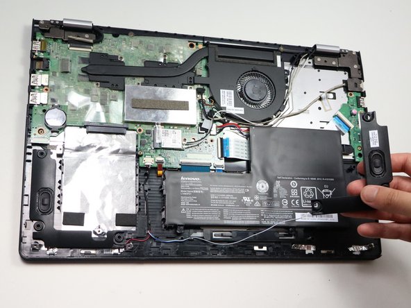

  3. Lenovo Flex 3-1580 Speaker Replacement, Speaker: crwdns2935265:03crwdnd2935265:01crwdnd2935265:02crwdne2935265:0 Lenovo Flex 3-1580 Speaker Replacement, Speaker: crwdns2935265:03crwdnd2935265:02crwdnd2935265:02crwdne2935265:0
    • Pull up the speakers from their compartments on the right and left sides.
  4. Lenovo Flex 3-1580 Speaker Replacement: crwdns2935265:04crwdnd2935265:01crwdnd2935265:01crwdne2935265:0
    • Gently pull and wiggle out the plug from the motherboard.
