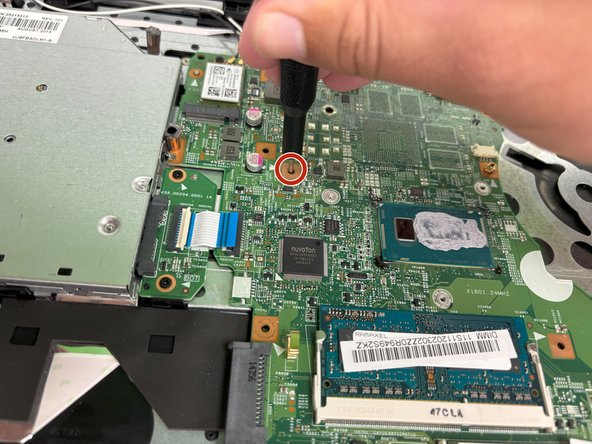

  4. Lenovo Flex 2-15 Keyboard Replacement, Keyboard: crwdns2935265:04crwdnd2935265:01crwdnd2935265:02crwdne2935265:0 Lenovo Flex 2-15 Keyboard Replacement, Keyboard: crwdns2935265:04crwdnd2935265:02crwdnd2935265:02crwdne2935265:0
    • Apply gentle pressure with the Philips #00 screwdriver through the hole to pop out the keyboard.
    • The hole in the red circle is a through hole to the back of keyboard. If pressure is applied the keyboard will pop off.
