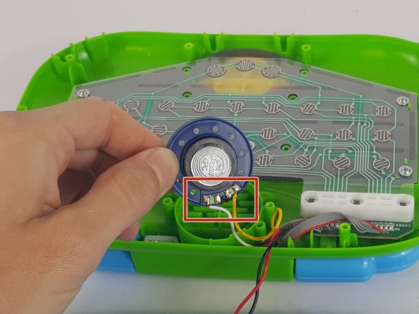

  7. Leapfrog My Own Leaptop Speaker Replacement Guide: crwdns2935265:07crwdnd2935265:01crwdnd2935265:02crwdne2935265:0 Leapfrog My Own Leaptop Speaker Replacement Guide: crwdns2935265:07crwdnd2935265:02crwdnd2935265:02crwdne2935265:0
    • Once the cover is removed, gently lift up the speaker making sure not to rip or break the wires.
    • If you are disassembling the device to clean the speaker, clean it at this point with a soft, lightly dampened cloth.
    • Gently turn the speaker over and carefully desolder the white and yellow wires from the speaker.
