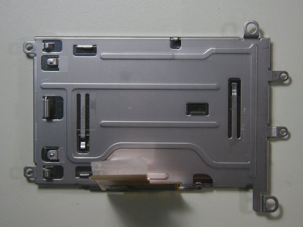

    1. LeapFrog LeapPad 2 Screen Assembly Replacement, Separate Motherboard and Screen Assembly: crwdns2935265:014crwdnd2935265:01crwdnd2935265:02crwdne2935265:0 LeapFrog LeapPad 2 Screen Assembly Replacement, Separate Motherboard and Screen Assembly: crwdns2935265:014crwdnd2935265:02crwdnd2935265:02crwdne2935265:0
      • Screen assembly tab locations.
      • Slide the motherboard in the direction of the game cartridge slot until the motherboard is out from under the metal tabs on the screen assembly.

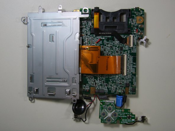

    2. LeapFrog LeapPad 2 Screen Assembly Replacement: crwdns2935265:015crwdnd2935265:01crwdnd2935265:02crwdne2935265:0 LeapFrog LeapPad 2 Screen Assembly Replacement: crwdns2935265:015crwdnd2935265:02crwdnd2935265:02crwdne2935265:0
      • Carefully flip the motherboard over by pivoting away from the screen assembly along the long edge with the microphone and speaker, as shown.
      • The motherboard and screen assembly are still connected by a ribbon cable that can be damaged if stressed severely.

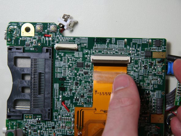

    1. LeapFrog LeapPad 2 Screen Assembly Replacement, Screen Assembly: crwdns2935265:016crwdnd2935265:01crwdnd2935265:02crwdne2935265:0 LeapFrog LeapPad 2 Screen Assembly Replacement, Screen Assembly: crwdns2935265:016crwdnd2935265:02crwdnd2935265:02crwdne2935265:0
      • Peel back the tape on the display ribbon cable connector.
      • The front camera is shown removed in these images, but its removal is optional for most tasks.

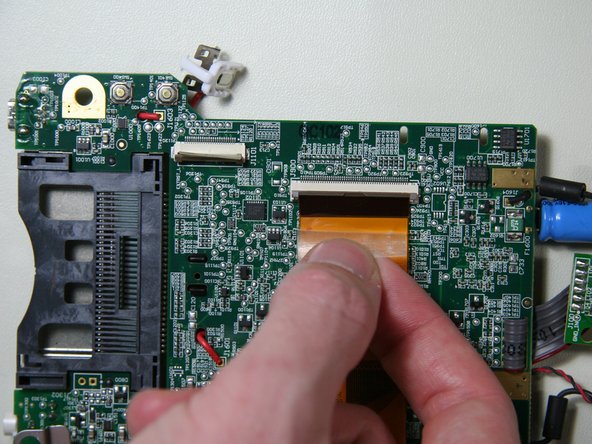

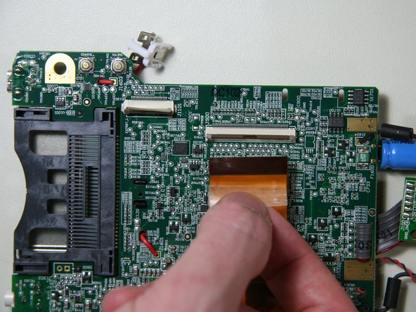

    2. LeapFrog LeapPad 2 Screen Assembly Replacement: crwdns2935265:017crwdnd2935265:01crwdnd2935265:03crwdne2935265:0 LeapFrog LeapPad 2 Screen Assembly Replacement: crwdns2935265:017crwdnd2935265:02crwdnd2935265:03crwdne2935265:0 LeapFrog LeapPad 2 Screen Assembly Replacement: crwdns2935265:017crwdnd2935265:03crwdnd2935265:03crwdne2935265:0
      • Open the display connector by lifting on the brown latch with a plastic opening tool or a finger until it is in a vertical position.
      • Failing to do this correctly could result in damage to the cable and/or connector.
      • Gently pull on the display ribbon cable and it should easily slide out of the connecter.
      • If the connector is properly open, disconnecting the ribbon cable should require little to no force.

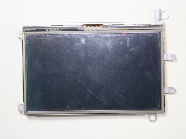

      • The screen assembly is now separated.
