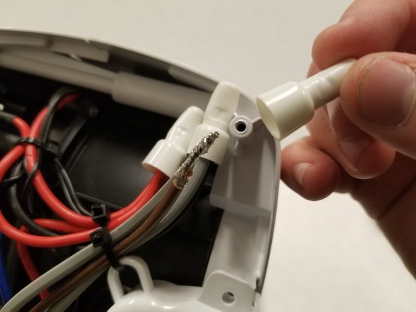

    • Trace the two grey cables of the ACLI plug to their white wire connectors. Pinch the wire connector and pull out the wire connector with pliers.
    • Keep record of which independent wire went to which wire connector.

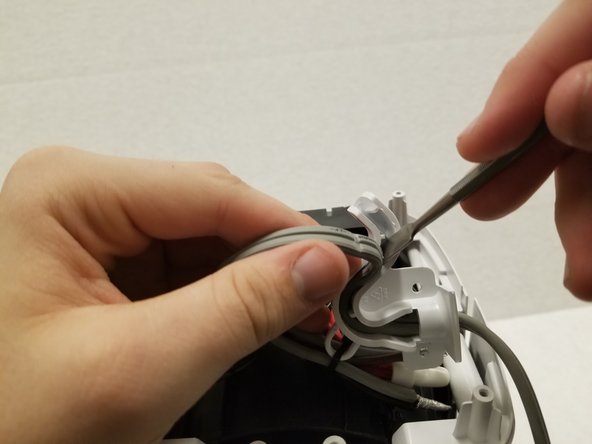

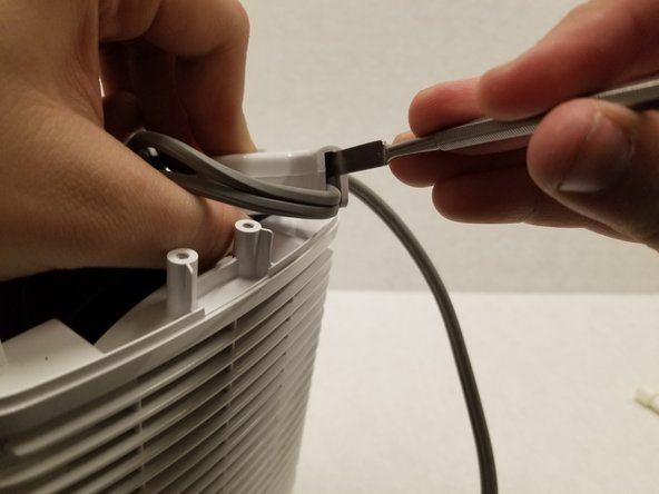

    • Gently free the wire from the power cord casing with a spudger.
    • The cable may be too tight to pull out from the power cord casing. If you struggle to pull the cable out, use the pointed end of a spudger to free the cable from the power cord casing.
    • Pull the ACLI cable out from the power cord casing with your hands.
    • Pull the entire ACLI cable out of the device.
    • During reassembly, do not use a metal spudger to push the cable back into the power cord casing. You might break the cable’s insulation when applying force to the cable with a metal spudger.
