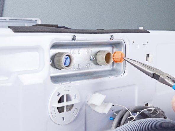

    • Before you begin your repair, perform the following:
    • Turn off the main water supply
    • Unplug your washer
    • Disconnect all water connections at the rear of your washer

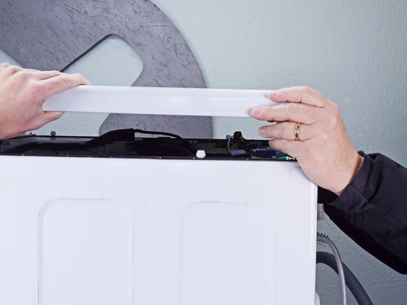

  3. LG WM3050CW Inlet Valve Assembly Replacement, Remove the top panel: crwdns2935265:03crwdnd2935265:01crwdnd2935265:02crwdne2935265:0 LG WM3050CW Inlet Valve Assembly Replacement, Remove the top panel: crwdns2935265:03crwdnd2935265:02crwdnd2935265:02crwdne2935265:0
    • Slide the top panel 1-2 inches towards the rear of the device to disconnect its clips.
  4. LG WM3050CW Inlet Valve Assembly Replacement: crwdns2935265:04crwdnd2935265:01crwdnd2935265:02crwdne2935265:0 LG WM3050CW Inlet Valve Assembly Replacement: crwdns2935265:04crwdnd2935265:02crwdnd2935265:02crwdne2935265:0
    • Tilt the top panel upward to completely disconnect it from the chassis.
    • Remove the top panel.

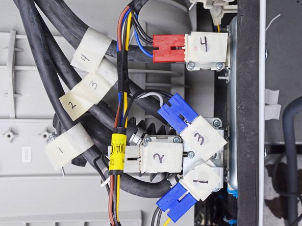

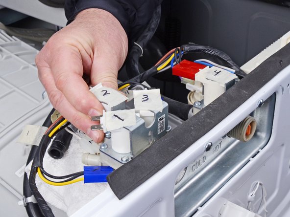

  5. LG WM3050CW Inlet Valve Assembly Replacement, Inlet valve information: crwdns2935265:05crwdnd2935265:01crwdnd2935265:03crwdne2935265:0 LG WM3050CW Inlet Valve Assembly Replacement, Inlet valve information: crwdns2935265:05crwdnd2935265:02crwdnd2935265:03crwdne2935265:0 LG WM3050CW Inlet Valve Assembly Replacement, Inlet valve information: crwdns2935265:05crwdnd2935265:03crwdnd2935265:03crwdne2935265:0
    • To prevent confusion, label each valve and its corresponding hose.
    • You can use masking tape or mark the components themselves.
    • Repeat the labelling procedure for each valve and its corresponding connector.

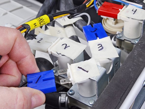

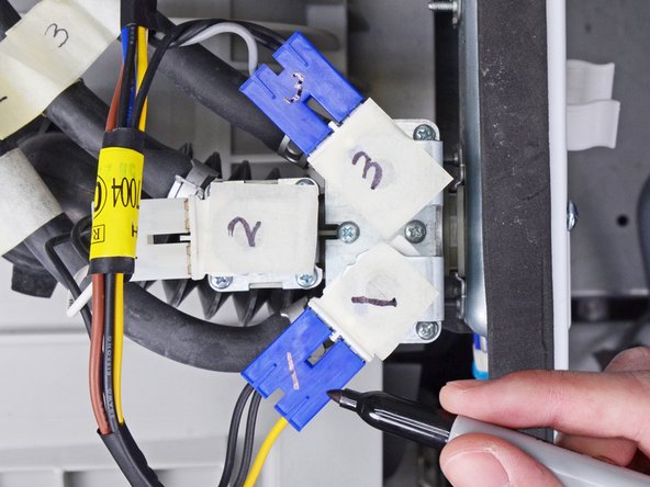

  6. LG WM3050CW Inlet Valve Assembly Replacement, Disconnect the inlet valve: crwdns2935265:06crwdnd2935265:01crwdnd2935265:03crwdne2935265:0 LG WM3050CW Inlet Valve Assembly Replacement, Disconnect the inlet valve: crwdns2935265:06crwdnd2935265:02crwdnd2935265:03crwdne2935265:0 LG WM3050CW Inlet Valve Assembly Replacement, Disconnect the inlet valve: crwdns2935265:06crwdnd2935265:03crwdnd2935265:03crwdne2935265:0
    • Disconnect the three spade connectors from the inlet valve.
    • Always grip cables by their connectors and not the wires themselves.

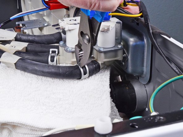

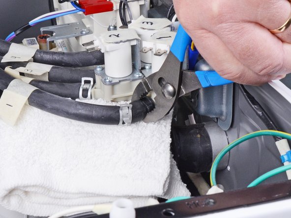

    • Place a dry rag under the inlet valve to soak up any lingering water.
  8. LG WM3050CW Inlet Valve Assembly Replacement: crwdns2935265:08crwdnd2935265:01crwdnd2935265:03crwdne2935265:0 LG WM3050CW Inlet Valve Assembly Replacement: crwdns2935265:08crwdnd2935265:02crwdnd2935265:03crwdne2935265:0 LG WM3050CW Inlet Valve Assembly Replacement: crwdns2935265:08crwdnd2935265:03crwdnd2935265:03crwdne2935265:0

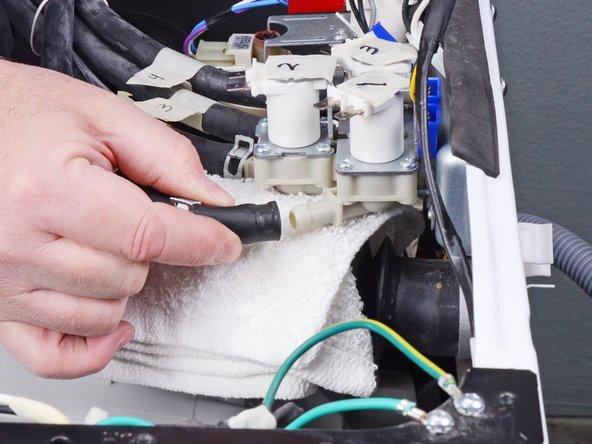

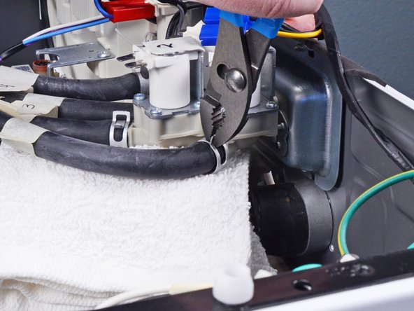

    • Use slip joint pliers to pinch the inlet valve hose clamp and pull it away from the inlet valve assembly.
  9. LG WM3050CW Inlet Valve Assembly Replacement: crwdns2935265:09crwdnd2935265:01crwdnd2935265:02crwdne2935265:0 LG WM3050CW Inlet Valve Assembly Replacement: crwdns2935265:09crwdnd2935265:02crwdnd2935265:02crwdne2935265:0
    • Use slip joint pliers to rotate the inlet valve hose back and forth around its connection and loosen it.
  10. LG WM3050CW Inlet Valve Assembly Replacement: crwdns2935265:010crwdnd2935265:01crwdnd2935265:02crwdne2935265:0 LG WM3050CW Inlet Valve Assembly Replacement: crwdns2935265:010crwdnd2935265:02crwdnd2935265:02crwdne2935265:0
    • Pull the inlet valve hose straight off its connection on the inlet valve assembly.
  11. LG WM3050CW Inlet Valve Assembly Replacement: crwdns2935265:011crwdnd2935265:01crwdnd2935265:01crwdne2935265:0
    • Repeat the previous three steps for each remaining hose attached to the inlet valve assembly.
  12. LG WM3050CW Inlet Valve Assembly Replacement, Remove the filters: crwdns2935265:012crwdnd2935265:01crwdnd2935265:03crwdne2935265:0 LG WM3050CW Inlet Valve Assembly Replacement, Remove the filters: crwdns2935265:012crwdnd2935265:02crwdnd2935265:03crwdne2935265:0 LG WM3050CW Inlet Valve Assembly Replacement, Remove the filters: crwdns2935265:012crwdnd2935265:03crwdnd2935265:03crwdne2935265:0
    • If your replacement part comes with filters pre-installed, skip this step.
    • Use needle nose pliers to pull the inlet valve filters straight out of the inlets in the chassis.
    • Remove the filters.

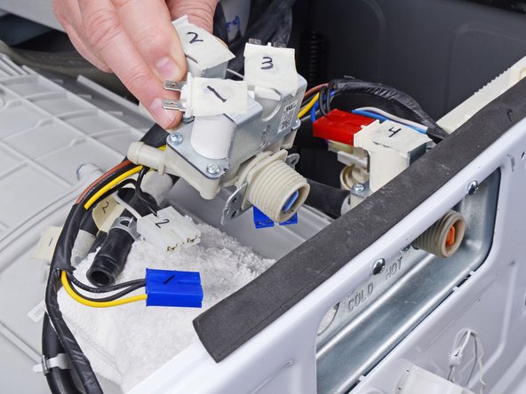

  13. LG WM3050CW Inlet Valve Assembly Replacement, Unfasten the inlet valve assembly: crwdns2935265:013crwdnd2935265:01crwdnd2935265:01crwdne2935265:0
    • Use a Phillips driver to remove the two 14.4 mm‑long screws securing the inlet valve assembly.
  14. LG WM3050CW Inlet Valve Assembly Replacement, Remove the inlet valve assembly: crwdns2935265:014crwdnd2935265:01crwdnd2935265:03crwdne2935265:0 LG WM3050CW Inlet Valve Assembly Replacement, Remove the inlet valve assembly: crwdns2935265:014crwdnd2935265:02crwdnd2935265:03crwdne2935265:0 LG WM3050CW Inlet Valve Assembly Replacement, Remove the inlet valve assembly: crwdns2935265:014crwdnd2935265:03crwdnd2935265:03crwdne2935265:0
    • Pull the inlet valve assembly straight out of its slot in the chassis to remove it.
