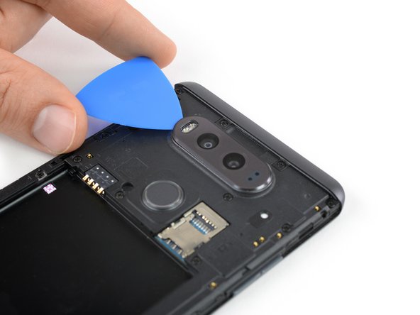

    • Press the button on the lower right side of the LG V20 to open the clamp that holds the back cover on the back side of the phone.
    • Remove the back cover.
  2. LG V20 Rear Lens Cover Replacement, Battery: crwdns2935265:02crwdnd2935265:01crwdnd2935265:03crwdne2935265:0 LG V20 Rear Lens Cover Replacement, Battery: crwdns2935265:02crwdnd2935265:02crwdnd2935265:03crwdne2935265:0 LG V20 Rear Lens Cover Replacement, Battery: crwdns2935265:02crwdnd2935265:03crwdnd2935265:03crwdne2935265:0
    • Before disassembling your phone, discharge the battery below 25%. A charged lithium-ion battery can catch fire and/or explode if accidentally punctured.
    • Insert a spudger or your fingernail under the battery at the small recess on the lower edge.
    • Be careful not to deform or puncture the battery.
    • Pry up and remove the battery.
  3. LG V20 Rear Lens Cover Replacement, Rear Lens Cover: crwdns2935265:03crwdnd2935265:01crwdnd2935265:01crwdne2935265:0
  4. LG V20 Rear Lens Cover Replacement: crwdns2935265:04crwdnd2935265:01crwdnd2935265:03crwdne2935265:0 LG V20 Rear Lens Cover Replacement: crwdns2935265:04crwdnd2935265:02crwdnd2935265:03crwdne2935265:0 LG V20 Rear Lens Cover Replacement: crwdns2935265:04crwdnd2935265:03crwdnd2935265:03crwdne2935265:0
    • Use the tip of an opening pick to gently pry up the rear lens cover.
    • Use the tip of the opening pick and slide around the whole rear lens cover to cut the adhesive beneath.
  5. LG V20 Rear Lens Cover Replacement: crwdns2935265:05crwdnd2935265:01crwdnd2935265:01crwdne2935265:0
    • Remove the rear lens cover.
To reassemble your device, follow these instructions in reverse order. Apply new adhesive where it’s necessary.

My rear camera lens cover stack fell off. The flash array, the two cameras and the sensors on the right are in place. The rubber 'rings' around the flash and sensors are gone and everything above them is gone.
How do I get all of the pieces?
Is it called a “lens cover stack" or something like that?
Bill Lipe - crwdns2934203:0crwdne2934203:0
It's hard to tell from the pictures but the lens cover is actually 2 pieces. There is a metal piece that the actual glass fits into but you can only see the outside edge of it. So if you accidentally break the glass camera cover like I did and order a replacement piece, they are probably only going to send you the glass. You'll have to use something sharp to scrape the broken glass and adhesive off of the metal piece and then use new adhesive to stick the glass to the metal piece. Then you can insert the little LED cover and stick this assembly to the the back of the phone.
