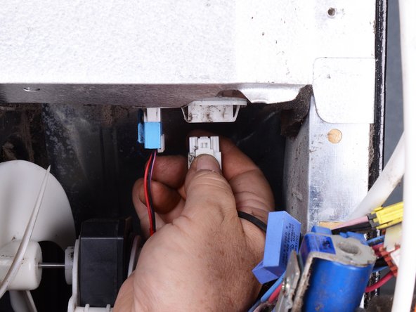

  4. LG Refrigerator Water Inlet Valve Assembly Test and Replacement, Disconnect the water inlet valve assembly: crwdns2935265:04crwdnd2935265:01crwdnd2935265:03crwdne2935265:0 LG Refrigerator Water Inlet Valve Assembly Test and Replacement, Disconnect the water inlet valve assembly: crwdns2935265:04crwdnd2935265:02crwdnd2935265:03crwdne2935265:0 LG Refrigerator Water Inlet Valve Assembly Test and Replacement, Disconnect the water inlet valve assembly: crwdns2935265:04crwdnd2935265:03crwdnd2935265:03crwdne2935265:0
    • Squeeze and pull down the connectors for the valve assembly harness to disconnect them.

  7. LG Refrigerator Water Inlet Valve Assembly Test and Replacement, Disconnect the remaining electrical connection(s): crwdns2935265:07crwdnd2935265:01crwdnd2935265:02crwdne2935265:0 LG Refrigerator Water Inlet Valve Assembly Test and Replacement, Disconnect the remaining electrical connection(s): crwdns2935265:07crwdnd2935265:02crwdnd2935265:02crwdne2935265:0
    • Squeeze and pull downward the remaining water inlet valve assembly connector(s) to disconnect it.

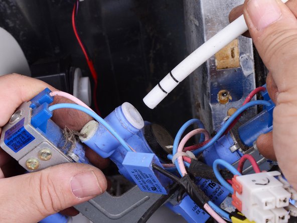

  8. LG Refrigerator Water Inlet Valve Assembly Test and Replacement, Disconnect the water tubing connections: crwdns2935265:08crwdnd2935265:01crwdnd2935265:02crwdne2935265:0 LG Refrigerator Water Inlet Valve Assembly Test and Replacement, Disconnect the water tubing connections: crwdns2935265:08crwdnd2935265:02crwdnd2935265:02crwdne2935265:0
    • Use long nose pliers to pull and remove the locking clip from a tubing connector.
  9. LG Refrigerator Water Inlet Valve Assembly Test and Replacement: crwdns2935265:09crwdnd2935265:01crwdnd2935265:03crwdne2935265:0 LG Refrigerator Water Inlet Valve Assembly Test and Replacement: crwdns2935265:09crwdnd2935265:02crwdnd2935265:03crwdne2935265:0 LG Refrigerator Water Inlet Valve Assembly Test and Replacement: crwdns2935265:09crwdnd2935265:03crwdnd2935265:03crwdne2935265:0
    • Use your fingers to squeeze the flange surrounding the water tube toward the valve to release the tube.
    • While you squeeze the flange, pull the tubing straight out of the connector.
  10. LG Refrigerator Water Inlet Valve Assembly Test and Replacement, Remove the inlet valve assembly: crwdns2935265:010crwdnd2935265:01crwdnd2935265:03crwdne2935265:0 LG Refrigerator Water Inlet Valve Assembly Test and Replacement, Remove the inlet valve assembly: crwdns2935265:010crwdnd2935265:02crwdnd2935265:03crwdne2935265:0 LG Refrigerator Water Inlet Valve Assembly Test and Replacement, Remove the inlet valve assembly: crwdns2935265:010crwdnd2935265:03crwdnd2935265:03crwdne2935265:0
    • Repeat this procedure for the remaining tubes.
    • Remove the inlet valve assembly.

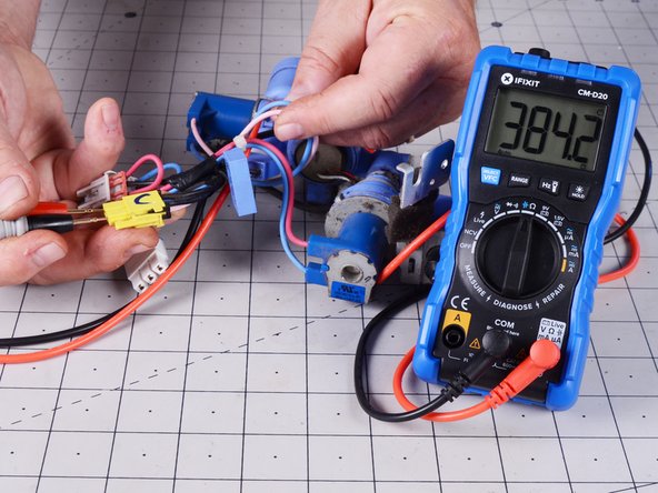

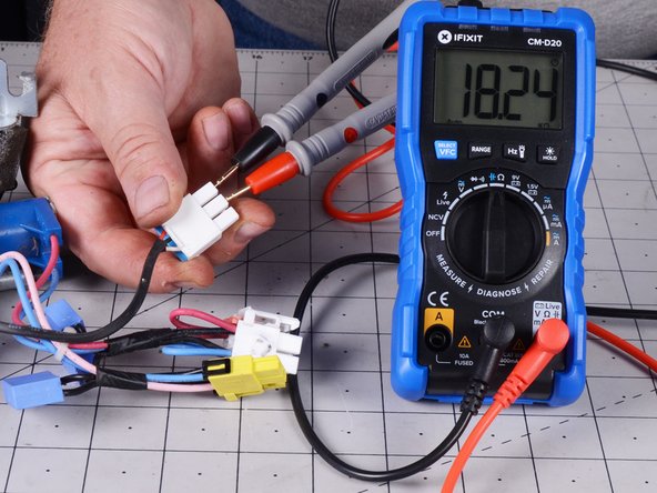

  11. LG Refrigerator Water Inlet Valve Assembly Test and Replacement, Test the inlet valve assembly: crwdns2935265:011crwdnd2935265:01crwdnd2935265:03crwdne2935265:0 LG Refrigerator Water Inlet Valve Assembly Test and Replacement, Test the inlet valve assembly: crwdns2935265:011crwdnd2935265:02crwdnd2935265:03crwdne2935265:0 LG Refrigerator Water Inlet Valve Assembly Test and Replacement, Test the inlet valve assembly: crwdns2935265:011crwdnd2935265:03crwdnd2935265:03crwdne2935265:0
    • If you have a multimeter, you can use it to test the inlet valve assembly components.
    • Set the multimeter to the ohm (Ω) setting.
    • For the first solenoid, test the resistance between the wires from it at the connector.
    • The acceptable resistance is 360 to 420 Ω.
    • Repeat the test on the connector for the other solenoid.
    • To test the flow meter, test the resistance between the wires from it at the connector.
    • The acceptable resistance is 4 kΩ to 30 kΩ.
