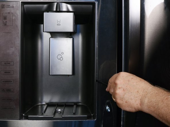

  2. LG Refrigerator Water Dispensing Switch Testing and Replacement, Loosen the left door handle set screws: crwdns2935265:02crwdnd2935265:01crwdnd2935265:02crwdne2935265:0 LG Refrigerator Water Dispensing Switch Testing and Replacement, Loosen the left door handle set screws: crwdns2935265:02crwdnd2935265:02crwdnd2935265:02crwdne2935265:0
    • To remove the left door handle, first open the right door.
    • Use a 2 1/2 mm hex wrench to loosen the set screws in the top and bottom of the left door handle.
  3. LG Refrigerator Water Dispensing Switch Testing and Replacement, Remove the left door handle: crwdns2935265:03crwdnd2935265:01crwdnd2935265:02crwdne2935265:0 LG Refrigerator Water Dispensing Switch Testing and Replacement, Remove the left door handle: crwdns2935265:03crwdnd2935265:02crwdnd2935265:02crwdne2935265:0
    • Pull the left door handle straight off to remove it.

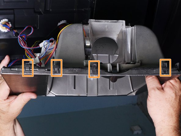

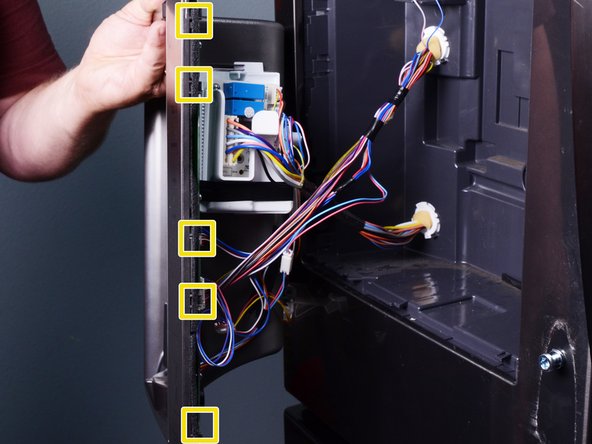

  4. LG Refrigerator Water Dispensing Switch Testing and Replacement, Retaining clip locations: crwdns2935265:04crwdnd2935265:01crwdnd2935265:03crwdne2935265:0 LG Refrigerator Water Dispensing Switch Testing and Replacement, Retaining clip locations: crwdns2935265:04crwdnd2935265:02crwdnd2935265:03crwdne2935265:0 LG Refrigerator Water Dispensing Switch Testing and Replacement, Retaining clip locations: crwdns2935265:04crwdnd2935265:03crwdnd2935265:03crwdne2935265:0
    • The dispenser assembly is secured by very strong clips, making it very difficult to remove. Take note of the clip location examples shown in the photos:
    • Right side clips
    • Top clips
    • Left side clips (Note, the dispenser is being held upside down for the photo, so the upper left side clips are at the bottom of the photo.)
    • During disassembly, you may break some of these clips. If you do, don't worry; the assembly does not need all the clips to be properly secured.

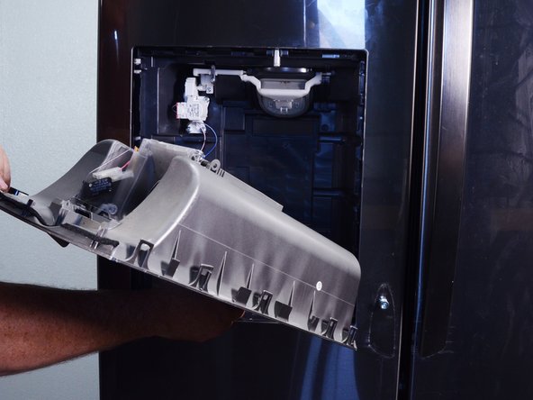

  5. LG Refrigerator Water Dispensing Switch Testing and Replacement, Release the dispenser: crwdns2935265:05crwdnd2935265:01crwdnd2935265:03crwdne2935265:0 LG Refrigerator Water Dispensing Switch Testing and Replacement, Release the dispenser: crwdns2935265:05crwdnd2935265:02crwdnd2935265:03crwdne2935265:0 LG Refrigerator Water Dispensing Switch Testing and Replacement, Release the dispenser: crwdns2935265:05crwdnd2935265:03crwdnd2935265:03crwdne2935265:0
    • Use a spudger to pry out the top edge of the dispenser assembly.
    • Once you've created a gap, use your fingertips to pull the edge downward.
    • Use additional spudgers to unfasten the clips securing the dispenser assembly to the refrigerator door.
    • Optionally, you may use a flat-blade screwdriver to assist in this process. Be careful not to damage the door; you may scratch the door surface or dent the rim of the dispenser opening.
  6. LG Refrigerator Water Dispensing Switch Testing and Replacement, Reposition the dispenser: crwdns2935265:06crwdnd2935265:01crwdnd2935265:03crwdne2935265:0 LG Refrigerator Water Dispensing Switch Testing and Replacement, Reposition the dispenser: crwdns2935265:06crwdnd2935265:02crwdnd2935265:03crwdne2935265:0 LG Refrigerator Water Dispensing Switch Testing and Replacement, Reposition the dispenser: crwdns2935265:06crwdnd2935265:03crwdnd2935265:03crwdne2935265:0
    • Grasp the top edge of the dispenser assembly in the middle and pull outwards.
    • Continue prying and pulling around the perimeter of the assembly to release it.

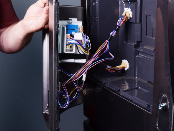

    • Grasp the assembly firmly and pull it out of the refrigerator door.
    • Don't try to pull the assembly completely off the refrigerator door. The assembly is still connected with numerous wires. These are mainly connected to the left side of the dispenser.
  8. LG Refrigerator Water Dispensing Switch Testing and Replacement, Disconnect the dispenser: crwdns2935265:08crwdnd2935265:01crwdnd2935265:01crwdne2935265:0
    • Squeeze the multiple wire connectors and pull them straight off to disconnect them from the various PC boards.
    • Some of the connectors may be permanently attached to the PC board and can't be removed.

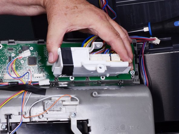

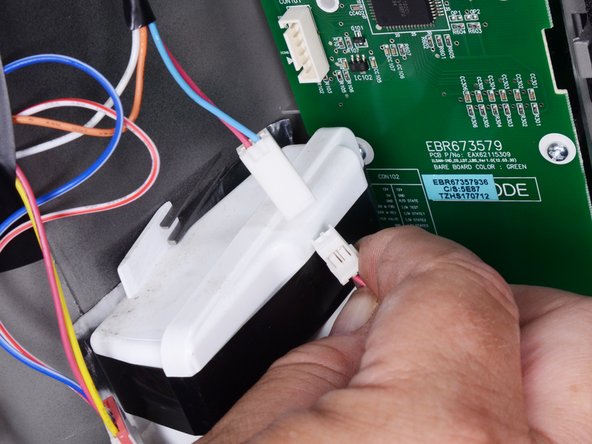

  9. LG Refrigerator Water Dispensing Switch Testing and Replacement: crwdns2935265:09crwdnd2935265:01crwdnd2935265:02crwdne2935265:0 LG Refrigerator Water Dispensing Switch Testing and Replacement: crwdns2935265:09crwdnd2935265:02crwdnd2935265:02crwdne2935265:0
    • Squeeze and separate the various connectors in the wiring harness. The photo shows two examples.

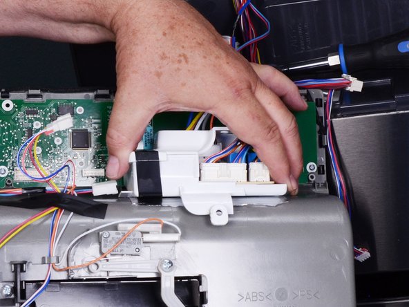

  10. LG Refrigerator Water Dispensing Switch Testing and Replacement, Unfasten the circuit board holder: crwdns2935265:010crwdnd2935265:01crwdnd2935265:03crwdne2935265:0 LG Refrigerator Water Dispensing Switch Testing and Replacement, Unfasten the circuit board holder: crwdns2935265:010crwdnd2935265:02crwdnd2935265:03crwdne2935265:0 LG Refrigerator Water Dispensing Switch Testing and Replacement, Unfasten the circuit board holder: crwdns2935265:010crwdnd2935265:03crwdnd2935265:03crwdne2935265:0
    • Use a Phillips screwdriver to remove the screw securing the circuit board holder to the dispenser assembly. Many, but not all, units will have this PC board and holder.
    • Lift and remove the circuit board holder from the dispenser assembly.

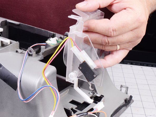

  12. LG Refrigerator Water Dispensing Switch Testing and Replacement, Remove the water dispensing switch bracket: crwdns2935265:012crwdnd2935265:01crwdnd2935265:01crwdne2935265:0
    • Use a Phillips screwdriver to remove screws securing the water switch bracket to the dispenser assembly.
  13. LG Refrigerator Water Dispensing Switch Testing and Replacement, Remove the switch bracket: crwdns2935265:013crwdnd2935265:01crwdnd2935265:02crwdne2935265:0 LG Refrigerator Water Dispensing Switch Testing and Replacement, Remove the switch bracket: crwdns2935265:013crwdnd2935265:02crwdnd2935265:02crwdne2935265:0
    • Lift the switch bracket off the dispenser assembly.

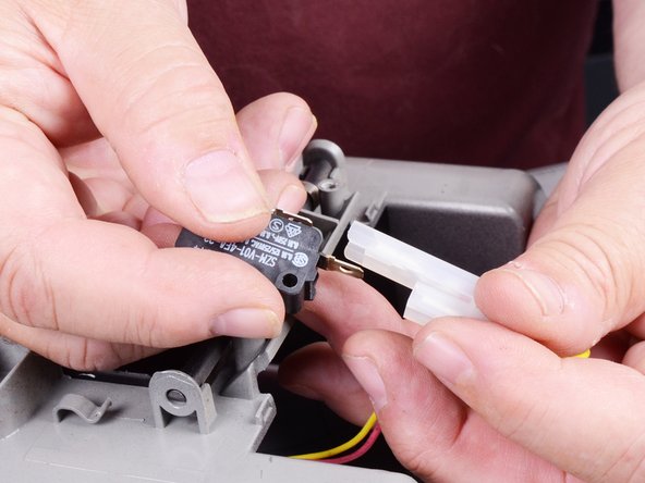

  14. LG Refrigerator Water Dispensing Switch Testing and Replacement, Remove the water dispensing switch from the bracket: crwdns2935265:014crwdnd2935265:01crwdnd2935265:02crwdne2935265:0 LG Refrigerator Water Dispensing Switch Testing and Replacement, Remove the water dispensing switch from the bracket: crwdns2935265:014crwdnd2935265:02crwdnd2935265:02crwdne2935265:0
    • Slide the water dispensing switch off of its pegs on the bracket.
  15. LG Refrigerator Water Dispensing Switch Testing and Replacement, Disconnect the water dispensing switch: crwdns2935265:015crwdnd2935265:01crwdnd2935265:02crwdne2935265:0 LG Refrigerator Water Dispensing Switch Testing and Replacement, Disconnect the water dispensing switch: crwdns2935265:015crwdnd2935265:02crwdnd2935265:02crwdne2935265:0
    • Pull the connector straight off the water dispensing switch to disconnect it.

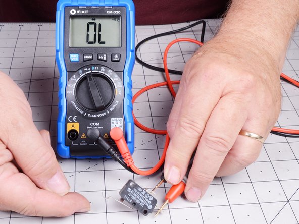

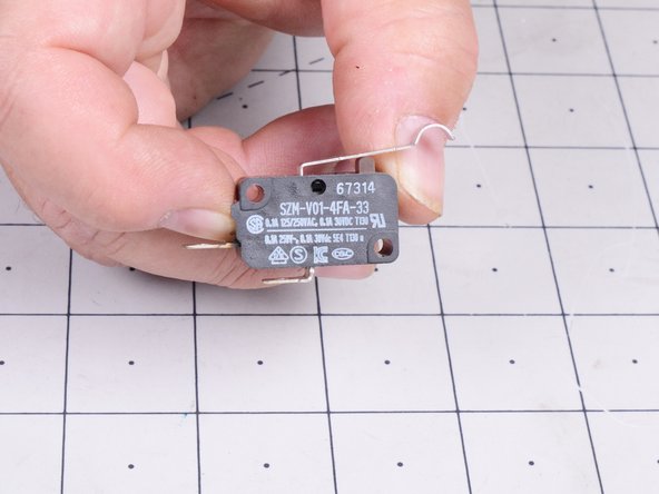

  16. LG Refrigerator Water Dispensing Switch Testing and Replacement, Test the water dispensing switch: crwdns2935265:016crwdnd2935265:01crwdnd2935265:03crwdne2935265:0 LG Refrigerator Water Dispensing Switch Testing and Replacement, Test the water dispensing switch: crwdns2935265:016crwdnd2935265:02crwdnd2935265:03crwdne2935265:0 LG Refrigerator Water Dispensing Switch Testing and Replacement, Test the water dispensing switch: crwdns2935265:016crwdnd2935265:03crwdnd2935265:03crwdne2935265:0
    • If you have a multimeter, you can test to see if your water dispensing switch is good or not. Set your multimeter to the continuity function, with beeper.
    • Touch one probe to each of the switch terminals at the same time.
    • When you operate the small lever on the switch the meter should sound.
    • When you release the small lever on the switch the meter should not sound.
    • If the switch does not operate as described above, replace it.
