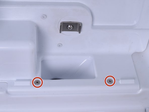

    1. LG Refrigerator Upper Ice Maker Assembly Replacement, Remove the ice maker assembly screws: crwdns2935265:03crwdnd2935265:01crwdnd2935265:02crwdne2935265:0 LG Refrigerator Upper Ice Maker Assembly Replacement, Remove the ice maker assembly screws: crwdns2935265:03crwdnd2935265:02crwdnd2935265:02crwdne2935265:0
      • Use a #2 Philips driver to remove the screws that secure the ice maker assembly to the refrigerator door.

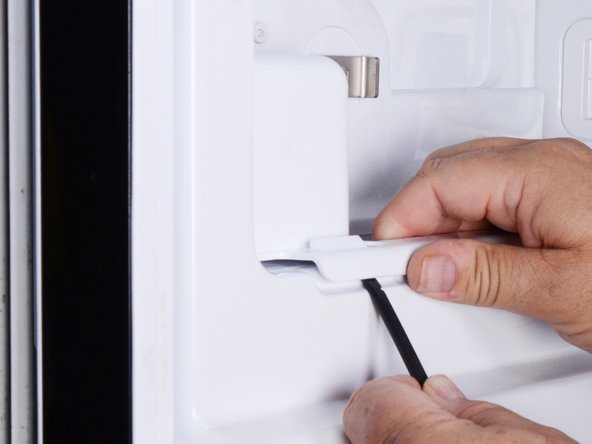

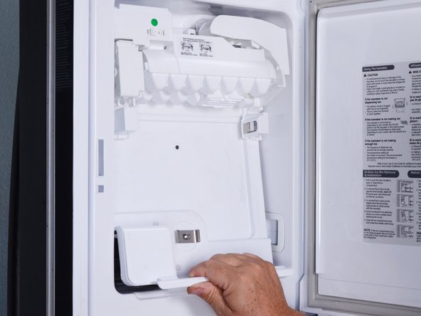

    2. LG Refrigerator Upper Ice Maker Assembly Replacement, Reposition the ice maker assembly: crwdns2935265:04crwdnd2935265:01crwdnd2935265:03crwdne2935265:0 LG Refrigerator Upper Ice Maker Assembly Replacement, Reposition the ice maker assembly: crwdns2935265:04crwdnd2935265:02crwdnd2935265:03crwdne2935265:0 LG Refrigerator Upper Ice Maker Assembly Replacement, Reposition the ice maker assembly: crwdns2935265:04crwdnd2935265:03crwdnd2935265:03crwdne2935265:0
      • Use a spudger to lift the bottom edge of the ice maker assembly. This action will release the assembly from the refrigerator door.
      • Pull the bottom edge of the ice maker assembly toward you to free it from the door.

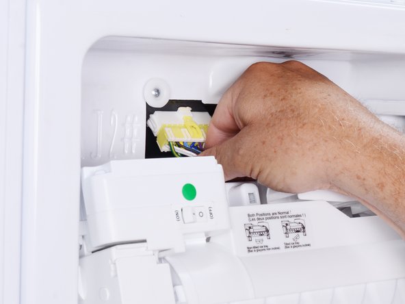

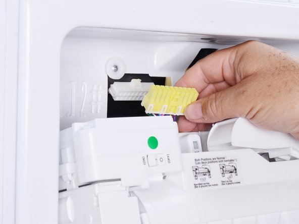

    3. LG Refrigerator Upper Ice Maker Assembly Replacement: crwdns2935265:05crwdnd2935265:01crwdnd2935265:03crwdne2935265:0 LG Refrigerator Upper Ice Maker Assembly Replacement: crwdns2935265:05crwdnd2935265:02crwdnd2935265:03crwdne2935265:0 LG Refrigerator Upper Ice Maker Assembly Replacement: crwdns2935265:05crwdnd2935265:03crwdnd2935265:03crwdne2935265:0
      • Lower the ice maker assembly until you can access the connector located at the top of the assembly.
      • Squeeze the connector at the top of the ice maker assembly to release it.
      • Pull the connector straight down to disconnect it.
    4. LG Refrigerator Upper Ice Maker Assembly Replacement, Remove the ice maker assembly: crwdns2935265:06crwdnd2935265:01crwdnd2935265:01crwdne2935265:0
      • Remove the ice maker assembly.
