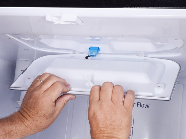

  5. LG Refrigerator Model LFX25973 Refrigerator Light Replacement, Lower the light unit: crwdns2935265:05crwdnd2935265:01crwdnd2935265:02crwdne2935265:0 LG Refrigerator Model LFX25973 Refrigerator Light Replacement, Lower the light unit: crwdns2935265:05crwdnd2935265:02crwdnd2935265:02crwdne2935265:0
    • With both hands, pull down the front edge of the light unit until it pops free.
    • Don't try to fully remove the light unit yet, as it is still connected to the refrigerator by some wires.

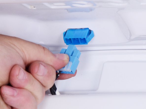

  6. LG Refrigerator Model LFX25973 Refrigerator Light Replacement, Disconnect the light unit: crwdns2935265:06crwdnd2935265:01crwdnd2935265:03crwdne2935265:0 LG Refrigerator Model LFX25973 Refrigerator Light Replacement, Disconnect the light unit: crwdns2935265:06crwdnd2935265:02crwdnd2935265:03crwdne2935265:0 LG Refrigerator Model LFX25973 Refrigerator Light Replacement, Disconnect the light unit: crwdns2935265:06crwdnd2935265:03crwdnd2935265:03crwdne2935265:0
    • Pinch the light unit connector to release it and pull it out straight to disconnect.
    • Remove the light unit.

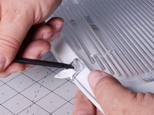

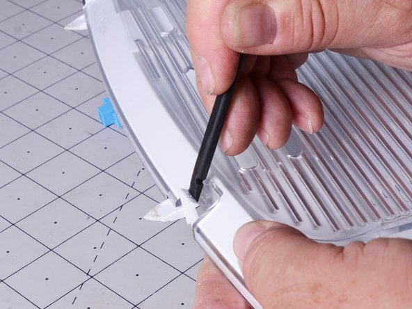

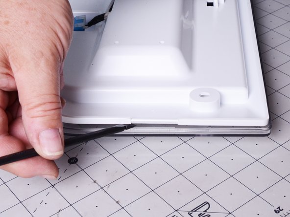

  7. LG Refrigerator Model LFX25973 Refrigerator Light Replacement, Remove the light cover: crwdns2935265:07crwdnd2935265:01crwdnd2935265:03crwdne2935265:0 LG Refrigerator Model LFX25973 Refrigerator Light Replacement, Remove the light cover: crwdns2935265:07crwdnd2935265:02crwdnd2935265:03crwdne2935265:0 LG Refrigerator Model LFX25973 Refrigerator Light Replacement, Remove the light cover: crwdns2935265:07crwdnd2935265:03crwdnd2935265:03crwdne2935265:0
    • Use a spudger to pry and release the two clips on the rear edge of the light.

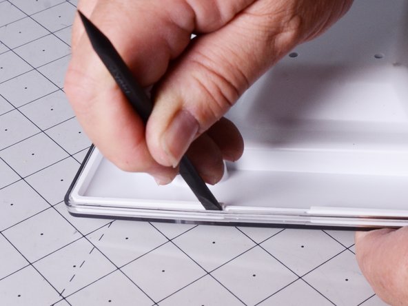

  8. LG Refrigerator Model LFX25973 Refrigerator Light Replacement: crwdns2935265:08crwdnd2935265:01crwdnd2935265:03crwdne2935265:0 LG Refrigerator Model LFX25973 Refrigerator Light Replacement: crwdns2935265:08crwdnd2935265:02crwdnd2935265:03crwdne2935265:0 LG Refrigerator Model LFX25973 Refrigerator Light Replacement: crwdns2935265:08crwdnd2935265:03crwdnd2935265:03crwdne2935265:0
    • Use a spudger to pry and release the sides of the light cover from the light base.

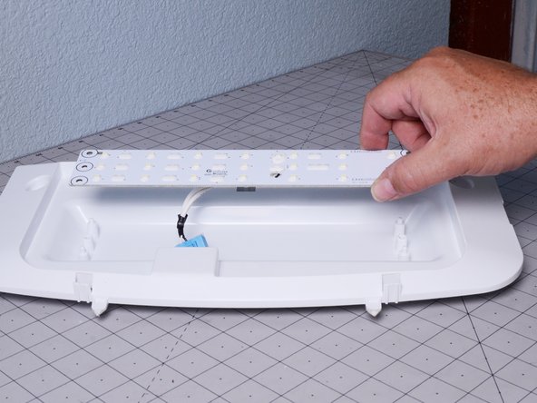

  9. LG Refrigerator Model LFX25973 Refrigerator Light Replacement: crwdns2935265:09crwdnd2935265:01crwdnd2935265:01crwdne2935265:0
    • Separate the light base from the light cover.
  10. LG Refrigerator Model LFX25973 Refrigerator Light Replacement, Remove the light module: crwdns2935265:010crwdnd2935265:01crwdnd2935265:01crwdne2935265:0
    • Use a Philips head driver to remove the two 14.5 mm long screws securing the light module.
  11. LG Refrigerator Model LFX25973 Refrigerator Light Replacement: crwdns2935265:011crwdnd2935265:01crwdnd2935265:02crwdne2935265:0 LG Refrigerator Model LFX25973 Refrigerator Light Replacement: crwdns2935265:011crwdnd2935265:02crwdnd2935265:02crwdne2935265:0
    • Lift the light module out of the light base and remove it.
