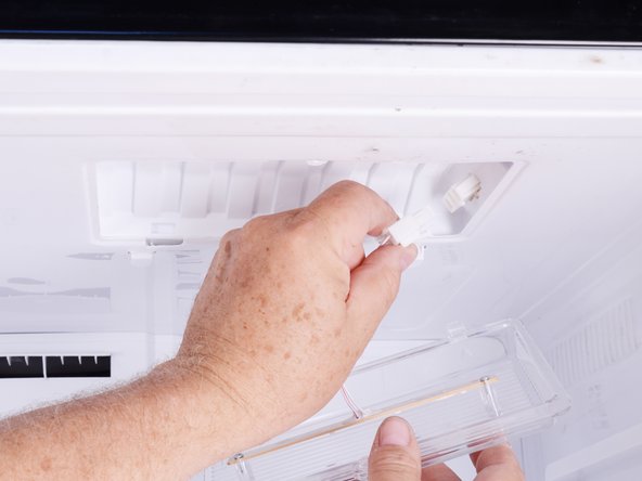

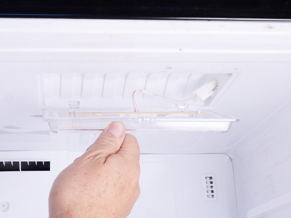

  8. LG Refrigerator Model LFX25973 Freezer Light Replacement, Unfasten the freezer light: crwdns2935265:08crwdnd2935265:01crwdnd2935265:02crwdne2935265:0 LG Refrigerator Model LFX25973 Freezer Light Replacement, Unfasten the freezer light: crwdns2935265:08crwdnd2935265:02crwdnd2935265:02crwdne2935265:0
    • Use a Phillips screwdriver to remove the 22 mm‑long screw securing the freezer light.
    • Lower the front edge of the freezer light to access its connector.
  9. LG Refrigerator Model LFX25973 Freezer Light Replacement, Remove the freezer light: crwdns2935265:09crwdnd2935265:01crwdnd2935265:03crwdne2935265:0 LG Refrigerator Model LFX25973 Freezer Light Replacement, Remove the freezer light: crwdns2935265:09crwdnd2935265:02crwdnd2935265:03crwdne2935265:0 LG Refrigerator Model LFX25973 Freezer Light Replacement, Remove the freezer light: crwdns2935265:09crwdnd2935265:03crwdnd2935265:03crwdne2935265:0
    • Squeeze the freezer light connector and pull it straight off to disconnect it.
    • Remove the freezer light.
