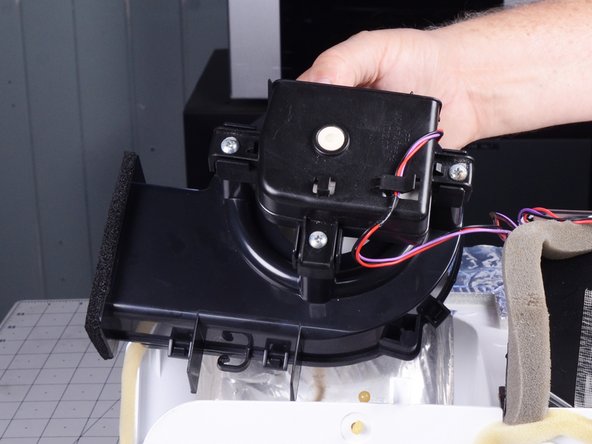

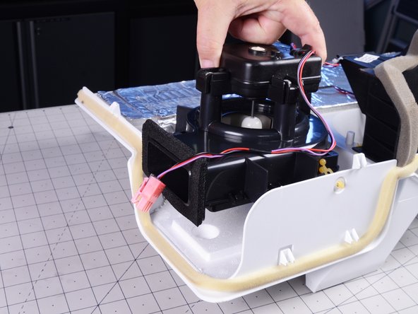

  24. LG Refrigerator LFX25973 Ice Maker Blower Assembly Replacement, Unfasten the ice maker blower: crwdns2935265:024crwdnd2935265:01crwdnd2935265:01crwdne2935265:0
    • Use a Phillips screwdriver to remove the four 18.6 mm‑long screws securing the ice maker blower to the evaporator cover.
  25. LG Refrigerator LFX25973 Ice Maker Blower Assembly Replacement, Remove the ice maker blower: crwdns2935265:025crwdnd2935265:01crwdnd2935265:03crwdne2935265:0 LG Refrigerator LFX25973 Ice Maker Blower Assembly Replacement, Remove the ice maker blower: crwdns2935265:025crwdnd2935265:02crwdnd2935265:03crwdne2935265:0 LG Refrigerator LFX25973 Ice Maker Blower Assembly Replacement, Remove the ice maker blower: crwdns2935265:025crwdnd2935265:03crwdnd2935265:03crwdne2935265:0
    • Lift the ice maker blower out of the evaporator cover and remove it.
