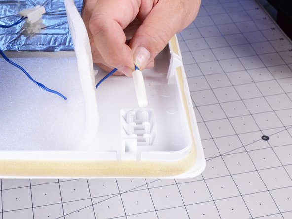

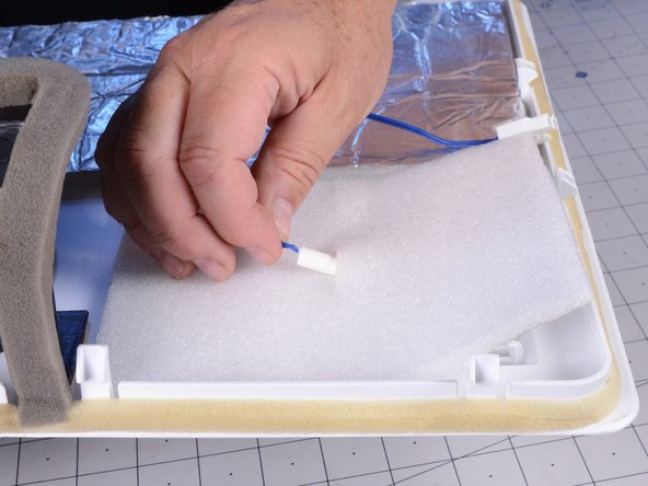

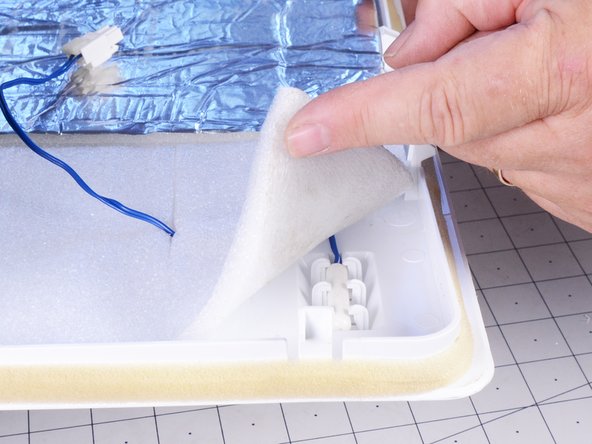

  24. LG Refrigerator LFX25973 Freezer Thermistor Test and Replacement, Peel up the insulation: crwdns2935265:024crwdnd2935265:01crwdnd2935265:02crwdne2935265:0 LG Refrigerator LFX25973 Freezer Thermistor Test and Replacement, Peel up the insulation: crwdns2935265:024crwdnd2935265:02crwdnd2935265:02crwdne2935265:0
    • On the rear of the evaporator cover, peel up the insulation pad covering the thermistor.
  25. LG Refrigerator LFX25973 Freezer Thermistor Test and Replacement, Remove the thermistor: crwdns2935265:025crwdnd2935265:01crwdnd2935265:03crwdne2935265:0 LG Refrigerator LFX25973 Freezer Thermistor Test and Replacement, Remove the thermistor: crwdns2935265:025crwdnd2935265:02crwdnd2935265:03crwdne2935265:0 LG Refrigerator LFX25973 Freezer Thermistor Test and Replacement, Remove the thermistor: crwdns2935265:025crwdnd2935265:03crwdnd2935265:03crwdne2935265:0
    • Use a spudger to pry the thermistor out of its mounting clips.
    • Thread the thermistor through the slot in the insulation pad and remove it.
