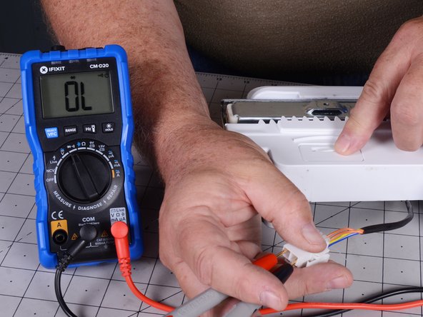

  12. LG Refrigerator LFX25973 Freezer Drawer Switch Testing and Replacement, Test the door switch: crwdns2935265:012crwdnd2935265:01crwdnd2935265:02crwdne2935265:0 LG Refrigerator LFX25973 Freezer Drawer Switch Testing and Replacement, Test the door switch: crwdns2935265:012crwdnd2935265:02crwdnd2935265:02crwdne2935265:0
    • If you have a multimeter, you can test the freezer door switch for continuity.
    • Set the multimeter to the ohm setting.
    • Check continuity between the two orange wire terminals on the connector.
    • The switch should show less than one ohm resistance in the unpressed position.
    • When pressed, the switch should show no connection.
    • If your switch does not function as described above, follow the next steps to remove and replace it.

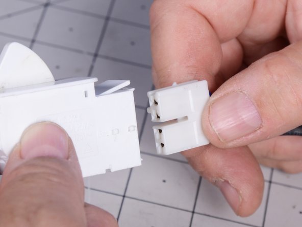

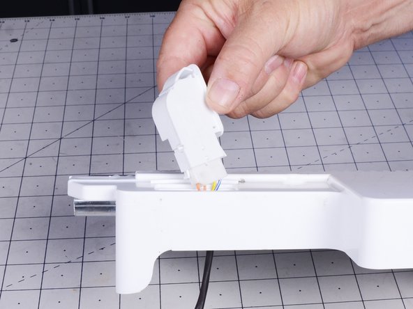

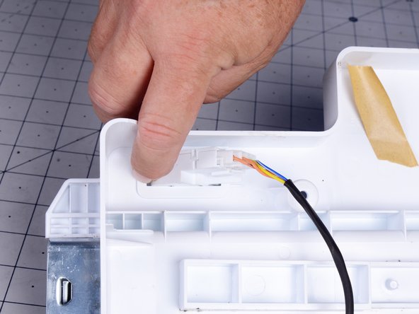

  13. LG Refrigerator LFX25973 Freezer Drawer Switch Testing and Replacement, Remove the door switch: crwdns2935265:013crwdnd2935265:01crwdnd2935265:03crwdne2935265:0 LG Refrigerator LFX25973 Freezer Drawer Switch Testing and Replacement, Remove the door switch: crwdns2935265:013crwdnd2935265:02crwdnd2935265:03crwdne2935265:0 LG Refrigerator LFX25973 Freezer Drawer Switch Testing and Replacement, Remove the door switch: crwdns2935265:013crwdnd2935265:03crwdnd2935265:03crwdne2935265:0
    • Press the retaining tab on the switch to release it from the drawer slide assembly.
    • When it is released, push the switch down through the mounting cutout.
    • Remove the switch from the drawer slide assembly.

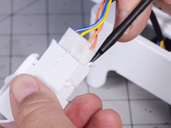

  14. LG Refrigerator LFX25973 Freezer Drawer Switch Testing and Replacement, Release the wiring from the door switch: crwdns2935265:014crwdnd2935265:01crwdnd2935265:02crwdne2935265:0 LG Refrigerator LFX25973 Freezer Drawer Switch Testing and Replacement, Release the wiring from the door switch: crwdns2935265:014crwdnd2935265:02crwdnd2935265:02crwdne2935265:0
    • Use a spudger to release the two clips that secure the wiring connector to the door switch.
  15. LG Refrigerator LFX25973 Freezer Drawer Switch Testing and Replacement, Disconnect the wiring harness from the drawer switch: crwdns2935265:015crwdnd2935265:01crwdnd2935265:02crwdne2935265:0 LG Refrigerator LFX25973 Freezer Drawer Switch Testing and Replacement, Disconnect the wiring harness from the drawer switch: crwdns2935265:015crwdnd2935265:02crwdnd2935265:02crwdne2935265:0
    • Pull the connector straight off the drawer switch to disconnect it.
    • Disconnecting this connector may require considerable force.
