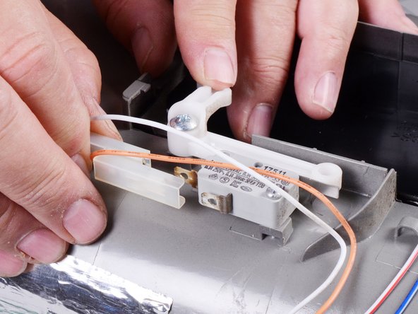

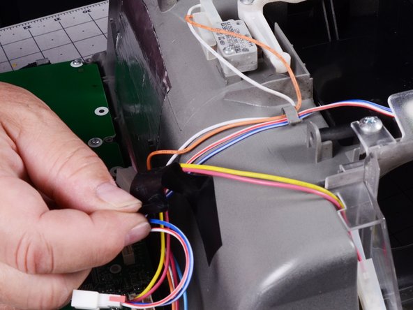

  12. LG Refrigerator LFX25973 Display Board Replacement, Release the ice dispensing switch wires: crwdns2935265:012crwdnd2935265:01crwdnd2935265:02crwdne2935265:0 LG Refrigerator LFX25973 Display Board Replacement, Release the ice dispensing switch wires: crwdns2935265:012crwdnd2935265:02crwdnd2935265:02crwdne2935265:0
    • Remove the tape securing wires to the rear of the dispenser assembly.
  13. LG Refrigerator LFX25973 Display Board Replacement: crwdns2935265:013crwdnd2935265:01crwdnd2935265:02crwdne2935265:0 LG Refrigerator LFX25973 Display Board Replacement: crwdns2935265:013crwdnd2935265:02crwdnd2935265:02crwdne2935265:0

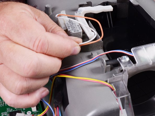

    • Remove the orange and white wires from the clip.
  14. LG Refrigerator LFX25973 Display Board Replacement, Disconnect the ice dispensing switch: crwdns2935265:014crwdnd2935265:01crwdnd2935265:02crwdne2935265:0 LG Refrigerator LFX25973 Display Board Replacement, Disconnect the ice dispensing switch: crwdns2935265:014crwdnd2935265:02crwdnd2935265:02crwdne2935265:0
    • Pull the orange and white connector from the ice dispensing switch to disconnect it.

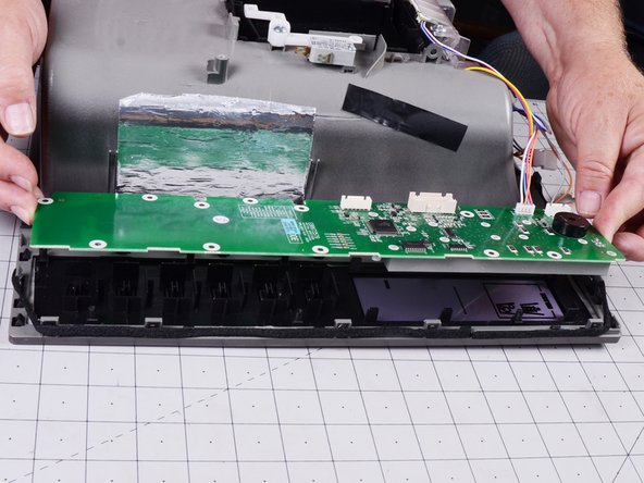

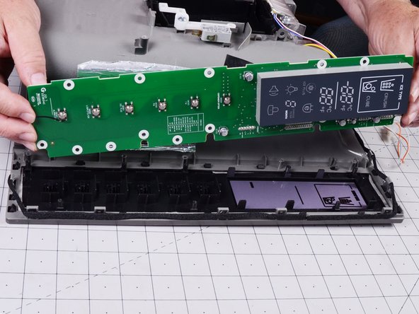

  15. LG Refrigerator LFX25973 Display Board Replacement, Unfasten the display board: crwdns2935265:015crwdnd2935265:01crwdnd2935265:01crwdne2935265:0
    • Use a Phillips driver to remove the eight 8 mm‑long screws securing the display board to the dispenser assembly.
  16. LG Refrigerator LFX25973 Display Board Replacement, Remove the display board: crwdns2935265:016crwdnd2935265:01crwdnd2935265:03crwdne2935265:0 LG Refrigerator LFX25973 Display Board Replacement, Remove the display board: crwdns2935265:016crwdnd2935265:02crwdnd2935265:03crwdne2935265:0 LG Refrigerator LFX25973 Display Board Replacement, Remove the display board: crwdns2935265:016crwdnd2935265:03crwdnd2935265:03crwdne2935265:0
    • Lift the display board off and remove it.
