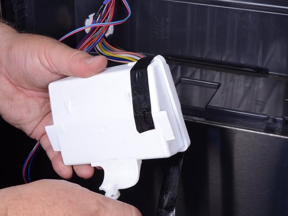

  12. LG Refrigerator LFX25973 Dispenser PC Board Replacement, Remove the tape: crwdns2935265:012crwdnd2935265:01crwdnd2935265:02crwdne2935265:0 LG Refrigerator LFX25973 Dispenser PC Board Replacement, Remove the tape: crwdns2935265:012crwdnd2935265:02crwdnd2935265:02crwdne2935265:0
    • Peel off the tape securing the cover of the circuit board holder.

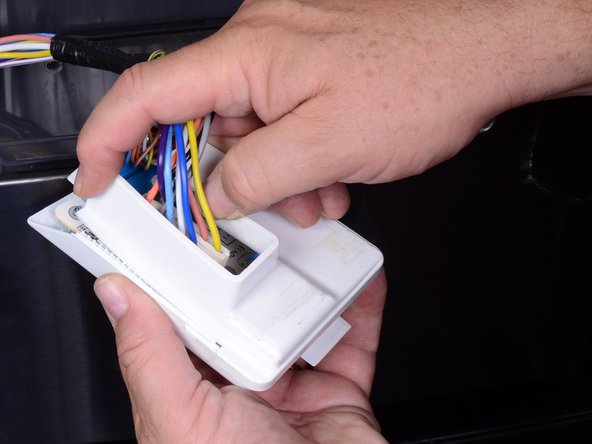

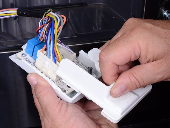

  13. LG Refrigerator LFX25973 Dispenser PC Board Replacement, Release the circuit board holder cover: crwdns2935265:013crwdnd2935265:01crwdnd2935265:03crwdne2935265:0 LG Refrigerator LFX25973 Dispenser PC Board Replacement, Release the circuit board holder cover: crwdns2935265:013crwdnd2935265:02crwdnd2935265:03crwdne2935265:0 LG Refrigerator LFX25973 Dispenser PC Board Replacement, Release the circuit board holder cover: crwdns2935265:013crwdnd2935265:03crwdnd2935265:03crwdne2935265:0
    • Push the wing of the circuit board holder cover toward the wires to release it.
    • Slide the circuit board holder cover off of the circuit board holder and remove it.

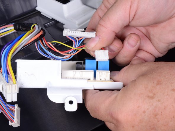

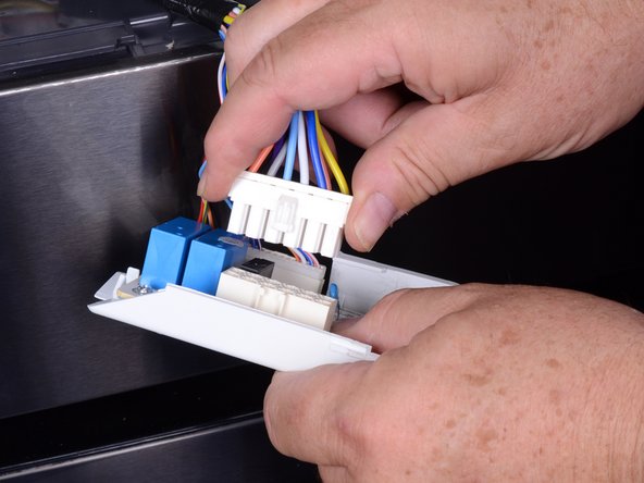

  14. LG Refrigerator LFX25973 Dispenser PC Board Replacement, Disconnect the dispenser PC board: crwdns2935265:014crwdnd2935265:01crwdnd2935265:02crwdne2935265:0 LG Refrigerator LFX25973 Dispenser PC Board Replacement, Disconnect the dispenser PC board: crwdns2935265:014crwdnd2935265:02crwdnd2935265:02crwdne2935265:0
    • Squeeze and pull the first of three connectors straight off to disconnect it from the circuit board.
  15. LG Refrigerator LFX25973 Dispenser PC Board Replacement: crwdns2935265:015crwdnd2935265:01crwdnd2935265:02crwdne2935265:0 LG Refrigerator LFX25973 Dispenser PC Board Replacement: crwdns2935265:015crwdnd2935265:02crwdnd2935265:02crwdne2935265:0
    • Continue removing the two remaining connectors.

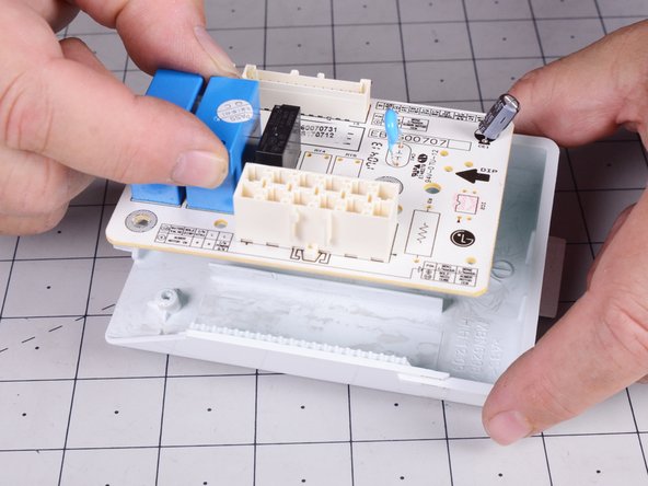

  16. LG Refrigerator LFX25973 Dispenser PC Board Replacement, Remove the dispenser PC board: crwdns2935265:016crwdnd2935265:01crwdnd2935265:02crwdne2935265:0 LG Refrigerator LFX25973 Dispenser PC Board Replacement, Remove the dispenser PC board: crwdns2935265:016crwdnd2935265:02crwdnd2935265:02crwdne2935265:0
    • Use a Philips screwdriver to remove the 10 mm screw securing the circuit board to the circuit board holder.
    • Lift off the circuit board and remove it.
