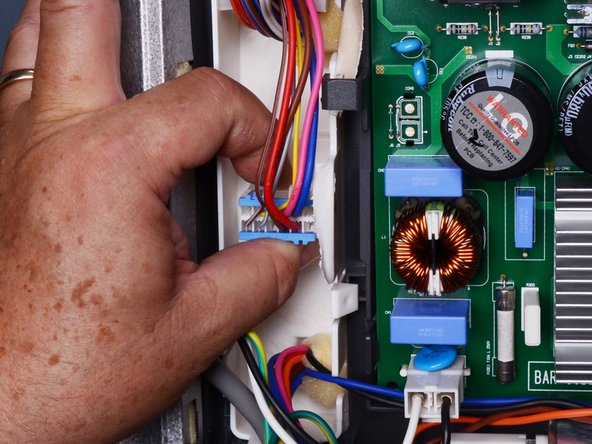

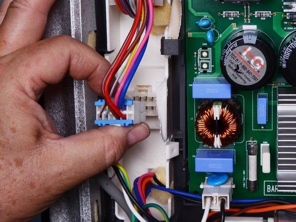

  4. LG Refrigerator Ice Auger Motor Run Capacitor Replacement, Disconnect the wiring harness: crwdns2935265:04crwdnd2935265:01crwdnd2935265:03crwdne2935265:0 LG Refrigerator Ice Auger Motor Run Capacitor Replacement, Disconnect the wiring harness: crwdns2935265:04crwdnd2935265:02crwdnd2935265:03crwdne2935265:0 LG Refrigerator Ice Auger Motor Run Capacitor Replacement, Disconnect the wiring harness: crwdns2935265:04crwdnd2935265:03crwdnd2935265:03crwdne2935265:0
    • Squeeze and pull the connectors to disconnect them:
    • Connectors from the control board
    • Connectors from the refrigerator
    • Some connectors can remain connected as the wires attached to them don't get in the way. There is no harm if they are disconnected. Remember to reconnect them if disconnected.

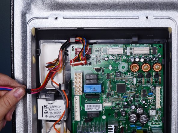

  5. LG Refrigerator Ice Auger Motor Run Capacitor Replacement, Reposition the wiring harness: crwdns2935265:05crwdnd2935265:01crwdnd2935265:02crwdne2935265:0 LG Refrigerator Ice Auger Motor Run Capacitor Replacement, Reposition the wiring harness: crwdns2935265:05crwdnd2935265:02crwdnd2935265:02crwdne2935265:0
    • Reposition the wiring harness away from the capacitor.

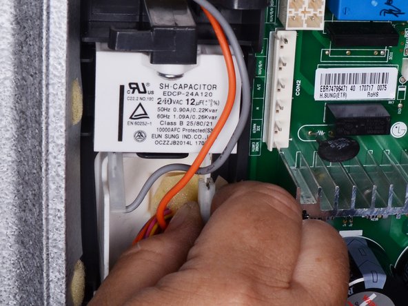

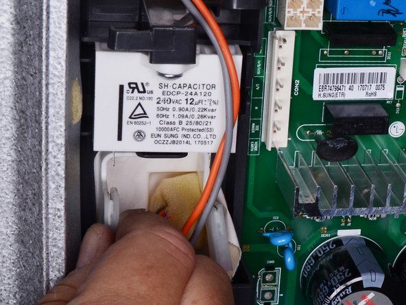

  6. LG Refrigerator Ice Auger Motor Run Capacitor Replacement, Disconnect the capacitor: crwdns2935265:06crwdnd2935265:01crwdnd2935265:03crwdne2935265:0 LG Refrigerator Ice Auger Motor Run Capacitor Replacement, Disconnect the capacitor: crwdns2935265:06crwdnd2935265:02crwdnd2935265:03crwdne2935265:0 LG Refrigerator Ice Auger Motor Run Capacitor Replacement, Disconnect the capacitor: crwdns2935265:06crwdnd2935265:03crwdnd2935265:03crwdne2935265:0
    • Pull the two connectors straight off the capacitor to disconnect it.
    • Handle the capacitor carefully as it may still be charged, and can give a dangerous and painful electrical shock. Avoid touching the terminals with your fingers or hands.
    • Information on capacitor safety.

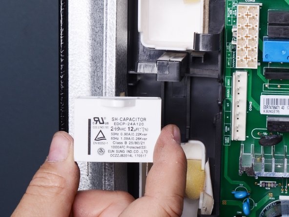

  7. LG Refrigerator Ice Auger Motor Run Capacitor Replacement, Remove the capacitor: crwdns2935265:07crwdnd2935265:01crwdnd2935265:02crwdne2935265:0 LG Refrigerator Ice Auger Motor Run Capacitor Replacement, Remove the capacitor: crwdns2935265:07crwdnd2935265:02crwdnd2935265:02crwdne2935265:0
    • Use a Phillips screwdriver to remove the screw securing the capacitor to the refrigerator.
    • Remove the capacitor.
