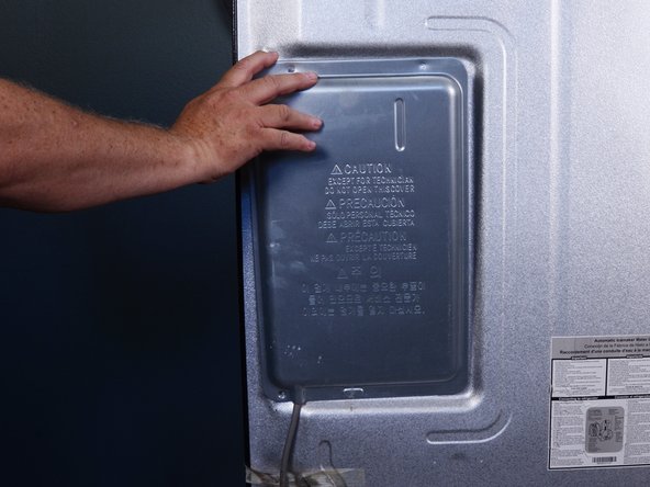

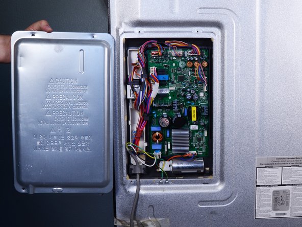

    1. LG Refrigerator Control Board Replacement, Unfasten the control board cover: crwdns2935265:02crwdnd2935265:01crwdnd2935265:01crwdne2935265:0
      • Use a Phillips screwdriver to remove the screws securing the control board cover.
    2. LG Refrigerator Control Board Replacement, Remove the control board cover: crwdns2935265:03crwdnd2935265:01crwdnd2935265:03crwdne2935265:0 LG Refrigerator Control Board Replacement, Remove the control board cover: crwdns2935265:03crwdnd2935265:02crwdnd2935265:03crwdne2935265:0 LG Refrigerator Control Board Replacement, Remove the control board cover: crwdns2935265:03crwdnd2935265:03crwdnd2935265:03crwdne2935265:0
      • Tilt the top edge of the cover toward you and lift it off.

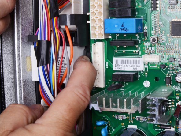

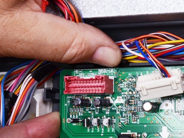

    1. LG Refrigerator Control Board Replacement, Disconnect the control board: crwdns2935265:04crwdnd2935265:01crwdnd2935265:03crwdne2935265:0 LG Refrigerator Control Board Replacement, Disconnect the control board: crwdns2935265:04crwdnd2935265:02crwdnd2935265:03crwdne2935265:0 LG Refrigerator Control Board Replacement, Disconnect the control board: crwdns2935265:04crwdnd2935265:03crwdnd2935265:03crwdne2935265:0
      • Note the position of each of the connectors, before disconnecting them. A photo is very valuable for keeping track, and taking several as you progress may be helpful.
      • Squeeze and pull the connectors to disconnect them from the control board.
      • Make sure to fully reconnect each connector when reassembling.

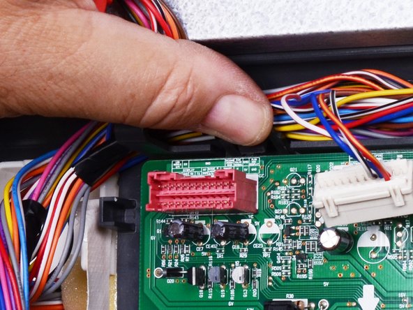

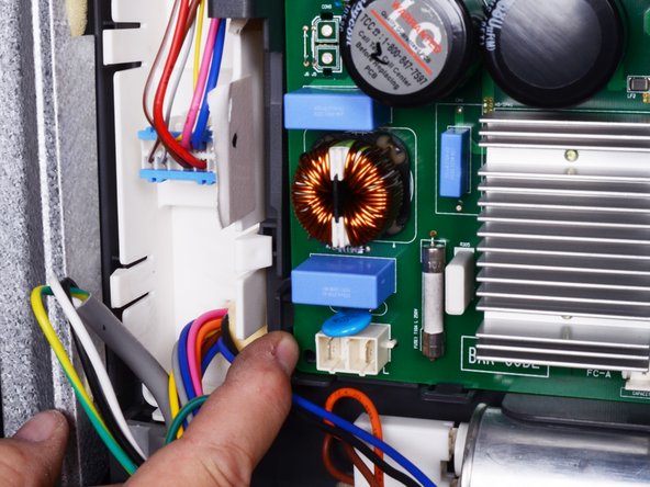

    2. LG Refrigerator Control Board Replacement, Release the control board: crwdns2935265:05crwdnd2935265:01crwdnd2935265:03crwdne2935265:0 LG Refrigerator Control Board Replacement, Release the control board: crwdns2935265:05crwdnd2935265:02crwdnd2935265:03crwdne2935265:0 LG Refrigerator Control Board Replacement, Release the control board: crwdns2935265:05crwdnd2935265:03crwdnd2935265:03crwdne2935265:0
      • Use your thumb to pry up and release the top left retaining clip securing the control board.
      • With your other hand, pull the top left corner of the control board out to loosen it.
    3. LG Refrigerator Control Board Replacement: crwdns2935265:06crwdnd2935265:01crwdnd2935265:03crwdne2935265:0 LG Refrigerator Control Board Replacement: crwdns2935265:06crwdnd2935265:02crwdnd2935265:03crwdne2935265:0 LG Refrigerator Control Board Replacement: crwdns2935265:06crwdnd2935265:03crwdnd2935265:03crwdne2935265:0
      • Repeat this process for each tab down the left edge of the control board as well as the top and bottom edges.
    4. LG Refrigerator Control Board Replacement, Remove the control board: crwdns2935265:07crwdnd2935265:01crwdnd2935265:01crwdne2935265:0
      • Lift the control board out by its edges and remove it.
