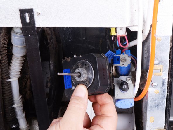

    5. LG Refrigerator Condenser Fan Motor Replacement, Remove the condenser fan motor: crwdns2935265:08crwdnd2935265:01crwdnd2935265:03crwdne2935265:0 LG Refrigerator Condenser Fan Motor Replacement, Remove the condenser fan motor: crwdns2935265:08crwdnd2935265:02crwdnd2935265:03crwdne2935265:0 LG Refrigerator Condenser Fan Motor Replacement, Remove the condenser fan motor: crwdns2935265:08crwdnd2935265:03crwdnd2935265:03crwdne2935265:0
      • Use a stubby Phillips screwdriver to remove the screws securing the fan motor inside the fan motor bracket.
      • You may find it easier to use a 1/4 inch drive socket with a Phillips head bit to remove the screws.
    6. LG Refrigerator Condenser Fan Motor Replacement, Remove the fan motor: crwdns2935265:09crwdnd2935265:01crwdnd2935265:03crwdne2935265:0 LG Refrigerator Condenser Fan Motor Replacement, Remove the fan motor: crwdns2935265:09crwdnd2935265:02crwdnd2935265:03crwdne2935265:0 LG Refrigerator Condenser Fan Motor Replacement, Remove the fan motor: crwdns2935265:09crwdnd2935265:03crwdnd2935265:03crwdne2935265:0
      • Push apart the two halves of the fan motor bracket to release the fan motor.
      • Slide the fan motor shaft up through the slot in the front fan motor bracket.
    7. LG Refrigerator Condenser Fan Motor Replacement: crwdns2935265:010crwdnd2935265:01crwdnd2935265:02crwdne2935265:0 LG Refrigerator Condenser Fan Motor Replacement: crwdns2935265:010crwdnd2935265:02crwdnd2935265:02crwdne2935265:0
      • Remove the fan motor.
    8. LG Refrigerator Condenser Fan Motor Replacement, Transfer the motor mounting washers: crwdns2935265:011crwdnd2935265:01crwdnd2935265:03crwdne2935265:0 LG Refrigerator Condenser Fan Motor Replacement, Transfer the motor mounting washers: crwdns2935265:011crwdnd2935265:02crwdnd2935265:03crwdne2935265:0 LG Refrigerator Condenser Fan Motor Replacement, Transfer the motor mounting washers: crwdns2935265:011crwdnd2935265:03crwdnd2935265:03crwdne2935265:0
      • Transfer the two rubber motor mounting washers from the old motor to the new motor.
