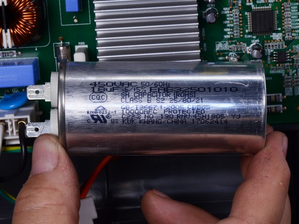

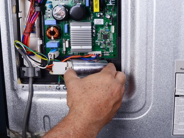

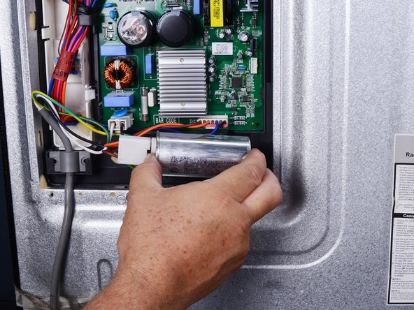

    1. LG Refrigerator Compressor Run Capacitor Replacement, Unclip the capacitor: crwdns2935265:04crwdnd2935265:01crwdnd2935265:03crwdne2935265:0 LG Refrigerator Compressor Run Capacitor Replacement, Unclip the capacitor: crwdns2935265:04crwdnd2935265:02crwdnd2935265:03crwdne2935265:0 LG Refrigerator Compressor Run Capacitor Replacement, Unclip the capacitor: crwdns2935265:04crwdnd2935265:03crwdnd2935265:03crwdne2935265:0
      • Pull the left edge of the capacitor toward you to unclip it.
      • Handle the capacitor carefully as it may still be charged, and can give a dangerous and painful electrical shock. Avoid touching the terminals with your fingers or hands.
      • For information on capacitor safety, click here.

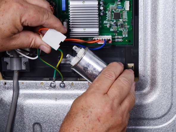

    2. LG Refrigerator Compressor Run Capacitor Replacement, Disconnect the capacitor: crwdns2935265:05crwdnd2935265:01crwdnd2935265:03crwdne2935265:0 LG Refrigerator Compressor Run Capacitor Replacement, Disconnect the capacitor: crwdns2935265:05crwdnd2935265:02crwdnd2935265:03crwdne2935265:0 LG Refrigerator Compressor Run Capacitor Replacement, Disconnect the capacitor: crwdns2935265:05crwdnd2935265:03crwdnd2935265:03crwdne2935265:0
      • Pull the connector straight off the capacitor to disconnect it.
      • Remove the capacitor.
