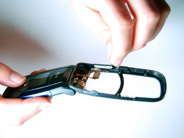

  4. LG LX150 Volume Toggle Replacement, Internal Back Cover: crwdns2935265:04crwdnd2935265:01crwdnd2935265:03crwdne2935265:0 LG LX150 Volume Toggle Replacement, Internal Back Cover: crwdns2935265:04crwdnd2935265:02crwdnd2935265:03crwdne2935265:0 LG LX150 Volume Toggle Replacement, Internal Back Cover: crwdns2935265:04crwdnd2935265:03crwdnd2935265:03crwdne2935265:0
    • Remove the 7 phillips screws indicated by the red arrows using the phillips #0 screwdriver.
    • Insert the flat end of the spudger in-between the black and blue phone casing on the side of the phone and split the the blue and black apart. Work your way around the perimeter of the cover, loosening all corners.

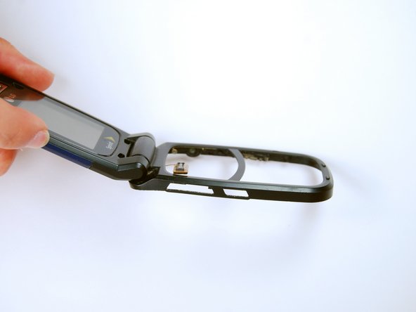

  5. LG LX150 Volume Toggle Replacement: crwdns2935265:05crwdnd2935265:01crwdnd2935265:02crwdne2935265:0 LG LX150 Volume Toggle Replacement: crwdns2935265:05crwdnd2935265:02crwdnd2935265:02crwdne2935265:0
    • Remove the internal back cover after loosening all the corners.
    • The second picture below is what you will see after removing the internal back cover.
  6. LG LX150 Volume Toggle Replacement, Volume Toggle: crwdns2935265:06crwdnd2935265:01crwdnd2935265:03crwdne2935265:0 LG LX150 Volume Toggle Replacement, Volume Toggle: crwdns2935265:06crwdnd2935265:02crwdnd2935265:03crwdne2935265:0 LG LX150 Volume Toggle Replacement, Volume Toggle: crwdns2935265:06crwdnd2935265:03crwdnd2935265:03crwdne2935265:0
    • To remove the volume toggle button, use the spudger to push the original button out of its socket.
    • After loosening the volume toggle button from its socket, finish pulling it out with your fingers.
    • The demonstration pictures show the motherboard removed; however, this is not necessary to replace the volume toggle.
