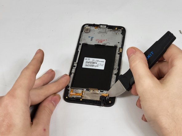

    1. LG Grace Screen Replacement, Screen: crwdns2935265:09crwdnd2935265:01crwdnd2935265:02crwdne2935265:0 LG Grace Screen Replacement, Screen: crwdns2935265:09crwdnd2935265:02crwdnd2935265:02crwdne2935265:0
      • Now we remove the audio jack. Place something long and thin in the jack and pry up to remove it from it's seating.
      • Use the Jimmy to slide under the connection to the screen assembly and pry it up and away.
