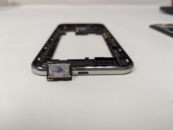

  5. LG Grace Rear Speaker Replacement, Rear Speaker: crwdns2935265:05crwdnd2935265:01crwdnd2935265:02crwdne2935265:0 LG Grace Rear Speaker Replacement, Rear Speaker: crwdns2935265:05crwdnd2935265:02crwdnd2935265:02crwdne2935265:0
    • The speaker is located on the plate you pulled away in initial disassembly, not connected to the mother board.
    • Place Jimmy against the edge of the speaker and gently pry out, there are no solder connections holding it in place.
    • When inserting a new speaker, the orientation matters. It will click into place if it's correct, otherwise it will just fall out of the seating.
