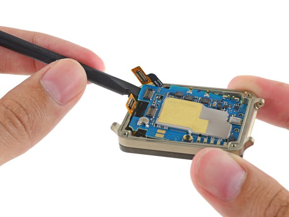

    • This watch splits apart very similarly to the Gear Live:
    • Rear half has the battery, vibrator, and some other fidgety doodads
    • Front half has the main board and display
    • First treasure extracted: a springy metal retaining clip that secures the battery. It also hosts a chunk of rubber that that connects the reset button to the microswitch on the motherboard.
    • Next victim: the vibrator. This particular unit connects via simple spring contacts, unlike the soldered-to-a-board-connected-to-the-main-board approach the Gear Live utilizes.

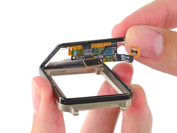

    • Thanks to the spring contacts between the two halves of the LG G, we need only dispatch two connectors: display data and digitizer cables. They're easily released with our handy spudger.
    • Just as easily, the motherboard is popped up out of the hefty metal bezel securing the display assembly.

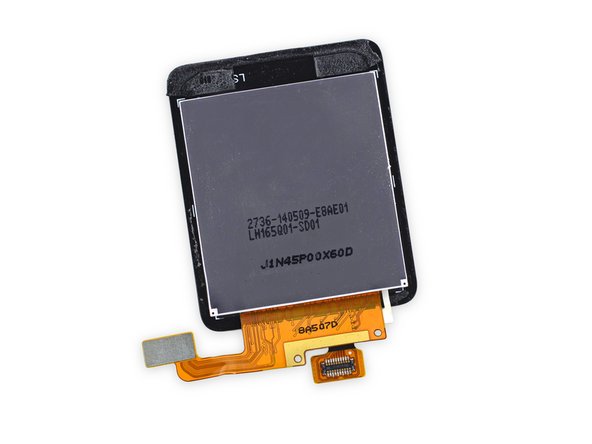

    • We're gonna need some heat to separate the display glass from the metal bezel, so it looks like it's time to drop an iOpener on our G-unit.
    • We like to drop it like it's hot.
  13. LG G Watch Teardown: crwdns2935265:014crwdnd2935265:01crwdnd2935265:03crwdne2935265:0 LG G Watch Teardown: crwdns2935265:014crwdnd2935265:02crwdnd2935265:03crwdne2935265:0 LG G Watch Teardown: crwdns2935265:014crwdnd2935265:03crwdnd2935265:03crwdne2935265:0
    • After three solid minutes of watching the video in the previous step, and congratulating each other on its fabulous humor (while the iOpener did its thing), the display adhesive is soft enough to relinquish its grip.
    • A little gentle pressure from the back of the LCD gives our opening pick just the edge it needs to sneak in and separate the display from the watch bezel.
  14. LG G Watch Teardown: crwdns2935265:015crwdnd2935265:01crwdnd2935265:02crwdne2935265:0 LG G Watch Teardown: crwdns2935265:015crwdnd2935265:02crwdnd2935265:02crwdne2935265:0
