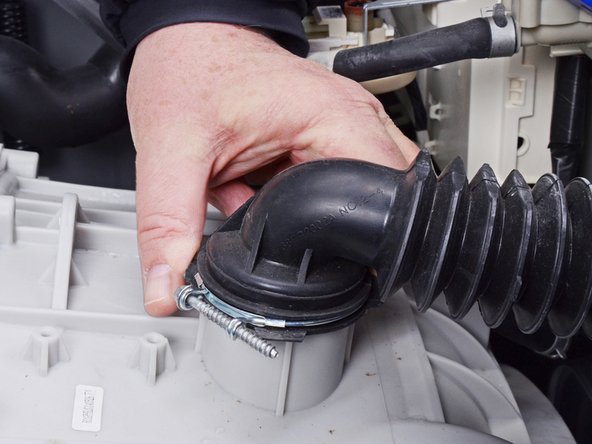

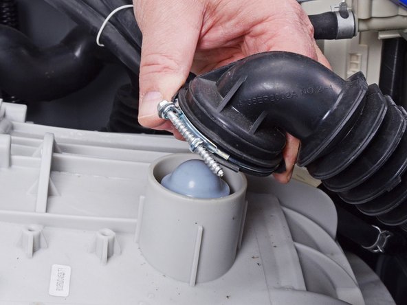

  15. LG Front Load Washing Machine Vent Valve Plunger Replacement, Reposition the vent hose: crwdns2935265:015crwdnd2935265:01crwdnd2935265:03crwdne2935265:0 LG Front Load Washing Machine Vent Valve Plunger Replacement, Reposition the vent hose: crwdns2935265:015crwdnd2935265:02crwdnd2935265:03crwdne2935265:0 LG Front Load Washing Machine Vent Valve Plunger Replacement, Reposition the vent hose: crwdns2935265:015crwdnd2935265:03crwdnd2935265:03crwdne2935265:0
    • Loosen the fastener securing the vent hose.
    • Lift the vent hose straight off the drum to expose the vent valve plunger.

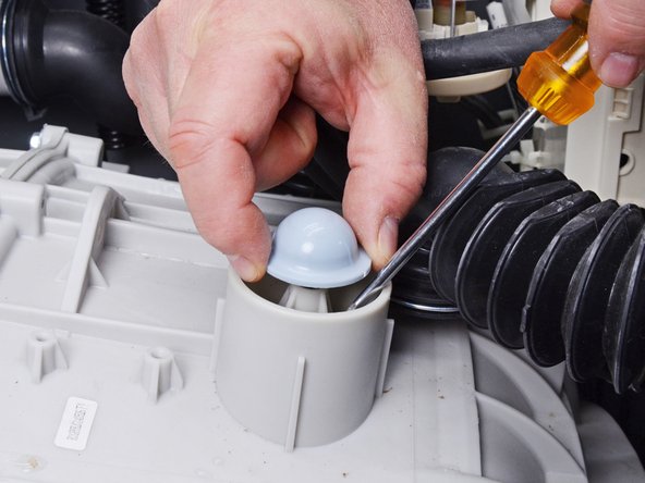

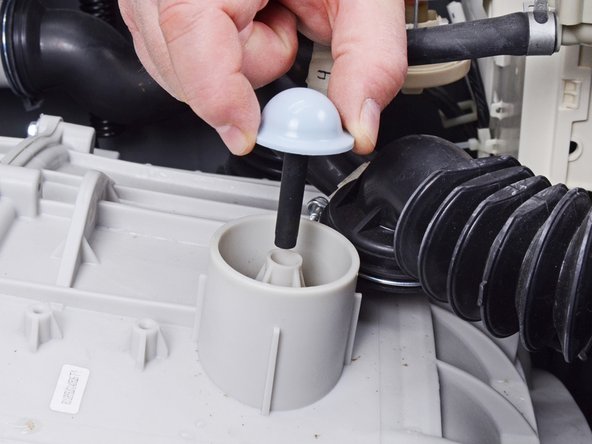

  16. LG Front Load Washing Machine Vent Valve Plunger Replacement, Remove the vent valve plunger: crwdns2935265:016crwdnd2935265:01crwdnd2935265:03crwdne2935265:0 LG Front Load Washing Machine Vent Valve Plunger Replacement, Remove the vent valve plunger: crwdns2935265:016crwdnd2935265:02crwdnd2935265:03crwdne2935265:0 LG Front Load Washing Machine Vent Valve Plunger Replacement, Remove the vent valve plunger: crwdns2935265:016crwdnd2935265:03crwdnd2935265:03crwdne2935265:0
    • Use two flathead screwdrivers, or similar tools, to pry the vent valve plunger up enough to grip it with your fingers.
    • Pull the plunger straight up to remove it.
