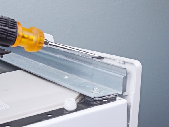

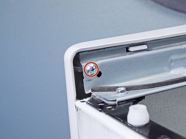

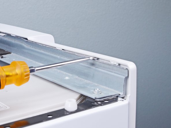

    1. LG Front Load Washing Machine Temperature Sensor Replacement, Unfasten the top panel: crwdns2935265:02crwdnd2935265:01crwdnd2935265:03crwdne2935265:0 LG Front Load Washing Machine Temperature Sensor Replacement, Unfasten the top panel: crwdns2935265:02crwdnd2935265:02crwdnd2935265:03crwdne2935265:0 LG Front Load Washing Machine Temperature Sensor Replacement, Unfasten the top panel: crwdns2935265:02crwdnd2935265:03crwdnd2935265:03crwdne2935265:0
      • Remove the screw(s) securing the top panel brackets to the back panel.
      • You don't need to remove the screws securing the brackets to the top panel.

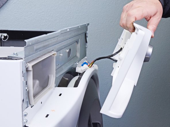

    2. LG Front Load Washing Machine Temperature Sensor Replacement, Remove the top panel: crwdns2935265:03crwdnd2935265:01crwdnd2935265:02crwdne2935265:0 LG Front Load Washing Machine Temperature Sensor Replacement, Remove the top panel: crwdns2935265:03crwdnd2935265:02crwdnd2935265:02crwdne2935265:0
      • Slide the top panel towards the rear of the device to disconnect its clips.
    3. LG Front Load Washing Machine Temperature Sensor Replacement: crwdns2935265:04crwdnd2935265:01crwdnd2935265:02crwdne2935265:0 LG Front Load Washing Machine Temperature Sensor Replacement: crwdns2935265:04crwdnd2935265:02crwdnd2935265:02crwdne2935265:0
      • Tilt the top panel upward to completely disconnect it from the chassis.
      • Remove the top panel.

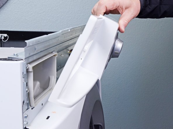

    1. LG Front Load Washing Machine Temperature Sensor Replacement, Remove the detergent drawer: crwdns2935265:05crwdnd2935265:01crwdnd2935265:02crwdne2935265:0 LG Front Load Washing Machine Temperature Sensor Replacement, Remove the detergent drawer: crwdns2935265:05crwdnd2935265:02crwdnd2935265:02crwdne2935265:0
      • Pull the detergent drawer away from the chassis as far as it will go.
    2. LG Front Load Washing Machine Temperature Sensor Replacement: crwdns2935265:06crwdnd2935265:01crwdnd2935265:03crwdne2935265:0 LG Front Load Washing Machine Temperature Sensor Replacement: crwdns2935265:06crwdnd2935265:02crwdnd2935265:03crwdne2935265:0 LG Front Load Washing Machine Temperature Sensor Replacement: crwdns2935265:06crwdnd2935265:03crwdnd2935265:03crwdne2935265:0
      • Press down on the "Push" button to disengage the clips securing the detergent drawer.
      • Pull the drawer out of its slot on the chassis and remove it.

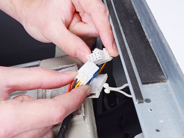

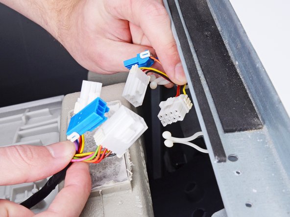

    1. LG Front Load Washing Machine Temperature Sensor Replacement, Disconnect the control panel: crwdns2935265:07crwdnd2935265:01crwdnd2935265:03crwdne2935265:0 LG Front Load Washing Machine Temperature Sensor Replacement, Disconnect the control panel: crwdns2935265:07crwdnd2935265:02crwdnd2935265:03crwdne2935265:0 LG Front Load Washing Machine Temperature Sensor Replacement, Disconnect the control panel: crwdns2935265:07crwdnd2935265:03crwdnd2935265:03crwdne2935265:0
      • Disconnect the connectors attached to the control panel.
      • Always grip cables by their connectors and not the wires themselves.

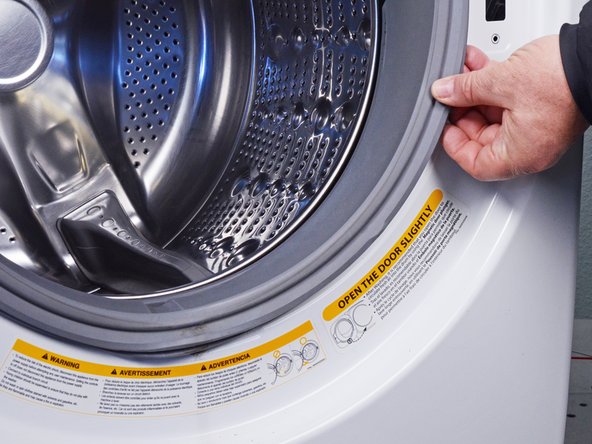

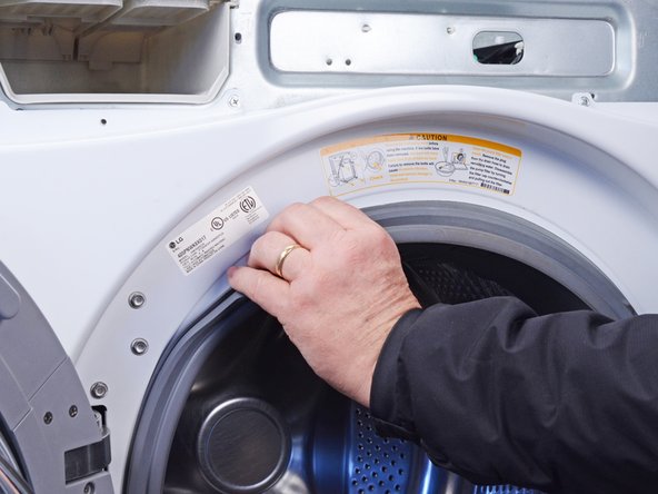

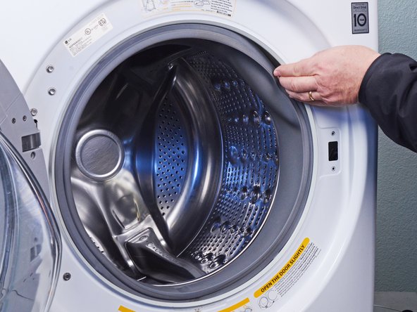

    1. LG Front Load Washing Machine Temperature Sensor Replacement, Open the door: crwdns2935265:012crwdnd2935265:01crwdnd2935265:02crwdne2935265:0 LG Front Load Washing Machine Temperature Sensor Replacement, Open the door: crwdns2935265:012crwdnd2935265:02crwdnd2935265:02crwdne2935265:0
      • Open the front door completely.
    2. LG Front Load Washing Machine Temperature Sensor Replacement, Remove the boot ring: crwdns2935265:013crwdnd2935265:01crwdnd2935265:03crwdne2935265:0 LG Front Load Washing Machine Temperature Sensor Replacement, Remove the boot ring: crwdns2935265:013crwdnd2935265:02crwdnd2935265:03crwdne2935265:0 LG Front Load Washing Machine Temperature Sensor Replacement, Remove the boot ring: crwdns2935265:013crwdnd2935265:03crwdnd2935265:03crwdne2935265:0
      • Use needle nose pliers to grip the spring end of the metal ring at the bottom of the rubber boot.
      • Pull the ring away from the chassis to separate it from the boot.
    3. LG Front Load Washing Machine Temperature Sensor Replacement: crwdns2935265:014crwdnd2935265:01crwdnd2935265:03crwdne2935265:0 LG Front Load Washing Machine Temperature Sensor Replacement: crwdns2935265:014crwdnd2935265:02crwdnd2935265:03crwdne2935265:0 LG Front Load Washing Machine Temperature Sensor Replacement: crwdns2935265:014crwdnd2935265:03crwdnd2935265:03crwdne2935265:0
      • Use your hand to completely pull the ring off the boot.
      • During reassembly, perform the following:
      • Insert one end of the ring into its groove along the boot's perimeter.
      • Use pliers to slowly stretch the ring around the boot's perimeter until it's completely nested in its groove.
      • Be sure the spring is centered at the bottom of the boot when you reinstall it.
      • This procedure will take significant force.
    4. LG Front Load Washing Machine Temperature Sensor Replacement, Disconnect the boot: crwdns2935265:015crwdnd2935265:01crwdnd2935265:03crwdne2935265:0 LG Front Load Washing Machine Temperature Sensor Replacement, Disconnect the boot: crwdns2935265:015crwdnd2935265:02crwdnd2935265:03crwdne2935265:0 LG Front Load Washing Machine Temperature Sensor Replacement, Disconnect the boot: crwdns2935265:015crwdnd2935265:03crwdnd2935265:03crwdne2935265:0
      • Use your fingers to pull the boot off its lip on the front panel.
    5. LG Front Load Washing Machine Temperature Sensor Replacement: crwdns2935265:016crwdnd2935265:01crwdnd2935265:03crwdne2935265:0 LG Front Load Washing Machine Temperature Sensor Replacement: crwdns2935265:016crwdnd2935265:02crwdnd2935265:03crwdne2935265:0 LG Front Load Washing Machine Temperature Sensor Replacement: crwdns2935265:016crwdnd2935265:03crwdnd2935265:03crwdne2935265:0
      • Slide your fingers around the lip of the boot until it's completely separated from the panel.

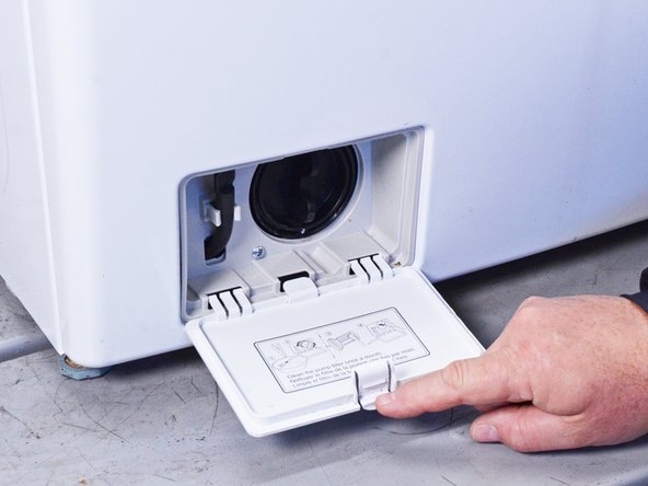

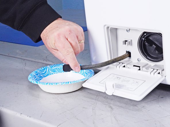

    6. LG Front Load Washing Machine Temperature Sensor Replacement, Remove the filter panel: crwdns2935265:017crwdnd2935265:01crwdnd2935265:03crwdne2935265:0 LG Front Load Washing Machine Temperature Sensor Replacement, Remove the filter panel: crwdns2935265:017crwdnd2935265:02crwdnd2935265:03crwdne2935265:0 LG Front Load Washing Machine Temperature Sensor Replacement, Remove the filter panel: crwdns2935265:017crwdnd2935265:03crwdnd2935265:03crwdne2935265:0
      • Open the filter panel at the bottom of the front panel.
      • Unclip the filter panel.

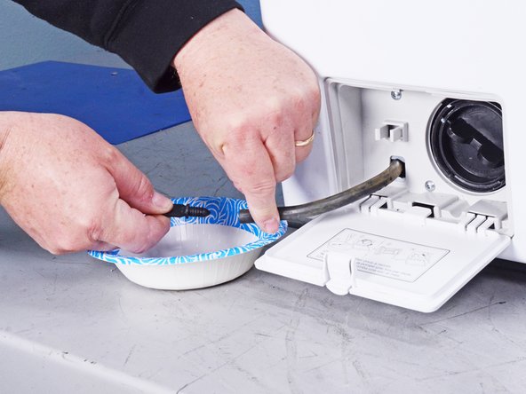

    7. LG Front Load Washing Machine Temperature Sensor Replacement, Drain the machine: crwdns2935265:018crwdnd2935265:01crwdnd2935265:03crwdne2935265:0 LG Front Load Washing Machine Temperature Sensor Replacement, Drain the machine: crwdns2935265:018crwdnd2935265:02crwdnd2935265:03crwdne2935265:0 LG Front Load Washing Machine Temperature Sensor Replacement, Drain the machine: crwdns2935265:018crwdnd2935265:03crwdnd2935265:03crwdne2935265:0
      • Generally, you should drain your machine when you are repairing the pumps or any hoses leading to or from them.
      • Place a bowl next to the machine.
      • Pull the drain filter hose out of its slot in the chassis enough to lay over the bowl.
      • Remove the plug at the end of the drain filter hose to release excess water into the bowl.
      • During reassembly, re-plug the drain filter hose and thread it back through its slot in the chassis.

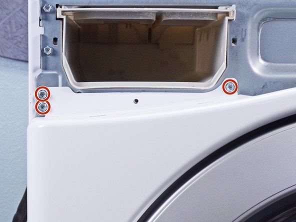

    10. LG Front Load Washing Machine Temperature Sensor Replacement, Unfasten the lower front panel: crwdns2935265:021crwdnd2935265:01crwdnd2935265:01crwdne2935265:0
      • Remove the screw(s) securing the lower front panel.

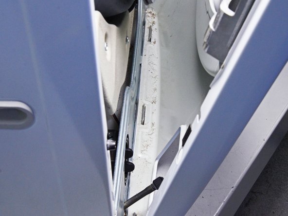

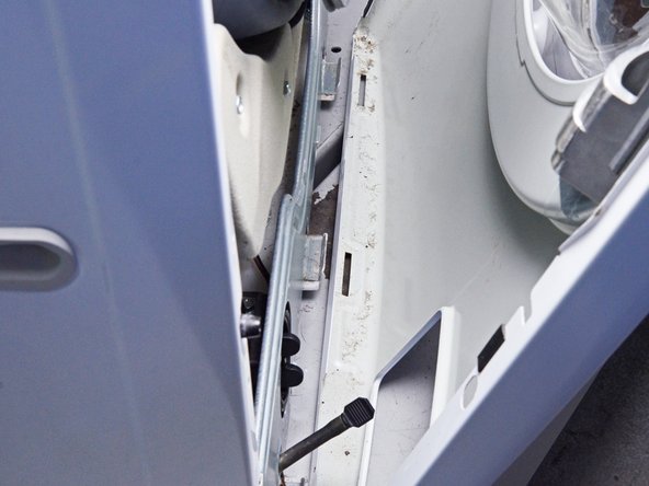

    13. LG Front Load Washing Machine Temperature Sensor Replacement, Unfasten the front panel: crwdns2935265:024crwdnd2935265:01crwdnd2935265:03crwdne2935265:0 LG Front Load Washing Machine Temperature Sensor Replacement, Unfasten the front panel: crwdns2935265:024crwdnd2935265:02crwdnd2935265:03crwdne2935265:0 LG Front Load Washing Machine Temperature Sensor Replacement, Unfasten the front panel: crwdns2935265:024crwdnd2935265:03crwdnd2935265:03crwdne2935265:0
      • Hold the front panel against the chassis while performing this step to prevent it from falling.
      • Remove the screw(s) securing the front panel.
    14. LG Front Load Washing Machine Temperature Sensor Replacement, Remove the front panel: crwdns2935265:025crwdnd2935265:01crwdnd2935265:03crwdne2935265:0 LG Front Load Washing Machine Temperature Sensor Replacement, Remove the front panel: crwdns2935265:025crwdnd2935265:02crwdnd2935265:03crwdne2935265:0 LG Front Load Washing Machine Temperature Sensor Replacement, Remove the front panel: crwdns2935265:025crwdnd2935265:03crwdnd2935265:03crwdne2935265:0
      • Lift the front panel upward to separate it from its clips on the bottom of the chassis.
      • Pull the front panel away from the chassis to completely separate the front panel.
    15. LG Front Load Washing Machine Temperature Sensor Replacement: crwdns2935265:026crwdnd2935265:01crwdnd2935265:01crwdne2935265:0
      • Remove the front panel.

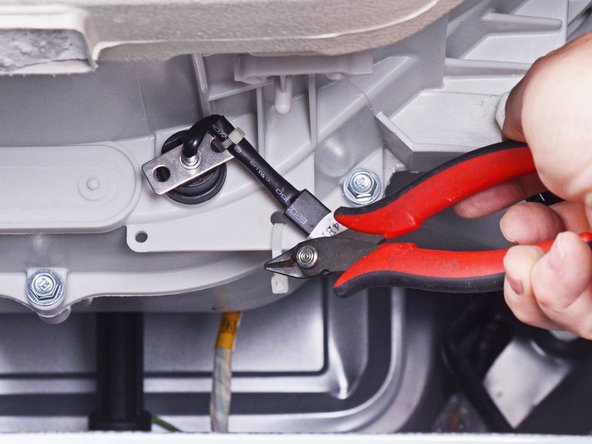

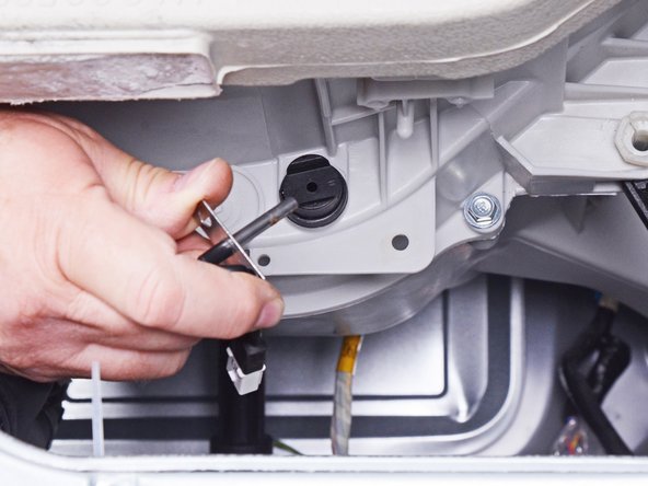

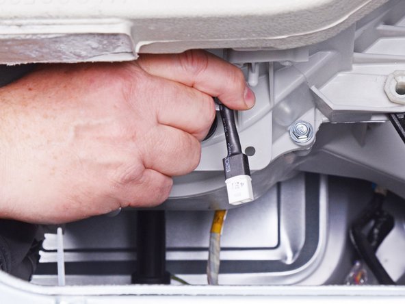

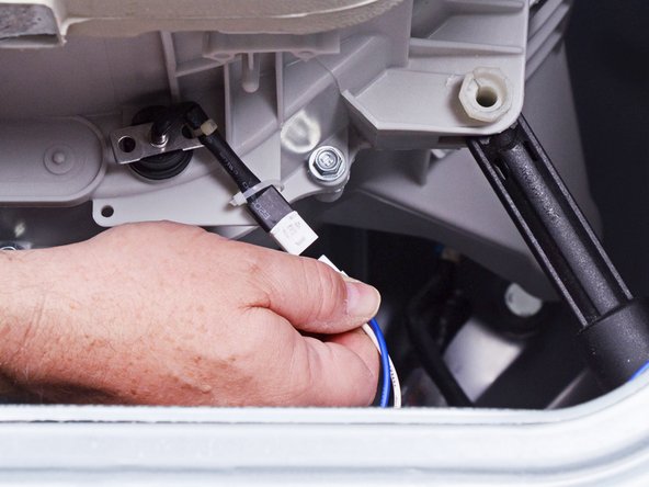

    1. LG Front Load Washing Machine Temperature Sensor Replacement, Disconnect the temperature sensor: crwdns2935265:027crwdnd2935265:01crwdnd2935265:02crwdne2935265:0 LG Front Load Washing Machine Temperature Sensor Replacement, Disconnect the temperature sensor: crwdns2935265:027crwdnd2935265:02crwdnd2935265:02crwdne2935265:0
      • Disconnect the temperature sensor attached to the chassis.
    2. LG Front Load Washing Machine Temperature Sensor Replacement, Cut the cable ties: crwdns2935265:028crwdnd2935265:01crwdnd2935265:02crwdne2935265:0 LG Front Load Washing Machine Temperature Sensor Replacement, Cut the cable ties: crwdns2935265:028crwdnd2935265:02crwdnd2935265:02crwdne2935265:0
      • If your device doesn't use cable ties to secure its thermistor, skip this step.
      • Use angle cutters, or scissors, to cut any cable ties securing the temperature sensor to the chassis.
    3. LG Front Load Washing Machine Temperature Sensor Replacement, Remove the temperature sensor: crwdns2935265:029crwdnd2935265:01crwdnd2935265:03crwdne2935265:0 LG Front Load Washing Machine Temperature Sensor Replacement, Remove the temperature sensor: crwdns2935265:029crwdnd2935265:02crwdnd2935265:03crwdne2935265:0 LG Front Load Washing Machine Temperature Sensor Replacement, Remove the temperature sensor: crwdns2935265:029crwdnd2935265:03crwdnd2935265:03crwdne2935265:0
      • Pull the temperature sensor straight out of its slot in the chassis to remove it.
