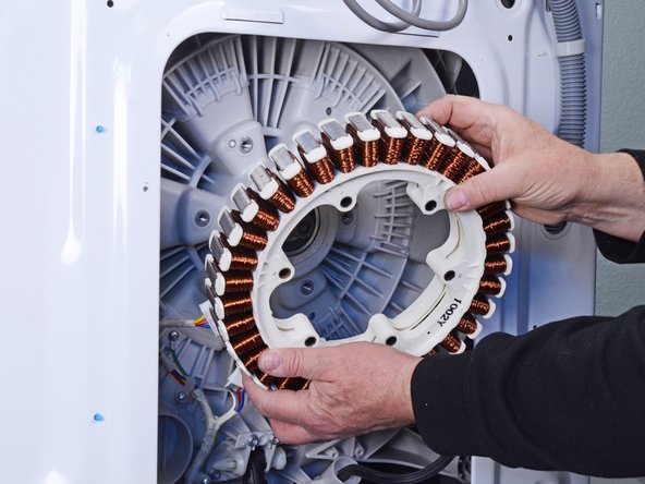

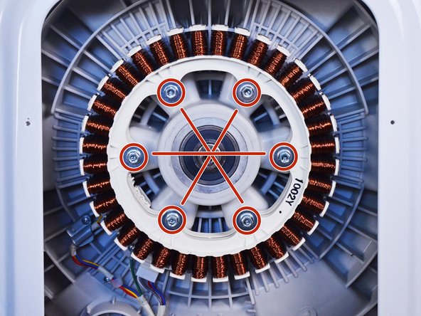

    2. LG Front Load Washing Machine Stator Replacement, Unfasten the stator: crwdns2935265:08crwdnd2935265:01crwdnd2935265:02crwdne2935265:0 LG Front Load Washing Machine Stator Replacement, Unfasten the stator: crwdns2935265:08crwdnd2935265:02crwdnd2935265:02crwdne2935265:0
      • Hold the stator up as you unfasten the last few bolts, as it can fall over unexpectedly.
      • Remove the bolts securing the stator.
      • During reassembly, refasten the screws in a "star" pattern.

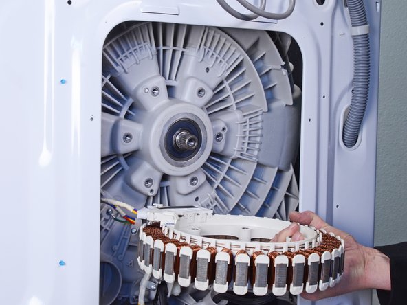

    3. LG Front Load Washing Machine Stator Replacement, Reposition the stator: crwdns2935265:09crwdnd2935265:01crwdnd2935265:03crwdne2935265:0 LG Front Load Washing Machine Stator Replacement, Reposition the stator: crwdns2935265:09crwdnd2935265:02crwdnd2935265:03crwdne2935265:0 LG Front Load Washing Machine Stator Replacement, Reposition the stator: crwdns2935265:09crwdnd2935265:03crwdnd2935265:03crwdne2935265:0
      • Don't pull the stator too far away from the device, as it's still connected by wires.
      • Pull the stator out of its slot on the drum, and flip it so its rear is facing upward.

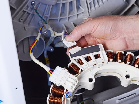

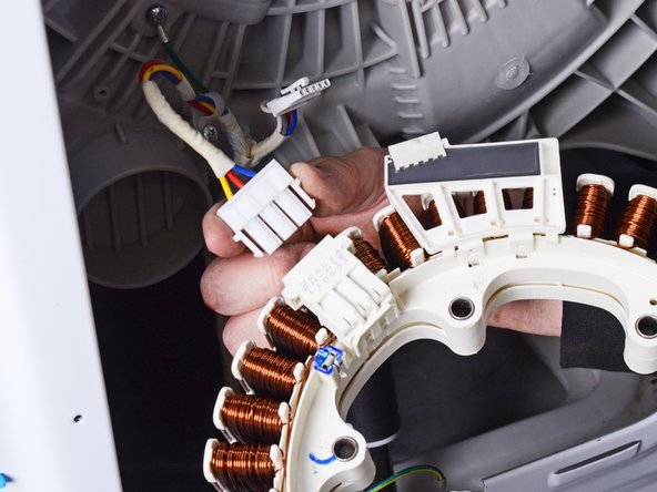

    4. LG Front Load Washing Machine Stator Replacement, Disconnect the stator: crwdns2935265:010crwdnd2935265:01crwdnd2935265:03crwdne2935265:0 LG Front Load Washing Machine Stator Replacement, Disconnect the stator: crwdns2935265:010crwdnd2935265:02crwdnd2935265:03crwdne2935265:0 LG Front Load Washing Machine Stator Replacement, Disconnect the stator: crwdns2935265:010crwdnd2935265:03crwdnd2935265:03crwdne2935265:0
      • Disconnect the connectors attached to the stator.
      • Always grip cables by their connectors and not the wires themselves.

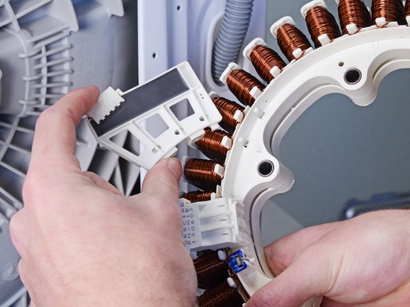

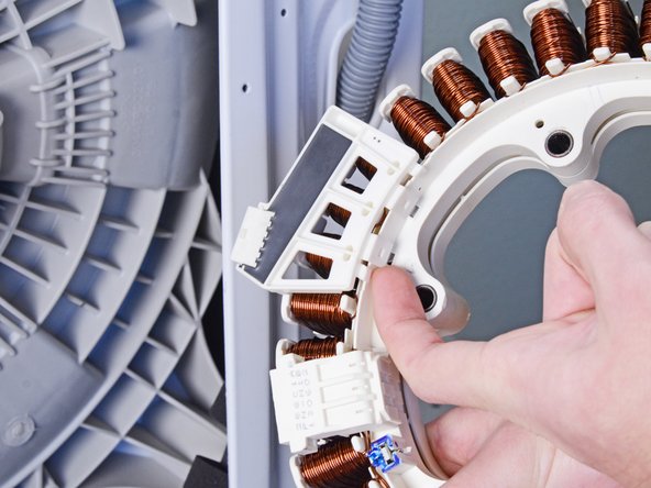

    5. LG Front Load Washing Machine Stator Replacement, Remove the rotor position sensor: crwdns2935265:011crwdnd2935265:01crwdnd2935265:03crwdne2935265:0 LG Front Load Washing Machine Stator Replacement, Remove the rotor position sensor: crwdns2935265:011crwdnd2935265:02crwdnd2935265:03crwdne2935265:0 LG Front Load Washing Machine Stator Replacement, Remove the rotor position sensor: crwdns2935265:011crwdnd2935265:03crwdnd2935265:03crwdne2935265:0
      • Use your fingers to unclip the rotor position sensor from the stator.
      • Pull the sensor away from the stator to completely unclip it.
      • Remove the rotor position sensor.
      • You're left with the stator.
