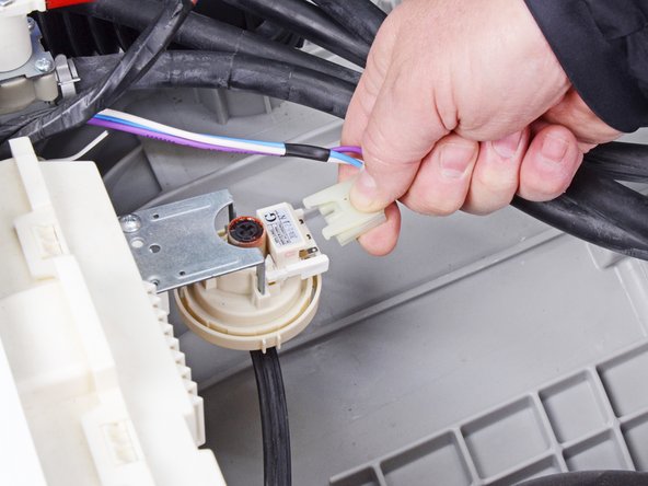

    1. LG Front Load Washing Machine Pressure Sensor Replacement, Disconnect the pressure sensor: crwdns2935265:05crwdnd2935265:01crwdnd2935265:02crwdne2935265:0 LG Front Load Washing Machine Pressure Sensor Replacement, Disconnect the pressure sensor: crwdns2935265:05crwdnd2935265:02crwdnd2935265:02crwdne2935265:0
      • Depending on your device, your pressure sensor might have a wire harness. If so, disconnect each wire on the harness.
      • Disconnect the connector from the pressure sensor.
      • Always grip cables by their connectors and not the wires themselves.

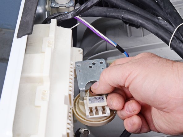

    2. LG Front Load Washing Machine Pressure Sensor Replacement: crwdns2935265:06crwdnd2935265:01crwdnd2935265:02crwdne2935265:0 LG Front Load Washing Machine Pressure Sensor Replacement: crwdns2935265:06crwdnd2935265:02crwdnd2935265:02crwdne2935265:0
      • Disconnect the hose from the pressure sensor.

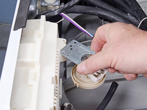

    3. LG Front Load Washing Machine Pressure Sensor Replacement, Unfasten the pressure sensor: crwdns2935265:07crwdnd2935265:01crwdnd2935265:01crwdne2935265:0
      • Remove the screw(s) securing the pressure sensor.

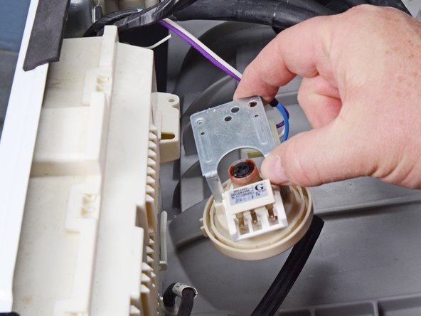

    4. LG Front Load Washing Machine Pressure Sensor Replacement, Remove the pressure sensor: crwdns2935265:08crwdnd2935265:01crwdnd2935265:03crwdne2935265:0 LG Front Load Washing Machine Pressure Sensor Replacement, Remove the pressure sensor: crwdns2935265:08crwdnd2935265:02crwdnd2935265:03crwdne2935265:0 LG Front Load Washing Machine Pressure Sensor Replacement, Remove the pressure sensor: crwdns2935265:08crwdnd2935265:03crwdnd2935265:03crwdne2935265:0
      • Unclip the pressure sensor from the chassis or other components.

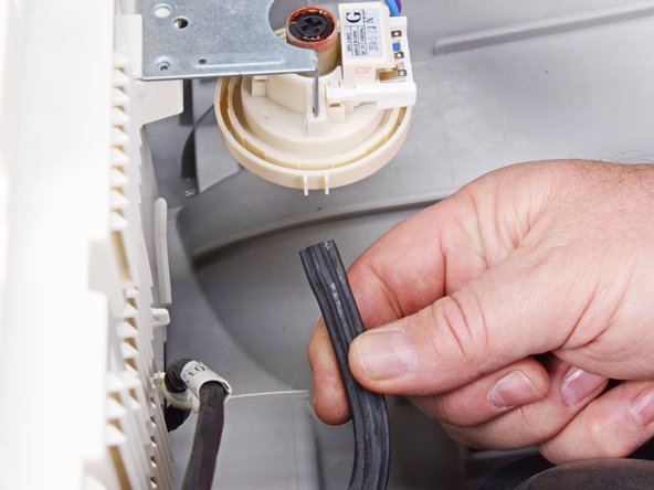

    5. LG Front Load Washing Machine Pressure Sensor Replacement: crwdns2935265:09crwdnd2935265:01crwdnd2935265:02crwdne2935265:0 LG Front Load Washing Machine Pressure Sensor Replacement: crwdns2935265:09crwdnd2935265:02crwdnd2935265:02crwdne2935265:0
      • Lift the pressure sensor away chassis and remove it.

Would this sensor also be responsible for an oe error. Drain line is clear and pump removes most of the water. The machine then continues to cycle through spin and drain with very little water coming out. When I remove the emergency drain line, it only has a couple cups of water in it.
Lg tromm front load washer.
Fred Becker - crwdns2934203:0crwdne2934203:0 crwdns2950251:0crwdne2950251:0
I am having the same problem and I think that is my issue but am not sure.
John Hughes - crwdns2934203:0crwdne2934203:0 crwdns2950251:0crwdne2950251:0
Hi Fred (and John), sorry for the long wait! Yes, that sensor could be responsible, but the tube is often plugged. The machine tries to pump itself out because the sensor is still getting a full signal from trapped air because of a clog in the tube that can act like a check valve. Sometimes, this pressure will bleed off over time, and the machine will stop trying to run a perennial drain cycle. Take a look at this part of the LG washing machine troubleshooting sheet. Even though it is for "no water," the same system is involved.
Bill Gilbert - crwdns2934203:0crwdne2934203:0 crwdns2950251:0crwdne2950251:0
I just wanted to say I have been battling my LG front loading washer for the better part of a week and couldn’t get that pesky OE code to go away. I replaced the drain pump motor and checked for clogs in all the hoses except for the hose to that water pressure sensor. This advice was an absolute godsend, thank you so much. I was getting very close to looking at a new machine. After opening it back up again and taking out that hose it turns out that was what the issue ended up being. Now my washing machine runs like new! thanks again!
