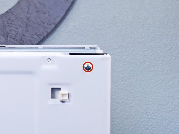

      • Remove the screw(s) securing the top panel brackets to the back panel.
      • You don't need to remove the screws securing the brackets to the top panel.

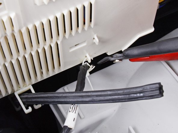

    1. LG Front Load Washing Machine Main Board Replacement, Disconnect the control panel cover: crwdns2935265:010crwdnd2935265:01crwdnd2935265:03crwdne2935265:0 LG Front Load Washing Machine Main Board Replacement, Disconnect the control panel cover: crwdns2935265:010crwdnd2935265:02crwdnd2935265:03crwdne2935265:0 LG Front Load Washing Machine Main Board Replacement, Disconnect the control panel cover: crwdns2935265:010crwdnd2935265:03crwdnd2935265:03crwdne2935265:0
      • Disconnect any cables or fasteners secured to the control panel cover.
      • Repeat this procedure for any bundled cables that keep the cover from opening.

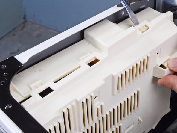

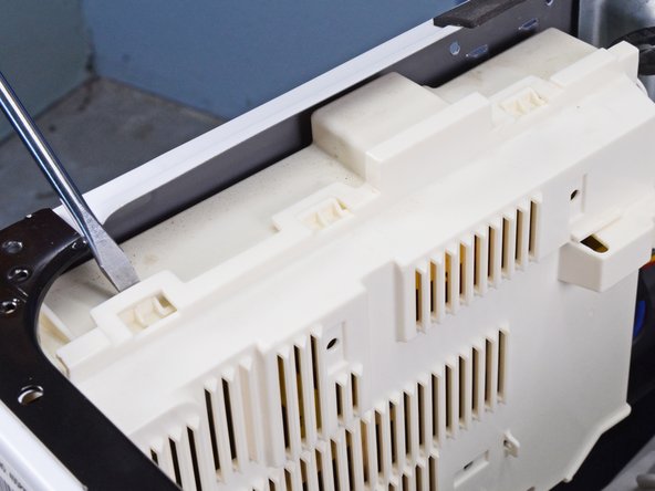

    2. LG Front Load Washing Machine Main Board Replacement, Remove the main board cover: crwdns2935265:011crwdnd2935265:01crwdnd2935265:03crwdne2935265:0 LG Front Load Washing Machine Main Board Replacement, Remove the main board cover: crwdns2935265:011crwdnd2935265:02crwdnd2935265:03crwdne2935265:0 LG Front Load Washing Machine Main Board Replacement, Remove the main board cover: crwdns2935265:011crwdnd2935265:03crwdnd2935265:03crwdne2935265:0
      • Use a flathead screwdriver or a prying tool, to unclip the main board cover.
      • Remove the main board cover.

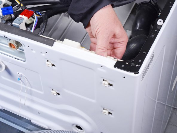

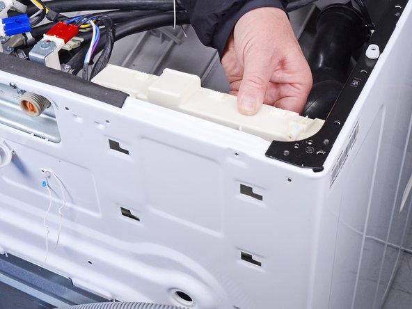

    3. LG Front Load Washing Machine Main Board Replacement, Unfasten the main board: crwdns2935265:012crwdnd2935265:01crwdnd2935265:02crwdne2935265:0 LG Front Load Washing Machine Main Board Replacement, Unfasten the main board: crwdns2935265:012crwdnd2935265:02crwdnd2935265:02crwdne2935265:0
      • Remove the screw(s) securing the main board to the back side of the washer.
    4. LG Front Load Washing Machine Main Board Replacement, Separate the main board from the chassis: crwdns2935265:013crwdnd2935265:01crwdnd2935265:03crwdne2935265:0 LG Front Load Washing Machine Main Board Replacement, Separate the main board from the chassis: crwdns2935265:013crwdnd2935265:02crwdnd2935265:03crwdne2935265:0 LG Front Load Washing Machine Main Board Replacement, Separate the main board from the chassis: crwdns2935265:013crwdnd2935265:03crwdnd2935265:03crwdne2935265:0
      • Slide the main board out of its slot in the chassis.

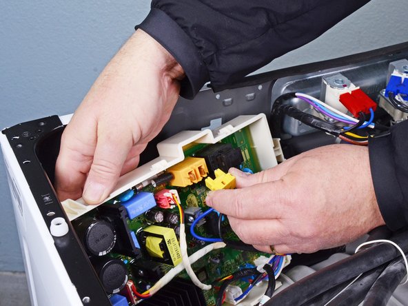

    5. LG Front Load Washing Machine Main Board Replacement, Remove the main board: crwdns2935265:014crwdnd2935265:01crwdnd2935265:03crwdne2935265:0 LG Front Load Washing Machine Main Board Replacement, Remove the main board: crwdns2935265:014crwdnd2935265:02crwdnd2935265:03crwdne2935265:0 LG Front Load Washing Machine Main Board Replacement, Remove the main board: crwdns2935265:014crwdnd2935265:03crwdnd2935265:03crwdne2935265:0

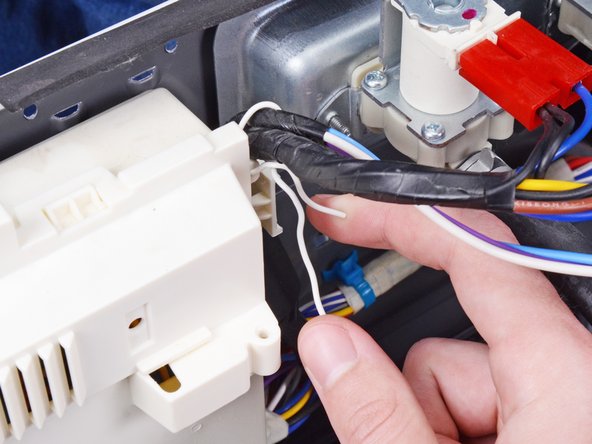

      • Label each connector and its spot on the main board. During reassembly, reattach each connector to its proper spot.
      • Lift the main board out of the chassis to access each of the connectors.
      • Disconnect each connector from the main board.
      • Remove the main board.
