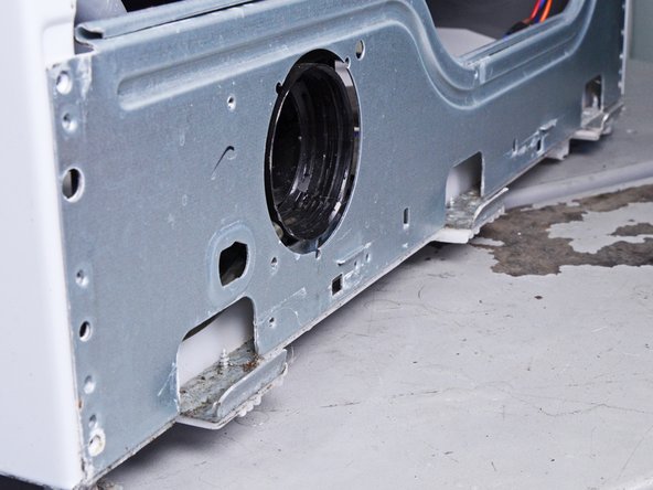

  25. LG Front Load Washing Machine Drain Pump Motor Replacement, Remove the front panel: crwdns2935265:025crwdnd2935265:01crwdnd2935265:03crwdne2935265:0 LG Front Load Washing Machine Drain Pump Motor Replacement, Remove the front panel: crwdns2935265:025crwdnd2935265:02crwdnd2935265:03crwdne2935265:0 LG Front Load Washing Machine Drain Pump Motor Replacement, Remove the front panel: crwdns2935265:025crwdnd2935265:03crwdnd2935265:03crwdne2935265:0
    • Lift the front panel upward to separate it from its clips on the bottom of the chassis.
    • Pull the front panel away from the chassis to completely separate the front panel.
  26. LG Front Load Washing Machine Drain Pump Motor Replacement: crwdns2935265:026crwdnd2935265:01crwdnd2935265:01crwdne2935265:0
    • Remove the front panel.

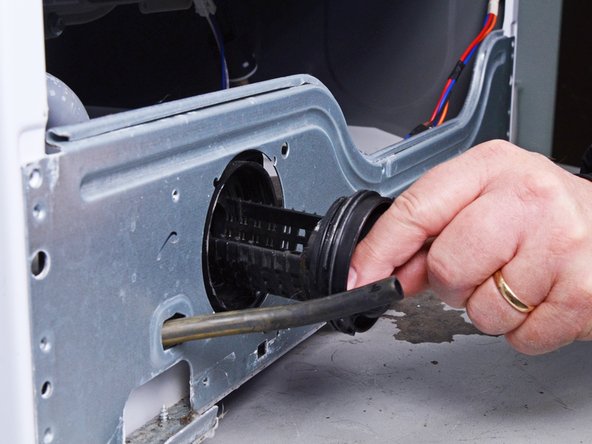

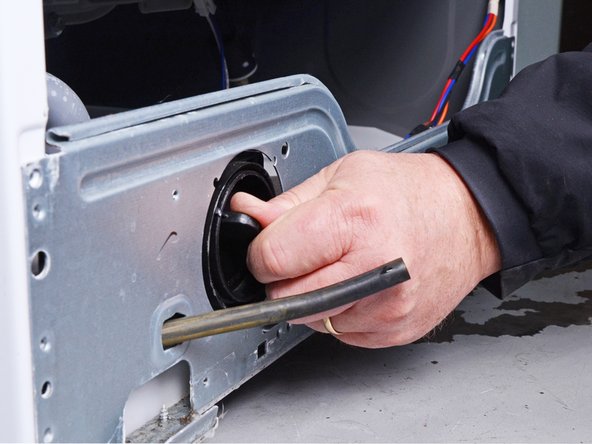

  27. LG Front Load Washing Machine Drain Pump Motor Replacement, Remove the pump filter: crwdns2935265:027crwdnd2935265:01crwdnd2935265:03crwdne2935265:0 LG Front Load Washing Machine Drain Pump Motor Replacement, Remove the pump filter: crwdns2935265:027crwdnd2935265:02crwdnd2935265:03crwdne2935265:0 LG Front Load Washing Machine Drain Pump Motor Replacement, Remove the pump filter: crwdns2935265:027crwdnd2935265:03crwdnd2935265:03crwdne2935265:0
    • Twist and remove the pump filter.

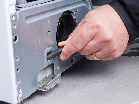

  28. LG Front Load Washing Machine Drain Pump Motor Replacement, Reposition the drain hose: crwdns2935265:028crwdnd2935265:01crwdnd2935265:03crwdne2935265:0 LG Front Load Washing Machine Drain Pump Motor Replacement, Reposition the drain hose: crwdns2935265:028crwdnd2935265:02crwdnd2935265:03crwdne2935265:0 LG Front Load Washing Machine Drain Pump Motor Replacement, Reposition the drain hose: crwdns2935265:028crwdnd2935265:03crwdnd2935265:03crwdne2935265:0
    • Push the drain hose through its hole in the chassis until it's completely inside the device.

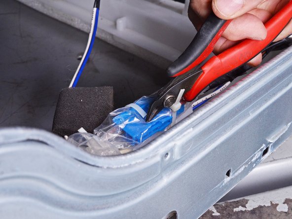

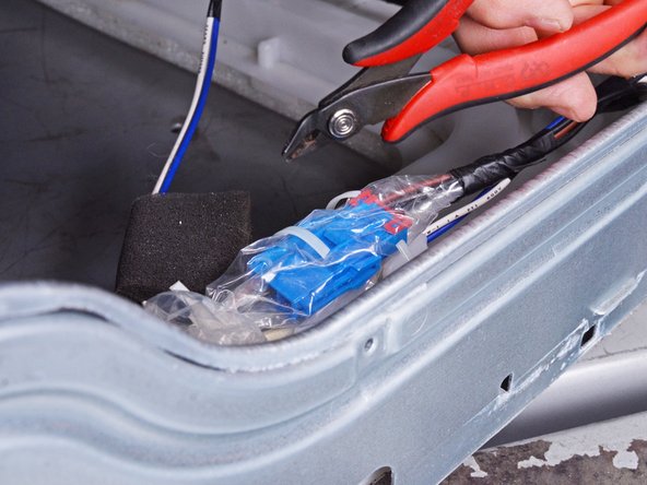

  29. LG Front Load Washing Machine Drain Pump Motor Replacement, Unwrap the pump assembly cables: crwdns2935265:029crwdnd2935265:01crwdnd2935265:03crwdne2935265:0 LG Front Load Washing Machine Drain Pump Motor Replacement, Unwrap the pump assembly cables: crwdns2935265:029crwdnd2935265:02crwdnd2935265:03crwdne2935265:0 LG Front Load Washing Machine Drain Pump Motor Replacement, Unwrap the pump assembly cables: crwdns2935265:029crwdnd2935265:03crwdnd2935265:03crwdne2935265:0
    • Use diagonal cutters, or scissors, to remove any cable ties securing the plastic wrap on the pump assembly cable connector(s).

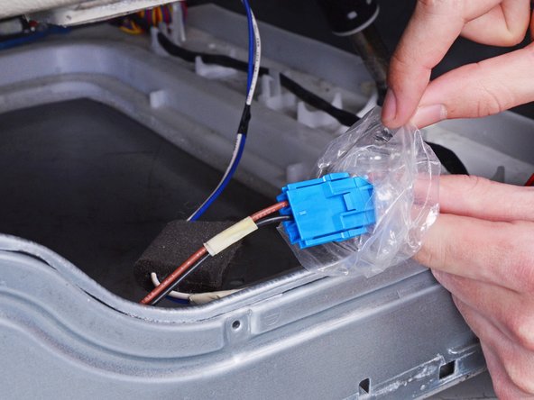

  30. LG Front Load Washing Machine Drain Pump Motor Replacement: crwdns2935265:030crwdnd2935265:01crwdnd2935265:02crwdne2935265:0 LG Front Load Washing Machine Drain Pump Motor Replacement: crwdns2935265:030crwdnd2935265:02crwdnd2935265:02crwdne2935265:0
    • Fold the plastic wrap away from the cables, enough to expose the connector(s).
    • During reassembly, replace the cable ties to ensure a water-tight fit for the plastic wrap.

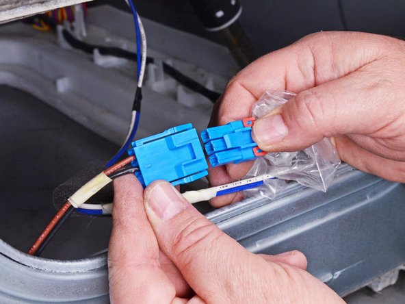

  31. LG Front Load Washing Machine Drain Pump Motor Replacement, Disconnect the pump cable: crwdns2935265:031crwdnd2935265:01crwdnd2935265:02crwdne2935265:0 LG Front Load Washing Machine Drain Pump Motor Replacement, Disconnect the pump cable: crwdns2935265:031crwdnd2935265:02crwdnd2935265:02crwdne2935265:0
    • Disconnect the connector(s) attached to the pump cable.
    • Always grip cables by their connectors and not the wires themselves.

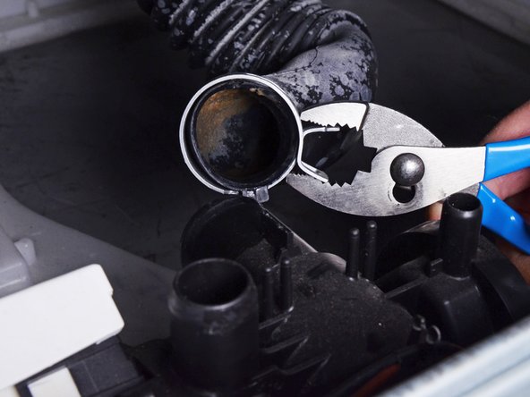

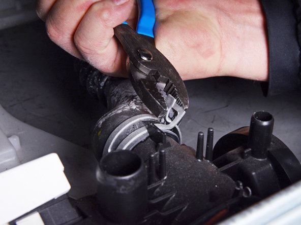

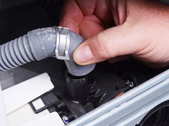

  32. LG Front Load Washing Machine Drain Pump Motor Replacement, Disconnect the drain hose: crwdns2935265:032crwdnd2935265:01crwdnd2935265:03crwdne2935265:0 LG Front Load Washing Machine Drain Pump Motor Replacement, Disconnect the drain hose: crwdns2935265:032crwdnd2935265:02crwdnd2935265:03crwdne2935265:0 LG Front Load Washing Machine Drain Pump Motor Replacement, Disconnect the drain hose: crwdns2935265:032crwdnd2935265:03crwdnd2935265:03crwdne2935265:0
    • Use slip joint pliers to pinch the drain hose clamp and slide it up the hose away from the pump assembly.
  33. LG Front Load Washing Machine Drain Pump Motor Replacement: crwdns2935265:033crwdnd2935265:01crwdnd2935265:03crwdne2935265:0 LG Front Load Washing Machine Drain Pump Motor Replacement: crwdns2935265:033crwdnd2935265:02crwdnd2935265:03crwdne2935265:0 LG Front Load Washing Machine Drain Pump Motor Replacement: crwdns2935265:033crwdnd2935265:03crwdnd2935265:03crwdne2935265:0
    • Use slip joint pliers to rotate the drain hose back and forth around its connection and loosen it.
    • Pull the drain hose straight off its connection on the assembly.

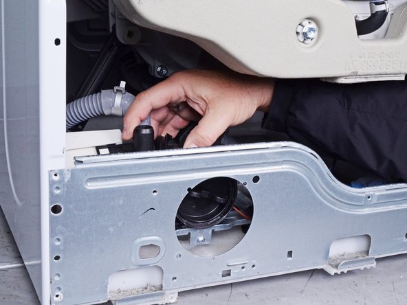

  34. LG Front Load Washing Machine Drain Pump Motor Replacement, Disconnect the pump hose: crwdns2935265:034crwdnd2935265:01crwdnd2935265:03crwdne2935265:0 LG Front Load Washing Machine Drain Pump Motor Replacement, Disconnect the pump hose: crwdns2935265:034crwdnd2935265:02crwdnd2935265:03crwdne2935265:0 LG Front Load Washing Machine Drain Pump Motor Replacement, Disconnect the pump hose: crwdns2935265:034crwdnd2935265:03crwdnd2935265:03crwdne2935265:0
    • Repeat the last two steps for the pump hose.

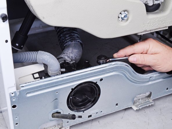

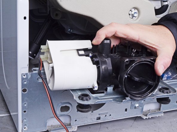

  35. LG Front Load Washing Machine Drain Pump Motor Replacement, Unfasten the pump assembly: crwdns2935265:035crwdnd2935265:01crwdnd2935265:02crwdne2935265:0 LG Front Load Washing Machine Drain Pump Motor Replacement, Unfasten the pump assembly: crwdns2935265:035crwdnd2935265:02crwdnd2935265:02crwdne2935265:0
    • Remove the screw(s) securing the pump assembly to the bottom lip of the washer.
  36. LG Front Load Washing Machine Drain Pump Motor Replacement, Remove the pump assembly: crwdns2935265:036crwdnd2935265:01crwdnd2935265:03crwdne2935265:0 LG Front Load Washing Machine Drain Pump Motor Replacement, Remove the pump assembly: crwdns2935265:036crwdnd2935265:02crwdnd2935265:03crwdne2935265:0 LG Front Load Washing Machine Drain Pump Motor Replacement, Remove the pump assembly: crwdns2935265:036crwdnd2935265:03crwdnd2935265:03crwdne2935265:0
    • Lift the pump assembly out of its location in the frame to remove it.

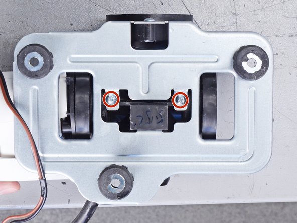

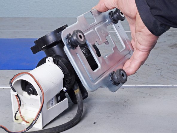

  37. LG Front Load Washing Machine Drain Pump Motor Replacement, Unfasten the pump bracket: crwdns2935265:037crwdnd2935265:01crwdnd2935265:02crwdne2935265:0 LG Front Load Washing Machine Drain Pump Motor Replacement, Unfasten the pump bracket: crwdns2935265:037crwdnd2935265:02crwdnd2935265:02crwdne2935265:0
    • Remove the screw(s) securing the pump bracket.
  38. LG Front Load Washing Machine Drain Pump Motor Replacement, Remove the Pump Bracket: crwdns2935265:038crwdnd2935265:01crwdnd2935265:02crwdne2935265:0 LG Front Load Washing Machine Drain Pump Motor Replacement, Remove the Pump Bracket: crwdns2935265:038crwdnd2935265:02crwdnd2935265:02crwdne2935265:0
    • Pull the pump bracket straight off the pump body to remove it.

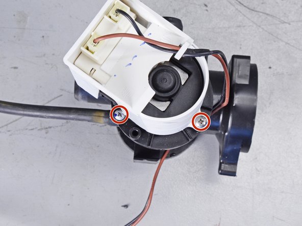

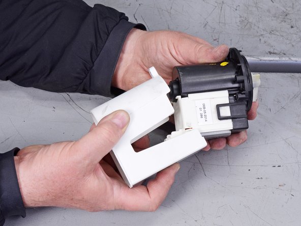

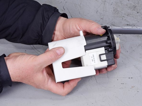

  39. LG Front Load Washing Machine Drain Pump Motor Replacement, Unfasten the pump motor: crwdns2935265:039crwdnd2935265:01crwdnd2935265:02crwdne2935265:0 LG Front Load Washing Machine Drain Pump Motor Replacement, Unfasten the pump motor: crwdns2935265:039crwdnd2935265:02crwdnd2935265:02crwdne2935265:0
    • To avoid confusion, note the locations of the motor screws.
    • Remove the screw(s) securing the pump motor.
  40. LG Front Load Washing Machine Drain Pump Motor Replacement, Remove the pump motor: crwdns2935265:040crwdnd2935265:01crwdnd2935265:02crwdne2935265:0 LG Front Load Washing Machine Drain Pump Motor Replacement, Remove the pump motor: crwdns2935265:040crwdnd2935265:02crwdnd2935265:02crwdne2935265:0
    • Pull the pump motor straight off the pump to remove it.

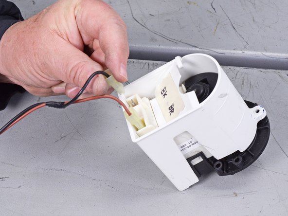

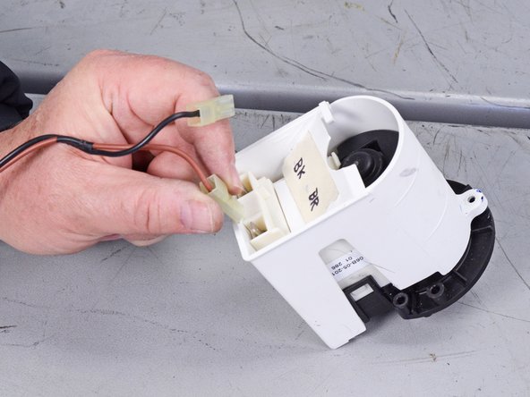

  41. LG Front Load Washing Machine Drain Pump Motor Replacement, Disconnect the pump motor: crwdns2935265:041crwdnd2935265:01crwdnd2935265:03crwdne2935265:0 LG Front Load Washing Machine Drain Pump Motor Replacement, Disconnect the pump motor: crwdns2935265:041crwdnd2935265:02crwdnd2935265:03crwdne2935265:0 LG Front Load Washing Machine Drain Pump Motor Replacement, Disconnect the pump motor: crwdns2935265:041crwdnd2935265:03crwdnd2935265:03crwdne2935265:0
    • To prevent confusion, label each connector with its corresponding cable color.
    • Disconnect the connector(s) attached to the pump motor.
    • The shrouded connectors can fool you into thinking you have properly reconnected them. It should require some force to reassemble; if it slides in easily, you probably missed it. Tug on the connector after reassembling it; it should take a firm pull to disconnect it.

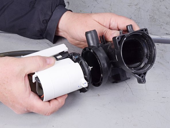

  42. LG Front Load Washing Machine Drain Pump Motor Replacement, Remove the pump housing: crwdns2935265:042crwdnd2935265:01crwdnd2935265:03crwdne2935265:0 LG Front Load Washing Machine Drain Pump Motor Replacement, Remove the pump housing: crwdns2935265:042crwdnd2935265:02crwdnd2935265:03crwdne2935265:0 LG Front Load Washing Machine Drain Pump Motor Replacement, Remove the pump housing: crwdns2935265:042crwdnd2935265:03crwdnd2935265:03crwdne2935265:0
    • Pull the plastic pump housing off of the motor and remove it.
    • Set this housing aside, as you will need to reinstall it on the new pump motor.
