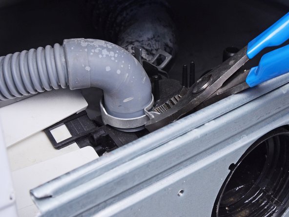

  30. LG Front Load Washing Machine Drain Hose Replacement, Disconnect the drain hose: crwdns2935265:030crwdnd2935265:01crwdnd2935265:03crwdne2935265:0 LG Front Load Washing Machine Drain Hose Replacement, Disconnect the drain hose: crwdns2935265:030crwdnd2935265:02crwdnd2935265:03crwdne2935265:0 LG Front Load Washing Machine Drain Hose Replacement, Disconnect the drain hose: crwdns2935265:030crwdnd2935265:03crwdnd2935265:03crwdne2935265:0
    • Use slip joint pliers to pinch the drain hose clamp and slide it up the hose away from the pump assembly.
  31. LG Front Load Washing Machine Drain Hose Replacement: crwdns2935265:031crwdnd2935265:01crwdnd2935265:03crwdne2935265:0 LG Front Load Washing Machine Drain Hose Replacement: crwdns2935265:031crwdnd2935265:02crwdnd2935265:03crwdne2935265:0 LG Front Load Washing Machine Drain Hose Replacement: crwdns2935265:031crwdnd2935265:03crwdnd2935265:03crwdne2935265:0
    • Use slip joint pliers to rotate the drain hose back and forth around its connection and loosen it.
    • Pull the drain hose straight off its connection on the assembly.

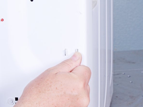

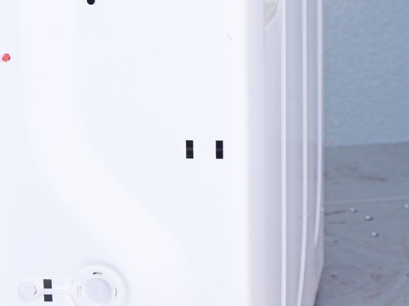

    • Depending on your device, your drain hose could be clipped to different sides of the chassis.
    • While holding the back of clip with one hand, use the other to push the prongs of the clip and release them.
    • Repeat for each prong until the clip slides through the chassis.

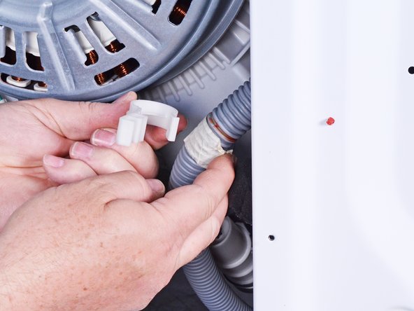

  33. LG Front Load Washing Machine Drain Hose Replacement, Reposition the drain hose: crwdns2935265:033crwdnd2935265:01crwdnd2935265:01crwdne2935265:0
    • Reposition the drain hose so you can access the plastic clip.

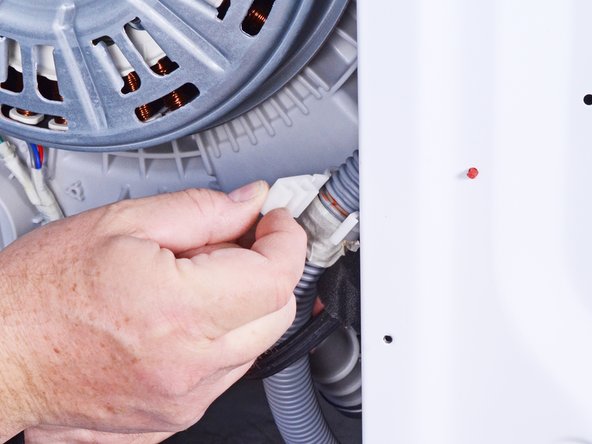

  34. LG Front Load Washing Machine Drain Hose Replacement, Unfasten the drain hose: crwdns2935265:034crwdnd2935265:01crwdnd2935265:01crwdne2935265:0
    • Remove the screw(s) securing the drain hose.
  35. LG Front Load Washing Machine Drain Hose Replacement, Apply the tape: crwdns2935265:035crwdnd2935265:01crwdnd2935265:01crwdne2935265:0
    • To prevent confusion during reassembly, apply some masking tape where the plastic clip is located.
  36. LG Front Load Washing Machine Drain Hose Replacement, Remove the plastic clip: crwdns2935265:036crwdnd2935265:01crwdnd2935265:03crwdne2935265:0 LG Front Load Washing Machine Drain Hose Replacement, Remove the plastic clip: crwdns2935265:036crwdnd2935265:02crwdnd2935265:03crwdne2935265:0 LG Front Load Washing Machine Drain Hose Replacement, Remove the plastic clip: crwdns2935265:036crwdnd2935265:03crwdnd2935265:03crwdne2935265:0
    • Pull the plastic clip off the drain hose.
    • Remove the plastic clip.

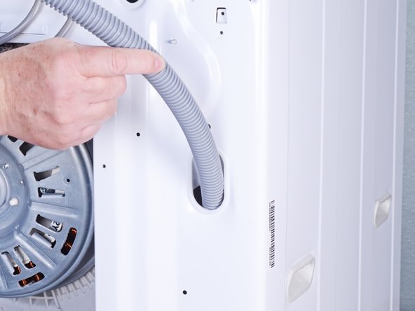

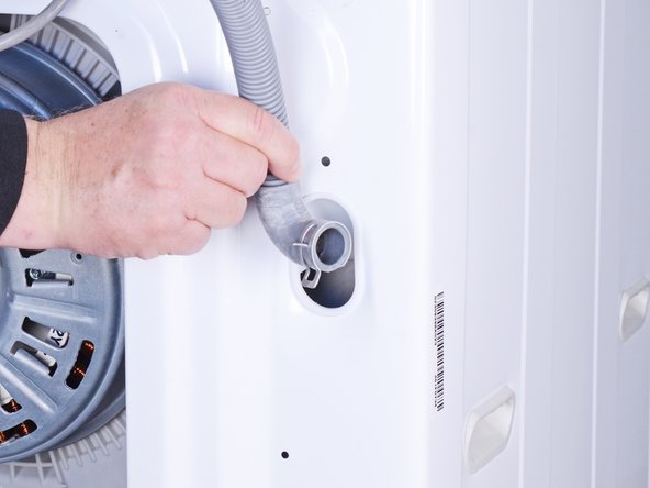

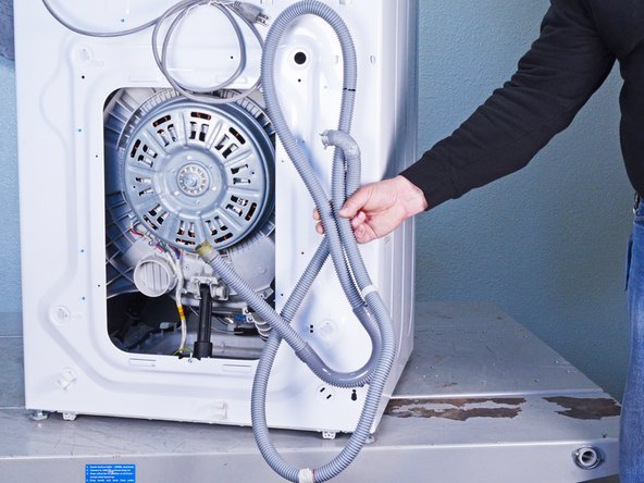

  37. LG Front Load Washing Machine Drain Hose Replacement, Remove the drain hose: crwdns2935265:037crwdnd2935265:01crwdnd2935265:02crwdne2935265:0 LG Front Load Washing Machine Drain Hose Replacement, Remove the drain hose: crwdns2935265:037crwdnd2935265:02crwdnd2935265:02crwdne2935265:0
    • Pull the drain hose through its slot in the chassis.
  38. LG Front Load Washing Machine Drain Hose Replacement: crwdns2935265:038crwdnd2935265:01crwdnd2935265:03crwdne2935265:0 LG Front Load Washing Machine Drain Hose Replacement: crwdns2935265:038crwdnd2935265:02crwdnd2935265:03crwdne2935265:0 LG Front Load Washing Machine Drain Hose Replacement: crwdns2935265:038crwdnd2935265:03crwdnd2935265:03crwdne2935265:0
    • Remove the drain hose.
