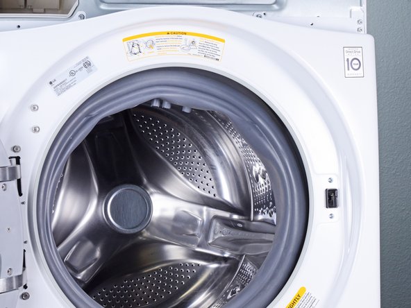

  2. LG Front Load Washing Machine Door Latch Replacement, Open the door: crwdns2935265:02crwdnd2935265:01crwdnd2935265:02crwdne2935265:0 LG Front Load Washing Machine Door Latch Replacement, Open the door: crwdns2935265:02crwdnd2935265:02crwdnd2935265:02crwdne2935265:0
    • Open the front door completely.

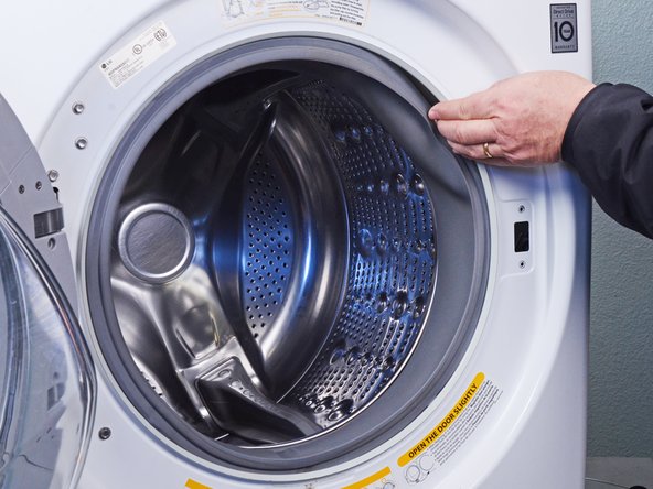

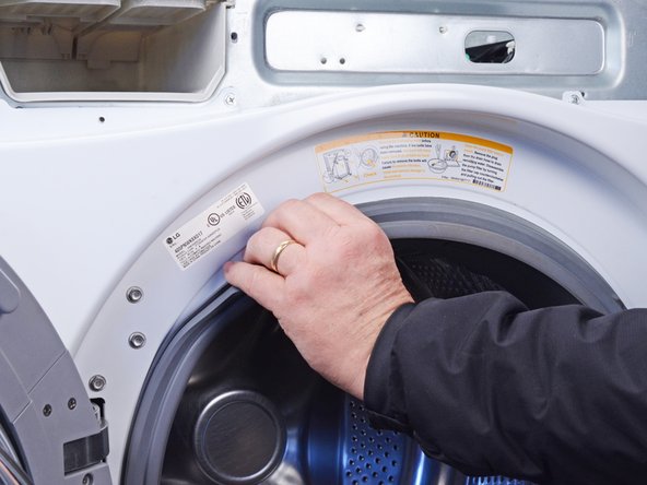

  3. LG Front Load Washing Machine Door Latch Replacement, Remove the boot ring: crwdns2935265:03crwdnd2935265:01crwdnd2935265:03crwdne2935265:0 LG Front Load Washing Machine Door Latch Replacement, Remove the boot ring: crwdns2935265:03crwdnd2935265:02crwdnd2935265:03crwdne2935265:0 LG Front Load Washing Machine Door Latch Replacement, Remove the boot ring: crwdns2935265:03crwdnd2935265:03crwdnd2935265:03crwdne2935265:0
    • Use needle nose pliers to grip the spring end of the metal ring at the bottom of the rubber boot.
    • Pull the ring away from the chassis to separate it from the boot.

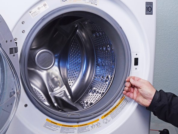

  4. LG Front Load Washing Machine Door Latch Replacement: crwdns2935265:04crwdnd2935265:01crwdnd2935265:03crwdne2935265:0 LG Front Load Washing Machine Door Latch Replacement: crwdns2935265:04crwdnd2935265:02crwdnd2935265:03crwdne2935265:0 LG Front Load Washing Machine Door Latch Replacement: crwdns2935265:04crwdnd2935265:03crwdnd2935265:03crwdne2935265:0
    • Use your hand to completely pull the ring off the boot.
    • During reassembly, perform the following:
    • Insert one end of the ring into its groove along the boot's perimeter.
    • Use pliers to slowly stretch the ring around the boot's perimeter until it's completely nested in its groove.
    • Be sure the spring is centered at the bottom of the boot when you reinstall it.
    • This procedure will take significant force.

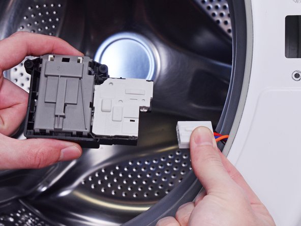

    • Don't try to fully remove the door latch yet. It's still connected to a cable harness.
  10. LG Front Load Washing Machine Door Latch Replacement, Remove the door latch: crwdns2935265:010crwdnd2935265:01crwdnd2935265:02crwdne2935265:0 LG Front Load Washing Machine Door Latch Replacement, Remove the door latch: crwdns2935265:010crwdnd2935265:02crwdnd2935265:02crwdne2935265:0
    • Disconnect the cable harness from the door latch.
    • Always grip cables by their connectors and not the wires themselves.
    • Remove the door latch.
